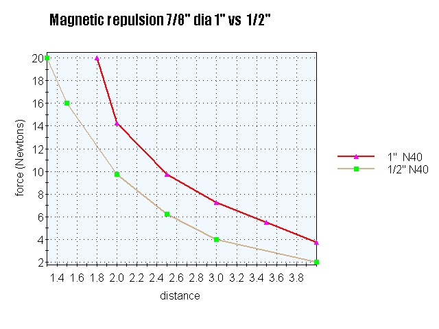

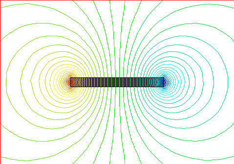

i am going to test (i hope) the effect of magnet thickness on a generator , my present testbed allows me to switch magnets fairly easily.
i have fourty eight - 1/2"  thick x 7/8" dia.,, and fourty eight 1" thick x 7/8" dia. N40 neos.
I have several goals in all this .
 1) to build a better generator
 2) determin the effect of magnet thickness  on a generator.
 2a) determine the change in RPM per volt of the two thicknesses
 3) what effect the two different thicknesses will have on several different coils , all of the same outer dia ,some have slightly different inner diameters, and one is thicker than the others..
stay tuned it should be interesting.
any sugestions will be welcome?
http://www.otherpower.com/images/scimages/2965/mline_B2C5D48.jpeg

forgot to say , the distance in the graph is in cm.

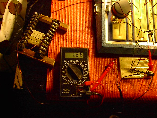

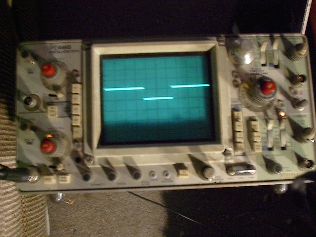

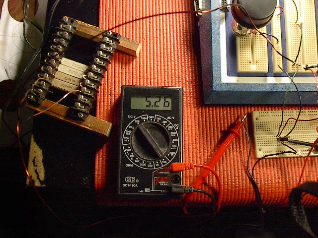

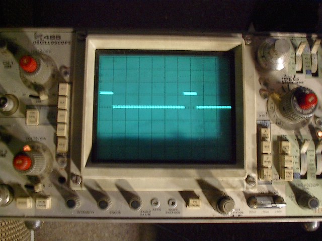

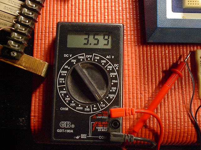

some pwm results

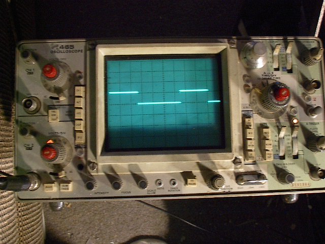

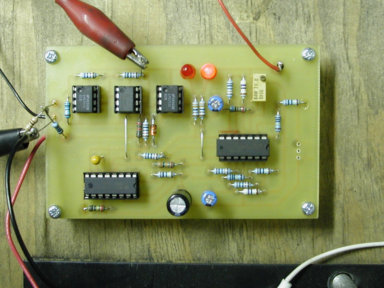

« Reply #5 on: March 12, 2006, 10:23:35 AM »
meter reading 1.26A , so far so good..
http://www.otherpower.com/images/scimages/2965/IM001617.JPG
scope image of the gate input , nice clean waveform , no distorted ends or anything.. one over 6.6 -- the fet is on 15% of the time.
http://www.otherpower.com/images/scimages/2965/IM001618.JPG
Meter reading 3.59A. still good ! load is starting to heat up at this point.
http://www.otherpower.com/images/scimages/2965/IM001619.JPG
2.5 divisions  over 6.6 divisions ..scope is saying the FET is "on" for 38% of the time..
http://www.otherpower.com/images/scimages/2965/IM001620.JPG
meter is 5.26A and the fet is still not hot , just warm , with no heat sink!
http://www.otherpower.com/images/scimages/2965/IM001622.JPG
approx 3.7 div. over 6.6 div. FET is "on" for 56% of the time
scope is on .5 mS per division so the frequency of the pwm is 303 times a second (HZ)..not pictured is the sealed lead acid battery supplying the power to the load through the FET..
i'll try to draw up a schematic of the setup later on..
« Last Edit: March 12, 2006, 10:23:35 AM by willib »

I've played around with different magnet arrangements using FEMM, a finite-element modelling package of software for magnetic fields.  (Free to download if you want to try yourself).  Doubling the thickness of a magnet affects the field by a factor of the square root of the change in thickness,  or 2^(1/2)
For example: 2 x thickness:   sqrt(2) = 1.41 times the original flux
               1/2 x thickness: sqrt(0.5) = 0.71 times the original flux
Your graph agrees with that, to some degree.  There are other factors at play, like flux saturation that I can't quantify for you.  You have to picture that if you keep the space between magnet face and stator the same, the amount of magnet you're adding to the system is getting farther and farther away from the stator.  You simply can't double the flux by doubling the thickness of the magnet.
From your particular starting point, you probably could find a thickness that bosts your voltage per RPM to the amount you desire.  The number you calculate may not agree with you, tho.
« Last Edit: March 13, 2006, 02:42:43 PM by SparWeb »

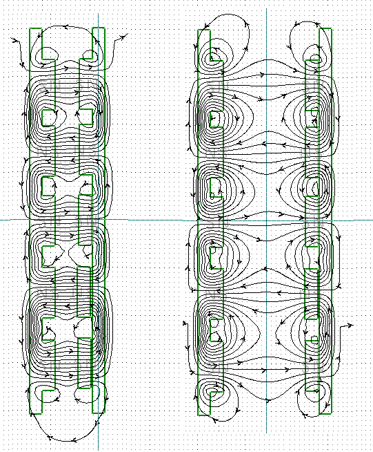

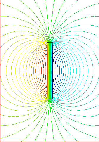

i have two photos you should see , which shows the leakage flux of long , thick magnets vs thin wide ones ..
anyway i hope i havnt conveyed that conclusion about thicker magnets having more leakage flux ,i have not noticed this at all..
in fact the opposite seems to be the case as seen in the pictures below..
« Last Edit: March 13, 2006, 06:52:28 PM by willib »

i think you need to stop looking at flux plots with the mag in free air. it will be on a steel backer, with another mag of equal strength on its own backer just across the way.
you did not label those pics. what am i looking at?
allan

Re: some pwm results
« Reply #21 on: March 14, 2006, 05:51:28 PM »
the first one is a long skinny magnet , and the second one a short wide one.
« Last Edit: March 14, 2006, 05:51:28 PM by willib »
kitno455
  • Posts: 442
« Reply #22 on: March 15, 2006, 07:14:49 PM »
ok- and look at all the leakage flux lines on the first one. no way to get those dark red a blue lines to jump across the gap to another mag.
put those multiple of those mags on a steel plate in your software, and put a like assembly on the other side, and try to compare. then do the same for the other type of mag.

« Reply #23 on: March 15, 2006, 10:31:27 PM »
I'm not sure that you can derrive any information regarding leakage from a flux diagram  of a magnet in free space... You must first define a closed system for there to be any chance that something might leak from it. I believe that the length(thickness) of a magnet has little to do with leakage, but rather the width of the air gap relative to the distance to the adjacent magnet determines the level of leakage. If the adjacent magnet is closer than the opposite one then thats where the flux heads.

you just added another piece to the puzzle..for me anyway..
that is if the air gap is wider than the distance between adjacent magnets , then thats where the flux goes
but does it go straight across to an adjacent magnet , or does it loop up a little, i wonder..
for me the distance between adjacent magnets is .4375" (7/16") therefor my air gap should be .4375 maximum....
i would like to test it out with iron fileings
that kinda stinks because i was wanting to use a larger gap than .625" (5/8 "),
i had my eye on .75".. hmmm

If my visimag simulations are anything to go by (many in my files) then the flux loops over between magnets. The more direct the path, the 'flatter' the loop.
« Last Edit: March 15, 2006, 11:36:30 PM by jimovonz »
jimovonz
  • Posts: 339
« Reply #27 on: March 15, 2006, 11:40:24 PM »
Here is one specifically showing leakage:
http://www.otherpower.com/images/scimages/2210/Leakage.gif
I could have illistrated it better perhaps if I kept the distance between the magnets constant and varied the distance between adjacent ones.
« Last Edit: March 15, 2006, 11:40:24 PM by jimovonz »

"and I bet you're seeing voltages well below the open-circuit voltage"
yes , @ 250 rpm the open circuit voltage is around 1.5 Vpeak =>166 rpm / volt for one coil.
i see in my notes that i got .6 Vpeak at 166RPM loaded with the 0.00583 ohm load resistor. =>  277 rpm / volt peak for one coil.
but i didnt record the exact length of the gap  or either of the above readings
a lot of fun but frustrating sometimes..

That's actually a pretty neat visualization.  Is it drawn from real results, or from a hypothosis?
« Last Edit: March 16, 2006, 11:13:39 AM by Titantornado »

I strongly suggest to go through the FEMM tutorials one step at a time.  Then re-do the steps, but for you own case, draw the cross-section of a flat plate (backing plate) with an array of magnets on it, and then another plate above that.  Vary the distance between the plates, vary the thicknesses of the magnets, try whatever you like, the computer will do the math for you.
All of the questions you are asking will be answered by this process.
