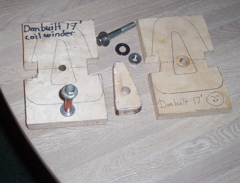

I would suggest that when you make a coil winder that you make the thing so it is universal. Meaning the center bolt hole should always be the same size so you dont have to make a whole new winder assembly each time you want to build a turbine. Make sure to wind all the coils the same way. For example i wound my coils in a clockwise manner. I found there was .8 ohms of resistance in each strand of wire. Too much resistance would rob you of your power.

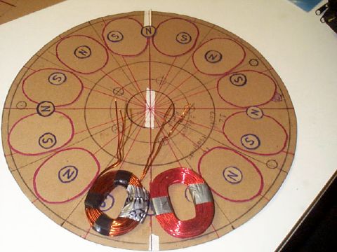

The picture below is a cardboard cutout of what the stator would look like when done, and the proper size coils i would need to fit into the mold i built. These coils weighed about a pound each, maybe more. Something i would like to say here also is that if you plan on building more than one turbine over time, i suggest you use the same spindle for all your projects. I buy my spindles at Princess auto in canada for about 50 bucks. The reason for using the same spindle is you always have the same bolt circle(the studs and holes the fill). This way you dont have to re calculate where the holes go in your steel plates that hold the magnets. Makes everything a little more manageable in my opinion.

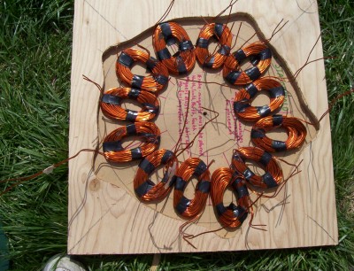

Below is what the coils looked like when they are completed. The hole in the center of the coils should be about the same size as the magnets you are using. I actually put the coils in a vise with some wood on the jaws of the chuck to avoid scratching the coating off the wire, and i squeeze the coils so they fit into the stator mold better. I also use a glue gun while making the coils and put a drop or so on after every 8-10 rounds or so. I find it holds the coils nice and firm. I then put electrical tape on the coils in 4 different spots to make them hold tight.The picture below is taken before they are squeezed and as you can see, the coils would not fit into the stator very well at this point. I will be using magnets with dimensions of 3"x1-1/2"x3/4" thick. The shape of the coils will creat some cancellation at the top, but to make the coils fit, we had to have a trade off, and these magnets are huge, so it doesnt matter to us in this application. We should have power to spare. :)
  As stated above, i used 69 turns of magnet wire, with 2 strands of wire in each of the 12 coils. The length of each wire used is 68' which means about 1' per turn(or round of wire). I used a hot glue gun every once in a while on the coils and i find it hold s the coils together nicer when removing them from the winder.

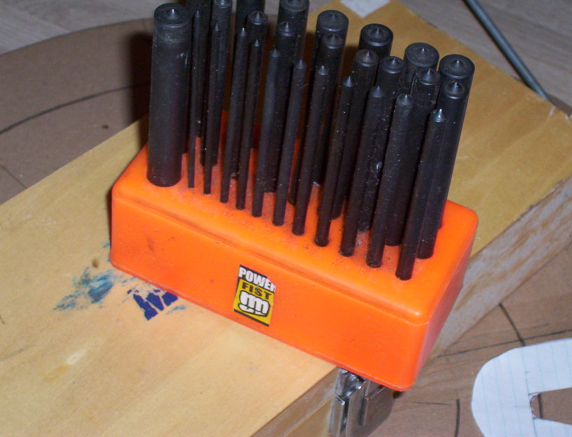

Below is a tool i use to duplicate holes. It is common in the tool and die industry. A set of these is called "transfer punches". And what they do is what the name implies, they transfer one location on an object to another. In this case we transfer holes, or location of holes. This can save you tons of time in locating a certain position to drill a hole, or locate a magnet or whatever. A set of these pucnches is real cheap and i got this set at princess auto in canada, but iam sure they are most anywhere like harbour freight in the states etc. These punches hae a point in the center of them and when you tap the punch with a hammer, it will leave a mark on the object you want to transfer to. It is great for locating holes and these punches come in a set that will fit any, hole size you may have..They are a very neat tool to use to locate clearance holes andin our case, the spindles bolt circle. I also used it to locate the drilled hole on my coil winder. :)

below shows all 12 coils, the next step would be to wire every 4th coil together to make a phase.
picture below shows how i numbered each phase, i wired like i said above 1,2,3,4 on all 3 phases. Whe done it is nice to fiberglass the wires right into the mold so it looks nicer and nothing can harm the wires as they are not exposed
