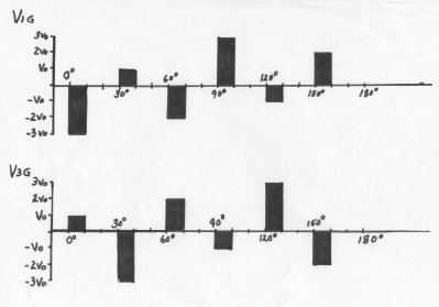

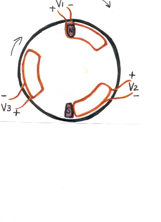

This led to the simple design shown below:
All coils are wound the same way.  The coils move clockwise as shown over the magnets.  Coil one is over a north pole with maximum flux through it.  Coil two is just about to move over a south pole.  Coil three is nowhere near a magnet.  As the coils move the flux through coil one will decrease causing a negative pulse.  Coil two will also experience a negative pulse as it moves over the south pole.  The voltages across the three coils are shown below.  Note that I've ignored the ramp up and ramp down of the voltages.
The fourth curve shows the voltage waveform when the three coils are connected in series.  It is a single phase series of pulses.   The total resistance will be the sum of the resistances of the coils.  This can then be connected to a full wave bridge rectifier.  However, it is not likely anyone would build this alternator except for demonstration purposes.  Let's step it up to the next level.

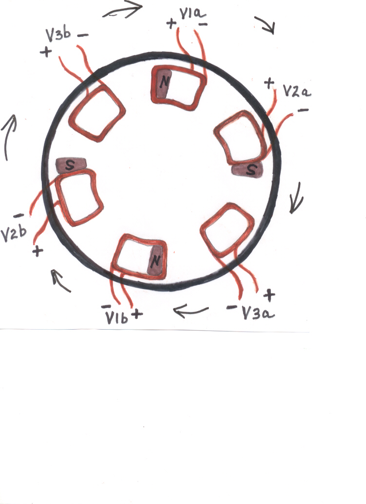

We now have six coils spaced every 60 degrees and four magnets spaced every 90 degrees.  So, the coil to magnet ratio is always going to be 3:2 for this type of alternator.  Note the peculiar geometry.  The magnets are wedge shaped with an angle of MA degrees.  Coil two ends at 90 - MA/2 degrees.  So, coil one ends at 30 - MA/2 degrees, since it's 60 degrees behind coil two.  Coil one starts at a negative angle.  We define an angle WA for the angle subtended by the width of the wire.  Then we can write that coil one begins at  -(WA + MA/2).  So, the total width of coil one is then 30 + WA.  The inside dimension of the coils are then given by 30 - WA.  This is the maximum size magnet that can be used given WA.  In reality you would pick the size of the magnet, the width of the wire or number of turns and then size the rotor to fit the angular requirement.
As mentioned, the three phases would be connected in series to get the output.  If we connect the a and b windings of each phase together first we can do some electronic alchemy.  Say phase two is in the middle.  We can bring out a wire from between a and b of phase two and make it common (ground or G).  This is similar to a center tapped transformer winding.  What does this get us?  We now need only two diodes and we cut the resistance in half.  We do not cut the voltage in half.  The waveforms are shown below.
The peak voltage is now three quarters of what it was before.  It occurs for only one third the time, however.  Still this would probably not a problem, since at cut-in the power in the wind is low anyway.  In fact, as the wind speed increases the peak value of the wavform will increase untill the lower pulses cause conduction.  If we assume we are charging a battery with no change in voltage, the current and hence power into the battery will be limited by the alternator resistance.  The plot below shows a general power curve.  A hypothetical wind power curve is also shown.
Breaks in the power curve always occur near 1.5 and 3 times the battery voltage.  This means that the alternator can follow the wind's power curve somewhat better than a normal alternator design.  Of course, the whole thing is also dependent on the blade assembly's ability to track the wind.
One final thing.  Just as you can rectify to a positive voltage, you can also rectify to a negative voltage.  This means you can also connect a battery to G in a negative fashion.  This allows you to get 12 volts out by using two six volt batteries or 24 volts by using two 12 volt batteries.  The alternator ground floats  on a battery voltage relative to system ground.

First off, every coil goes from a state of no flux through it to a maximum flux less leakage just like in any design.  If you scale a particular version up by a factor of two by keeping the same number of windings, you get four times the flux with twice the speed for eight times the voltage.  You also have increased the coil volume by eight for the same number of turns or four if you keep the same length for the coils.  Since you probably do not need an eight times factor increase in voltage you have the option of decreasing the number of turns by using heavier wire (the coil size must still be doubled for this example).  So, you can lower the resistance.  This is much like any design.  Resistance does matter and is part of the design.  It should be obvious that a larger machine can provide more power, which means lower resistance.  It does help that by going to the center tap the effective resistance is cut in half.
What you see here is the first step in an engineering design, a concept.  The next step is to prove it.  It is possible that vibration issues may arise.  But they are mechanical not electrical.  Or actually electromechanical as they involve interactions between the electromagnetic forces and the  mechanical vibrational states of the physical structure.  If you go back and look at the first set of voltage curves, you will notice that the positive voltage spikes, formed from the addition of pairs of coil outputs are 120 degrees apart in time as are the negative spikes.  In other words three phase behavior is embedded in the design.  This is a hybrid between single phase and three phase and it will have its own characteristics.

SmoggyTurnip
  • Posts: 294
Re: An Alternate PM Alternator Design
« Reply #13 on: April 25, 2006, 07:24:23 AM »
Finsayer,
I can't seem to figure out
how the coils are connected
together from your explaination
(for the second diagram).
Maybe you could do a drawing
showing how the coils are
connected? I would like to
do some calculations.
« Last Edit: April 25, 2006, 07:24:23 AM by SmoggyTurnip »

« Reply #15 on: April 25, 2006, 08:35:12 AM »
The coils are assumed all wound the same way with the voltages as shown.  Simply connect the negative side of V1a to the positive side of V1b to form V1.  Do the same for the other two phases.  Then connect the negative side of phase one to the positive side of phase two and the negative side of phase two to the positive side of phase three.  If you wish to bring out the 'center tap' that is taken off from the connection on phase two between V2a and V2b.  The important thing is that when V1a is going negative (as shown) then so is V1b.  Similarly, when V2a is going negative then so is V2b.  When phase three encounters the north pole, as it will do, then both V3a and V3b must both create a positive pulse.  At this point it's basically defining the winding of the coils such that these relationships hold.  In building this it requires checking the voltages when turning the rotor to make sure the relationships hold.  In that sense a diagram would be of no real help since I can not predict how someone will set up his coils.  Note that if it happens that V1a actually goes positive while V2b goes negative then you just exchange the plus and minus signs on V1a.  That is, you redefine the voltage V1a.  These kind of ambiguities are quite common in electronic circuits, but are really of no consequence as long as we are consistent in our definitions.  I hope this helps.
« Last Edit: April 25, 2006, 08:35:12 AM by finnsawyer »

Your curve is showing peak voltage with respect to rpm.
Since the wave form is is pulses the actual rms voltage
is less than the rms value of a sin wave with the
same peak voltage.  The output power for this design
will still go with the square of the RPM so it will
not match the wind power curve any better than the
standard design.
Any magnet passing over any air filled coil at a fixed velocity will produce an RMS voltage in that coil that is directly proportional to the velocity of the magnet,  this does not depend on the shape of the magnet or the shape of the coil or the strength of the magnet field, or resistance of the wire.  That is to say for a given magnet and coil moving the magnet twice as fast will produce an RMS voltage twice the magnitude.
The maximum power that can be derived from that coil is V^2/(2*R).
These 2 facts taken together imply that any alternator that moves a constant
magnetic field over fixed air filled coils will  have a power curve that is proportional
to the square of RMP, regardless of the arrangement of the coils and magnets.
« Last Edit: April 25, 2006, 11:33:22 AM by SmoggyTurnip »

Sometimes it's hard to tell where people are having problems.  Let's try it this way.  When the alternator hits cut-in at let's say 100 rpm, the highest voltage pulse will cause conduction.  I've called this voltage Vp, which varies linearly with rpm.  I'm going to ignore the diode voltage.  So the current that flows from the alternator for the duration of that pulse is:  Ib = (Vp - Vb)/Ra, where Vb is the battery voltage and Ra is the alternator resistance.  I'm also ignoring the battery resistance to keep this simple.  So, the power into the battery is given by VbxIb during the duration of the pulse.  The energy into the battery is given by
Eb = PtxVbxIb = PtxVbx(Vp - Vb)/Ra, where Pt is time duration in seconds of the pulse.  The energy out of the alternator then becomes Ea = PtxVpxIb = PtxVpx(Vp - Vb)/Ra during the pulse.  The percent of energy (or power) going into the battery is given by Eb/Ea = Vb/Vp.  This is the type of behavior you would expect from a regular alternator.
When the alternator hits 150 rpm the second highest pulse becomes large enough to cause the diodes to conduct.  That speed is the first break point.  So now we have a second pulse causing conduction.  Its value is 2/3 that of Vp.  So, for that pulse we may write Ib2 = (2/3xVp - vb)/Ra.  The energy delivered by that pulse is given by Eb2 = PtxVbx(2/3xVp - Vb)/Ra.  The energy from the alternator during that pulse is Ea2 = PtxVpx(2/3xVp - Vb)Ra.  Since both pulses now contribute, we must add their contributions to get the total energy into the battery, which gives:
   Eb = PtxVbx(5/3xVp - 2Vb)/Ra.  Ea = PtxVpx(5/3 - 2Vb)/Ra.
This applies from 150 rpm to 300 rpm.

now that I have digested most of this:
I am not sure what you really meant to say here. Perhaps you could clarify this for us?
If I understand you correctly you want the coils wired like this:
- D -1a-1b-2a - G -2b-3a-3b- D -
D= diode , G = ground
Problem, a single normal diode only conducts in one direction so you will only get positive or negative voltage out, the reverse voltage is blocked and the output is zero.
Ignoring the diode problem, this is just a normal multi-coil single phase generator with an odd center tap. The normal output with a full wave bridge would be 6 (4x) pulses. If the system voltage is (1x) then 4 of the pulses are wasted because they would be under system voltage. As an average, only (2x) of usable voltage is generated per pulse. In the normal non tapped the average value would be (3x) per pulse. As your system voltage rises the situation worsens. At (2x) you would only get 2 usable pulses of (1x). There has to be a clearer way to say this but I have had to much coffee.....
You stated elsewhere that you wanted a winding that could be used for 6 or 12 volts. The simple solution is to wind each coil 2 in hand. For 6 volts run them in parallel and for a 12 volt application wire them in series. If you wound 4 in hand the stator could be wired for 6,12 or 48 volts.
I have noticed you tend to use peak voltage when you really mean RMS voltage. Peak voltage is semi-constant whenever the coil reaches saturation while RMS voltage varies with the speed due to frequency and pulse width changes.

You need not shout. "" will do.  I've probably discussed all of this here or there.  What I usually do in comparing this with the standard three phase arrangement is to assume one inch diameter magnets and two inch diameter coils with twelve magnets (the three phase is restricted to numbers of magnets divisible by four, this design can use any even number of magnets).  The magnets alternate poles and are spaced every 30 degrees.  The 18 coils are spaced every 20 degrees.  The coils are arranged in three groups of six.  When the coils of group one are centered exactly over the magnets having north poles, the coils of group two (and three also) will just be touching magnets having south poles.  This determines the geometry as well as the size of the rotor and the stator.  I'm going to rotate the coils here instead of the magnets, as I think it's easier to see the action, although the result would be the same.  As the coils rotate (in either direction), the coils of group one are moving off of a north pole creating a negative pulse (arbitrary choice).  At the same time the next group of coils advancing in the direction of rotation (call it group B) is moving unto a negative pole, also producing a negative pulse.  The last group (C) is moving between magnets producing no voltage.  Carrying on, group B now moves off of a south pole producing a positive pulse, while group C is moving on to a north pole producing a positive pulse.  Group one, (or A if you wish) is now between magnets producing no voltage.  At this point we have produced one complete cycle of the output waveform in moving one eighteen of a revolution.  So, we get eighteen cycles per revolution.
I'm not going to discuss the center tapped version at this time.  It has different characteristics, which may be useful, but I think you should completely understand the basic design first.
The output of this alternator will be single phase, as all the coils are connected in series.  As far as winding the coils is concerned, for this exercise the total amount of copper per coil remains constant.  If you wind the coils with the same wire as used in the three phase but two in hand, you will end up with the voltage (of my design) cut in half and the resistance reduced by a factor of four (which results in 3/4 of the resistance of the three phase, for instance).  Both voltage and resistance are important.
"I have noticed you tend to use peak voltage when you really mean RMS voltage. Peak voltage is semi-constant whenever the coil reaches saturation while RMS voltage varies with the speed due to frequency and pulse width changes."
I don't mean RMS or Root Mean Square voltage.  It is not a very good measure for an alternator who's output is not a pure sine wave.  Your RMS meters will give an erroneous reading.  What you are missing is that for a given alternator the ratio of the peak voltage to the "average voltage" stays constant with RPM.  When charging a battery peak voltage not average voltage gets you there first.  I explained that in the other thread.  Coils never reach "saturation".  They can't.  They do not contain any iron.  Nor are the speeds reached by these alternators high enough for hysteresis or inductive effects to become important.  Keep in mind that the iron parts are not in saturation to begin with.
"The term ground tends to imply a connection to earth or chassis and 0 volts. Neutral implies no connection to a chassis or earth and the voltage is not always zero."
Ah, semantics, semantics.  The neutral of the 220 volt supply to my house is definitely connected to ground (Earth).  On the other hand the center tap of a transformer could be connected to the Datum Node (ever hear of that) or ground of a particular circuit, which you could connect any way you see fit.  Many tools today are not grounded.  The alternators we are discussing here are by their nature floating and can be "grounded" in any way you see fit.  Many circuits will show a circuit ground, the connection of which is optional or up to the user.  So, take the "ground" that I mention and connect it to your chassis, or the neutral of your house or the Earth, or leave it floating.  I don't care.  The sense that I was using "ground" was a common point about which the output voltage is defined.  That is, the circuit ground or datum node.
