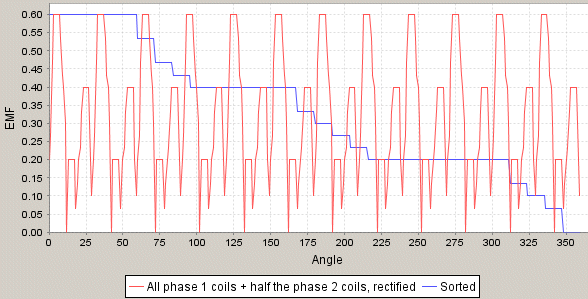

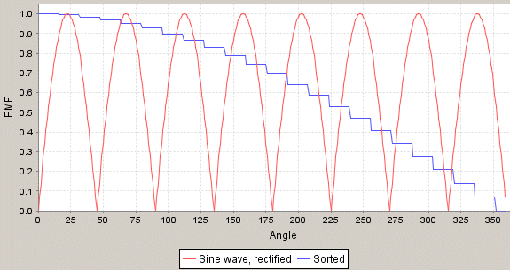

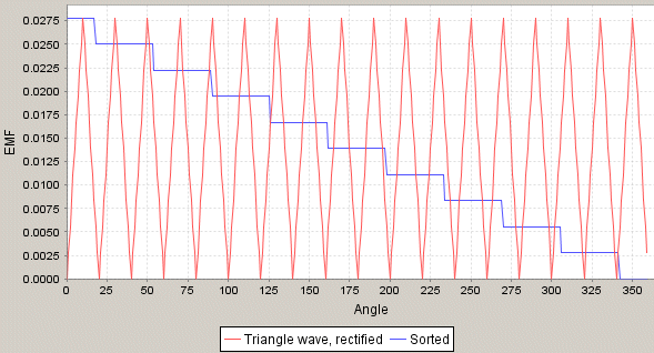

GeoM, you have mentioned a few times recently about RMS voltage measurements and how they relate only to sine waves and not to our typical alternators. This is not my understanding. I believe RMS measurements can apply (and have meaning) to any wave form. Cheaper multimeters expect to see a sine wave and approximate an RMS measurement based on this assumption (0.707 x Vpeak for instance). Meters that are 'True RMS' calculate the RMS value based on the actual waveform measured. I believe that the RMS value gives the 'equivalent DC heating power' i.e. a 10Vrms waveform will dissipate the same heat across a given resistor as 10Vdc. I often see large variations in reading between my cheap meters and those that are 'True RMS' I only ever give any credit to the 'True RMS' meters when such discrepancies arise.

On RMS:
As you said RMS really only occurs in true sine waves but since most meters are built to read RMS and most here only have this type of meter it becomes an issue for most of us. This is a differance between theory and the real world. Yes the reading we get is incorrect but it is still refered to as RMS and not peak.

A couple of points about harmonics:  Even for a square wave the energy in the harmonics dies out fairly rapidly.  The coils do have some inductance, so the harmonics are suppressed fairly quickly with frequency.  That is, the waveform will not deviate too much from a sine wave.

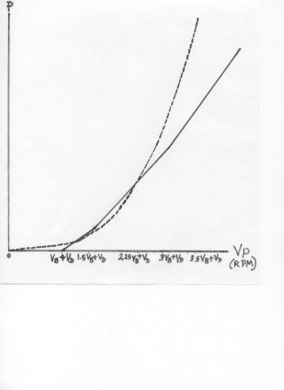

There are different ways to look at a situation.  Lately, I've seen a different way of analyzing this alternator design that might help people understand better how Faraday's Law fits it.  As usual, I assume 12 magnets 9 coils for the three phase standard, and identical 12 magnets with identical 18 coils for the design presented here.  When a magnet, say a north pole is directly centered over a coil the flux through the coil is assumed the same for both cases and given the value of F.  In the three phase case as the north pole moves off of the coil and a south pole replaces it the change in flux has a magnitude of 2xF.  This occurs in the time it takes the rotor to move 30 degrees, which I will call t.  So, from Faraday's Law we can write the average voltage V3 induced in the coil as V3 = 2xF/t.
For the design presented here a magnet moves off of or onto a coil resulting in a flux change of magnitude F.  The magnets are spaced every 30 degrees, as before, but the coils are now spaced every 20 degrees.  Furthermore, the geometry is specified to be such that a magnet will move off a coil or onto a coil in a rotation of the rotor of 10 degrees.  So, it takes one third the time for the flux to change by F.  We may then write the average voltage Vm induced in the coil as Vm = F/(t/3) = 3xF/t.  Doing a little trivial manipulation we find that Vm/V3 = 3/2 = 1.5.  That is, Vm = 1.5xV3.
We also recognize that there is essentially no difference in the shape of the pulse of voltage generated when a magnet moves off of a coils as when it moves onto a coil, although the signs differ.  A north pole moving off of a coil will generate a negative pulse, but so will a south moving onto a coil.  Consequently, we can write the total average voltage generated per pulse as 12xVm = 18xV3.
In the case of the three phase alternator we have 3 coils per phase, so the voltage per phase will be 3xV3.  Since two phases almost add in the star configuration, we can write the voltage out from the three phase alternator as 1.73x3xV3 = 5.19xV3.
So, we find that the average voltage out from this proposed design will be 3.47 times as great as from the standard three phase.  What would this mean in practice?  Well, let's assume that cut-in for the three phase occurs at exactly 12 volts due to the battery being low.  That is, the battery voltage plus the diode forward voltage drops equals 12 volts.  Furthermore, the three phase alternator is putting out 18 volts.  Finally, for simplicity the individual coil resistances are 1 ohm.  So, from the three phase we have I3 = (18-12)/6 = 1 amp.  In the case of this design we would have Im = (62.4 - 12)/18 = 2.8 amp, which translates into 2.8 times as much power into the battery.  I've been criticized because of the amount of copper needed, but you see that copper or resistance doesn't tell the whole story.
We have other options.  We could wind the coils two in hand instead of with a single wire.  Doing so cuts the voltage in half, but it also cuts the resistance by a factor of four, with two half as long strands in parallel.  We then would find that we get the following current: Im = (31.2-12)/4.5 = 4.3 amp, even more power into the battery!  Or we could do three in hand for one third the voltage and one ninth the resistance to get: Im = (20.8-12)/2 = 4.4 amp.  Well, there is obviously a limit to this.  Be aware also that you are also affecting cut-in for the alternator by making these changes.

If I understand it correctly, your alt essentially has 3 different cutin points.
Below the first cutin, obviously nothing happens.
Between the first and second cutins, the EMF is higher than 12V for 1/3rd of the time.
Between the second and third cutins, the EMF is higher than 12V for 2/3rd of the time.
After the third cutin, the EMF is higher than 12V all the time.
This leads to a non-linear increase in the current flow, as you showed in:
http://www.otherpower.com/images/scimages/918/POW1.jpg
Very clever! The alt gradually steps up its duty cycle (0% -> 33% -> 66% -> 100%) as the RPM increases!

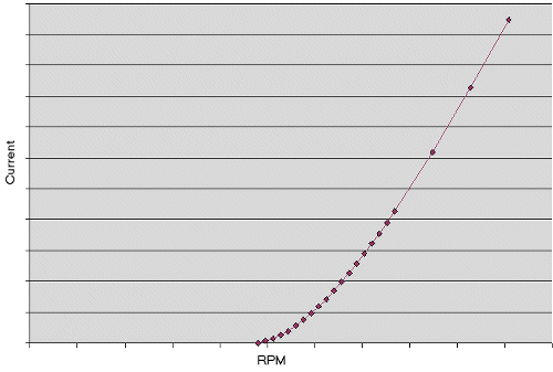

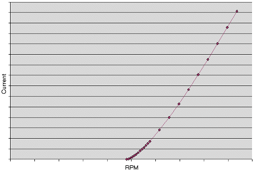

Actually, this happens to some extent in a standard alt, too. Because the waveform generated by the coils is sinusoidal (or triangular, but certainly not square), when the peak EMF first passes 12V, only the very peak of the waveform is above 12V. Current only flows during that time, so the duty cycle is low. As the peak EMF increases, the width of the section of waveform above 12V rapidly increases, and the duty cycle approaches 100%.
If the waveform is a sine wave:
It's a bit better if the waveform is a triangle wave, because the tip is pointier, so the cutin is more gradual:
Your alt's waveform is a 3-step approximation of a triangle wave (if you move the sections about a bit - their order makes no difference).

If the waveform going to a rectifier is a sine wave, the cutin will be fairly abrupt, because the waveform has a fairly flat top to it. We can see this more clearly if we "sort" the waveform, bring this portions with similar values together. This is physically unrealistic, but would actually make very little difference to the output of the rectifier if we did it in real life (ideally, no difference).
If the waveform going to a rectifier is a triangle wave, the cutin will be more gradual, because the waveform has no flat top to it. It gradually eases above the battery voltage, as the coil EMF rises.
(The steps are an artifact of my program only analysing 360 discrete steps. IRL it would be a smoother, nearly straight line)
The waveform from one-and-a-half phases of your design, (which is what has the interesting waveform and the breakpoints in it) approximates the results from a triangle wave:
The three plateaus which cause the three distinct breakpoints can be clearly seen when it's sorted like that.
