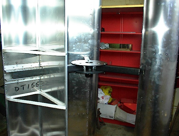

  This is the next generation of the Lenz 2 Turbine nearing completion... a little bit bigger.   It's 4.5ft in diameter and 8ft tall.  The picture below shows the wing completed...

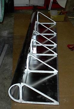

Next is the wings standing in their positions...

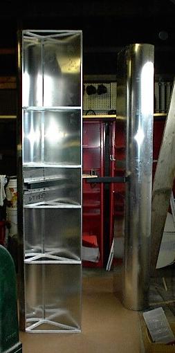

Lastly the center structure...
The ribs are fiberglass reinforced plastic, the stringers are aluminum and the skin is .020 aluminum.
Its getting close for some testing...

hmmm someone's been busy..
ed somebody installed a  red cabinet inside your turbine :)

Nice looking wings, looks to be very light weight.
Hmm, looks like maybe a design change to the nose ?
What no end caps ?
Be interesting to see what the design of the Alt. these puppy's are going
to drive.
Keep the post coming, You have me seating on the edge of my seat.

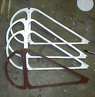

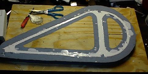

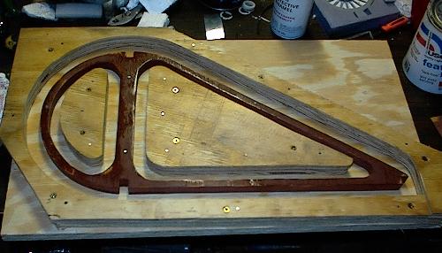

  I started making them out of aluminum sheet similar to Tom in NH built his.  After making a couple of them they seemed a bit flimbsy for what I needed for strength, although extreemly light weight.  I decided to make one from wood and cast it and test the strength.   Below shows the wood rib laid in a mold...
Fill it with liquid rubber...
Take the mold apart, pull the wood rib out, fill it with fiberglass and pour the plastic...
Takes 15-20 minutes for the plastic to harden then pull them from the mold and start over...
I like working with the liquid plastics, I've found tons of uses for it from making replacement parts for things that break and even making up set of gears....

great looking. i remember you saying the smaller ones were 'touchy' about angles. do you feel you have that squared away enough to build such a big one?
also- i am surprised you went with only the single center support. i would have suggested two, at ~ 30 and 70 % of height...

  I put a considerable amount of thought into it as well as calculating the loads leaving 4ft on each end of the arm.   The half tube structure is quite strong, similar to an I beam.   It basically can't move forward or back ( bending ) because of the large area of sheet tied into the trailing edge structure.   The in and out bending forces are controlled by the I beam structure.  Also, what you see in the picture isn't the completed wing structure.   The top and bottom will have struts going from wing to wing.   This way any bending force on one wing will be transfered to the 2 others.   This does allow a considerable amount of force the central pivot point has to endure but mostly in turbulant winds where it may load the turbine above or below the pivot.   I highly doubt it will ever reach its 2000 lb rating.  If we get a storm that will exceed that rating, the turbine will be the last thing I'll be worried about.

the top and bottom triangle struts will help considerably with the rigidity of the prop itself, but i would still be worried about how close your upper and lower bearings will be to one another, on either side of that center plate. but, i as a rule, like widely spaced bearings.

Nice job as always Ed.I think youll get 4 times the power.What about adding supports to the blade ends if possible?Things can get nasty when the blades are increased.The difference between the smaller Lenz and this one should surprise you.Good luck and have more fun.

thats a very nice casting technique on the ribs ed, thanks. and of course, if you stick with this size of vane on future mills it will be all ready to use again. did you cut the glass cloth into strips ? and then fill the cavity?. what sort of resin?
 thanks for clearing up the mystery of winglets on the other post.  for some reason i thought they were some kind of exotic formula 1 type thingie that ran verticaly on the vane edges . doh!

  The cavity of the mold had strips laid in so it formed a C then the plastic was poured.   The plastic is the fast setting 300 series at http://www.smoothon.com .   You basically have 3 minutes from mix to completed pour otherwise you have a cup of hard plastic.   They have slower acting but the de-mold time is also much higher.

 ed i've never used the liquid rubber material before what do you recomend as a parting agent? do you need to put a parting angle on the original ?
« Last Edit: April 28, 2006, 09:18:48 PM by electrondady1 »
Re: Lenz 2.4
« Reply #17 on: April 28, 2006, 10:29:58 PM »
  I use a spray on for molds I plan to make lots of parts with but I didn't use any for the ribs.  I use the stuff called "OOmoo25 or 30" its a 1 to 1 mix by volumn.   Don't get the other stuff that is measured by weight, It takes to long to set and I've wasted alot of the stuff because I didn't get it mixed right.  I think the 25 is fast setting, hour? and the 30 is a 4 hour cure.   I like the fast stuff, when I get an idea I want to see it finished asap!  The rubber is kind of expensive but it makes a considerable amount of molds depending on the size of course.  I mostly make small parts so it lasts a good long time.   I get about 75 to 100 parts from each mold as long as you use a release agent every 10 parts or so it does quite nicely.   Toward the end the rubber dries out from the heat of the plastic curing and you'll see some breaks or deformations in the mold.   I really like the stuff, it's quit fun to work with.
