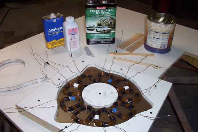

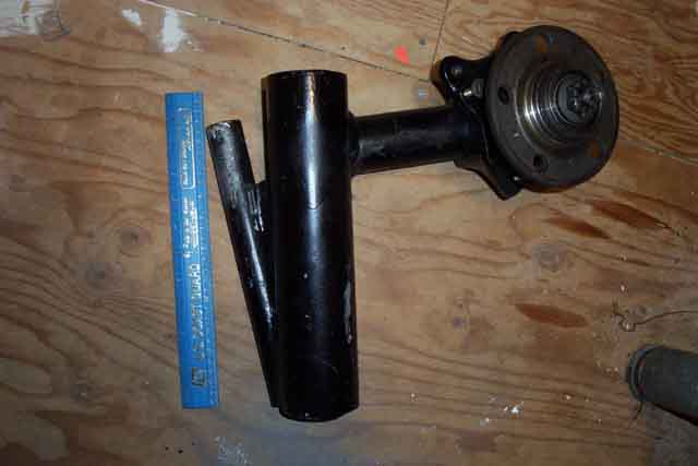

Story of my 9ft, 4 bladed, dual rotor, 12volt, wind genny for low winds.
Summer winds average  8-12 mph during the day.  Winter wind averages 6 mph with occasional gusts to 30.  I figure with a 4 bladed prop I can get lower start up and maybe get my cutin around 120-130rpm.

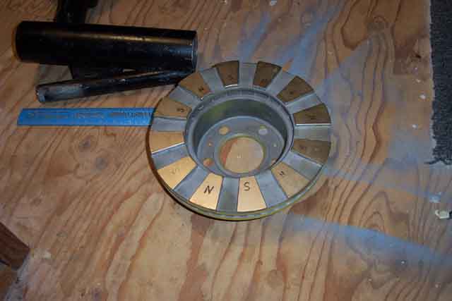

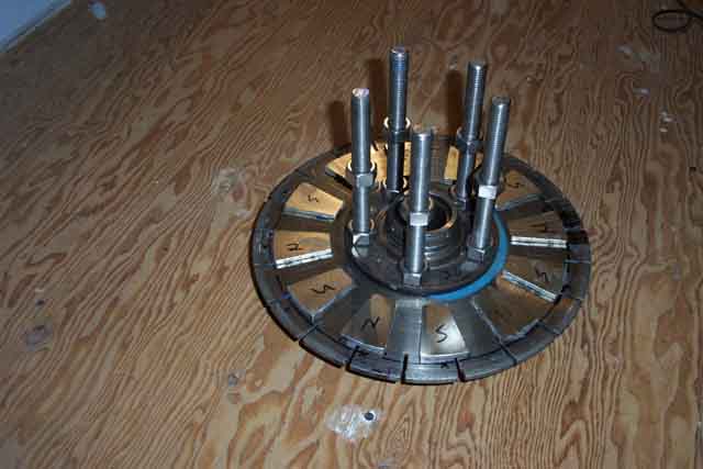

My magnets are wedges 1.57" x .78" x 2" and are only 3/16 thick in a 12-9 configuration.  JB welded to the 10" Volvo rotor and a 12" cement cutting blade.  I plan no casting on the rotors.
Coils are 100 turns of 18awg mag wire and I am bringing all 6 ends down the tower .
The stator is cast in Bondo fiberglass resin in a fiberglass sandwich.
This shows it only 1/2 full.

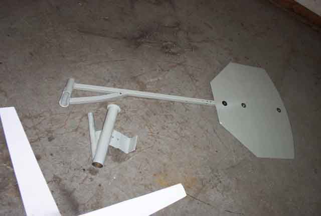

7 inch offset for furling and tail mount is 45 degrees over and 20 degrees back.
Tail shaft is steel square tubing 5 ft long with a 5 sq ft aluminum "feather" bolted on.
I hope to set it to start to furl about 20-25 mph.

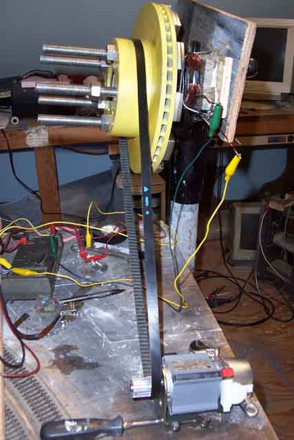

All bolts are stainless steel on the spindle and I can detect no cogging at all.
At 120 rpm during testing I measured about 13 vdc using Jerry rigged 3 phase wiring open circuit. (3/16 spacing )
I'll have all 6 leads to test with once it's flying so I can determine the best configuration for my conditions.
I got a bunch of 6amp diode bridges cheap so I am leaning toward the Jerry rigged because I will see less current through each bridge.  I can parallel up a bunch and keep it in the safe range I hope.
Here is how I drove it at 120 rpm for testing.

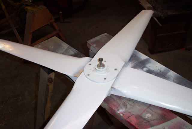

This is a previous 4 bladed (3 ft) prop and I plan to copy it for the 9 ft one.  This went together easy and was a snap to balance.   9ft one will probably be made of laminated cedar.

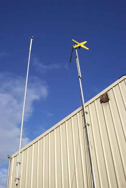

 It now flies (with a 7 watt  stepper generator) where the 9 ft genny will go.
On a 20 ft aluminum antenna mast mounted 16 ft up on my shop.
(Anemometer is a bike computer, works great)
Of course the big one will have guys on it.

A 4 blade is harder to get balanced than a 3 or 5 blade, at least for me.
« Last Edit: May 02, 2006, 06:06:02 AM by ghurd »
Re: 9ft low wind machine
« Reply #5 on: May 02, 2006, 06:45:58 AM »
snuffy;
 No one seems to use 4 bladed very much.  Wonder why?
You might google search the board for "yaw shudder". Any time you have an even # of blades this can be a problem.
« Last Edit: May 02, 2006, 06:45:58 AM by TomW »
snuffy
  • Posts: 58
« Reply #6 on: May 02, 2006, 09:56:05 AM »
I searched for "yaw shudder" and see a lot of reference to 2 bladed but none for 4 bladed.  I understand the problem with 2 bladed but I am less convinced on 4 bladed.  My little 3 ft one in the pics runs smooth as pudding.  I don't have a lot of turbulence so maybe I'm just lucky.  I also had no trouble at all balancing it as long as the blades are made from one long piece with the axle in the center. I think I will continue and if it fails it can be a topic for discussion.
