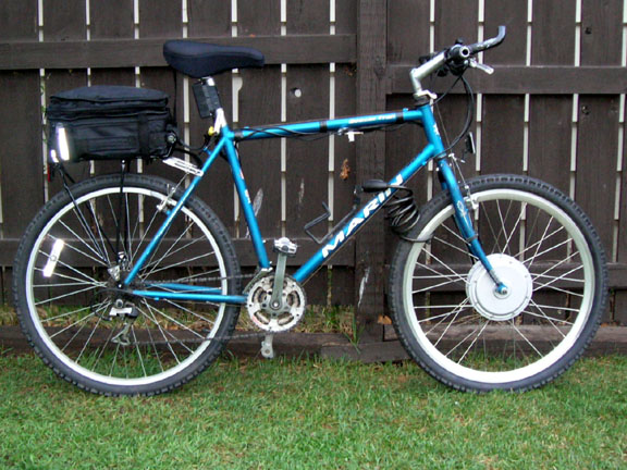

Below is an image of my commuter vehicle. It's a regular mountain bike with a 400 watt Crystalyte bike conversion. 36 Volt controller and battery pack(3-12 ah 12V SLA's). This motor will take up to 72 volts with the 36-72 V controller.
I ride 25km round trip charging at each end but the bike has a range of 30-35km at 30km/h. Works far better than I expected.
I'm getting closer to my original objective of having something to charge with a small wind system but neccesity has finnally led me to the load before the charging system.
These motors are radial flux, neo's on the hub, stator mounted to the axle wound on laminates. Will work as a generator as they are designed for low rpms. Unloaded my version will run at a max 472 rpm at 48 volts.

The bike will cruise under it's own power at 31 km/h. You can start from a dead stand still with no pedal assist but I usually pedal with it anyway.
I can cruise on level ground at around 36 km/h if I pedal with it at a sustainable pace but that's about the rpm limit of the motor to provide any assistance, any faster than that is on my own steam. It needs assistance up hills but it seriously relieves the burden of long hill climbs.

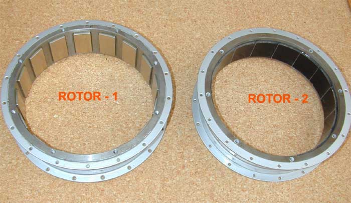

I think the hub motor can work as an alternator. You would have to remove the control circuit and connect the phases to rectifiers.
The following picture is an alt used by Futurenery to build windturbine. I find it extremly similar to the bike motor:
I found this picture on e-bay
Warrior

I'd say that is a hub motor. I though it should work but I'm curious how well.
If I had a rear hub motor I'd spin it up and see.

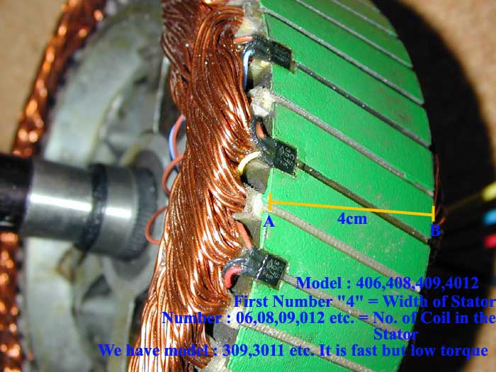

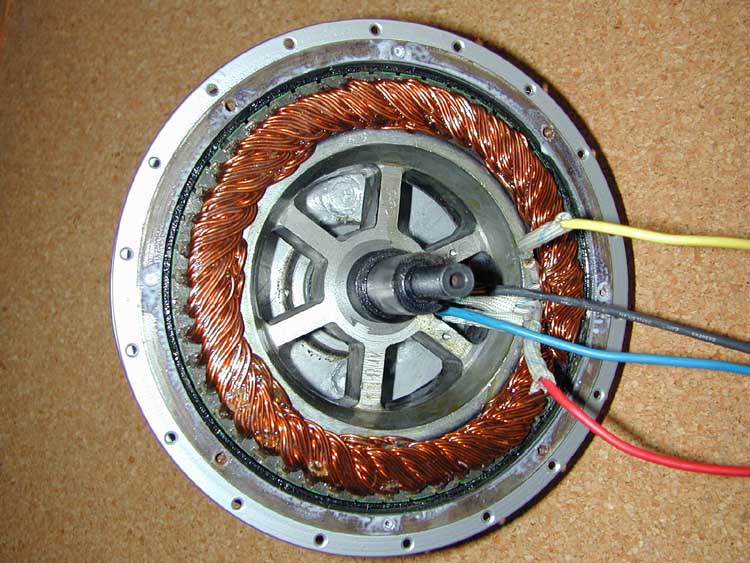

I found some more pics web surfing:
If you look at the bike motors webpage they have a link to a 1kw downwind turbine.
Also, do a google search for Futurenergy and you'll see that they are selling 12,24,32 & 48 volt mills using these motor/alternators...

Thanks for the pics. That's nice to see where they placed the hall sensors.
