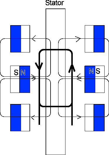

powerbuoy , i ment to ask you about your torus stator , if you tried it with opposite poles on opposing rotors ? i'm very curious
« Last Edit: May 19, 2006, 08:45:52 PM by willib »
powerbuoy
  • Posts: 208
Re: google video
« Reply #5 on: May 20, 2006, 10:29:21 AM »
Yes, ... the poles are opposing indeed. They have to, otherwise there is no current induced in the coil. It has to do with the famous right hand rule. I'll try to explain it. The coil sits in the middle on the rotating donut. On the right and on the left sits a magnet. The coil is now getting hit with a field from the right and from the left.
A coils "right side" which gets hit with a North field from the right will experience a current in the "up" direction.
A coils "left side" which gets hit with a North field from the left will experience a current in the "down" direction.
If you do a North South, then you will see that the currents might go on both sides Up, Up or down, down, ...therefore no circulation.
I hope I used the right hand rule in the correct manner, (might have switched the Ups and downs)if not then I'll apologize, but the principle described above is a good way of showing what goes on in the toroid.
Hope that helps, let me know if you need more infos.

so would the magnets be comming out of the page in your diagram?
they woud have to , to cut across the coils
you didnt answer my question , did you try opposite poles on each rotor? ie a standard rotor configuration?

« Reply #9 on: May 21, 2006, 12:02:18 AM »
not quite , imho
your diagram the coils are horizontal to the magnet faces ,
in his diagram , and in the torus , the coils are vertical to the magnet faces.
but i still think it will work ,my way , because there would be a north cutting one side of the coil , and a south cutting the other side ,
 with no core , it would not work.
but with a core i think it would  work
« Last Edit: May 21, 2006, 12:02:18 AM by willib »

I drew it up in a different way, it shows better how the flux goes and how it hits the coils ...Let me know what you think ... looks big but its only a couple kilobytes ...:-))

Ghurd ,i just rethought powerbuoys your righthand rule explaination , it seems to make sense, i think
i would like to  experiment , just to make sure though.

Also, I forgot ...there are two potential advantages with this design. No 1 ...in a typical pancake design (like the brake drums) you'll have the coil ends which are not being hit by a magnet, therefore they are just dead wire resistance. In this donut configuration the coil ends are short.
No.2 ...look how many coils you can wind on the donut. You can easily put 36 side by side on this unit ...
Drawback might be heat. You see, the donut has the highest display of flux density and the heat has to pass the coils to get out. But, maybe this is a very efficient design and will not produce too much, worth a try. I built mine with pride, ...but used way to weak plates, too large distances and so on. Maybe its time for an upgrade ...
Anyway, ... we have seen the brakedrums for a while now and there are some people here on the board who have them figured out a 100%. Maybe the toroid can push us into a new direction, once in a while one should try something new. If someone can pull it off then it's this board.
Powerbuoy

« Reply #18 on: May 23, 2006, 08:08:40 PM »
give me some days to dig it up ... the parts are all over the place.
so far from what I recall.
The magnets:
12 on each plate 1" x .5" x .25  total 24
diameter toroid OD I believe is 9", ID is 7"
windings, 36 coils, 45 windings, AWG22
RPM roughly 500
voltage star 46V open
amps shorted 2.5A
« Last Edit: May 23, 2006, 08:08:40 PM by powerbuoy »
