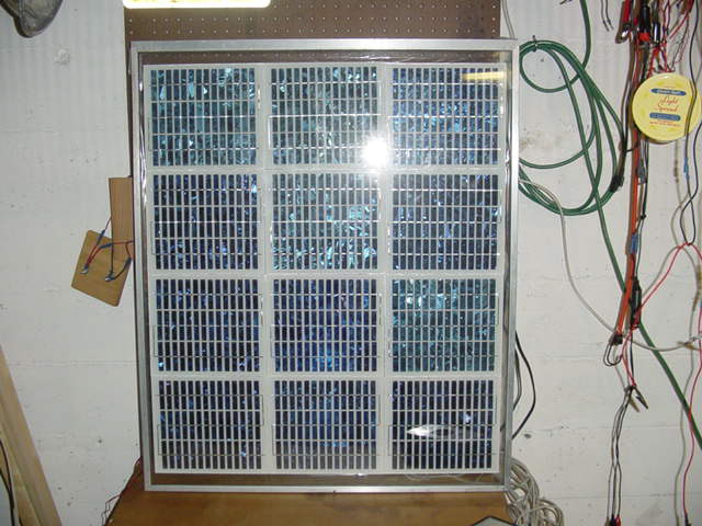

The front, made out of an old storm window.

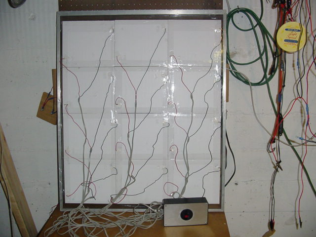

The back. Packing tape holds it together, and to the window. Zip ties hold the cables so they stay somewhat neat.

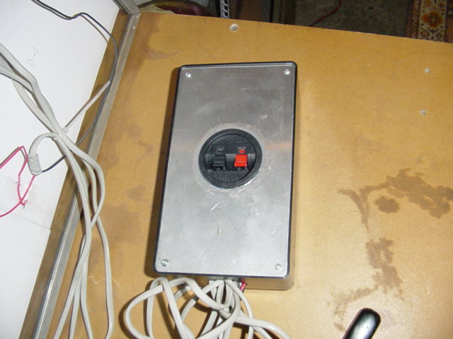

The lid of the Junction box. A spring clip speaker terminal was a great idea, I thought.

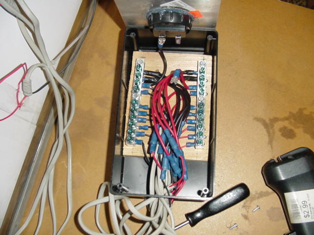

The Junction box guts. 2 buss bars, wires, and no magic smoke. Yet. Note the $2.99 cordless B&D drill (Works great!)

Why all the in-line cable joiners inside the junction box?

Now that I look at it... I have no idea why I did that. There are a few "Y" connections in that mess, and I think I needed the length.
This is the second incarnation of the J-box. The first was hammered copper tubing, drilled, bolts and nuts installed, and mounted to a block of wood.

Anything else to help me get this in top shape?
The weather is your enemy. If I was doing this, I'd be using an IP66 diecast aluminium box. But that's just me. Lots of silicon sealant might be your next best avenue of attack.
