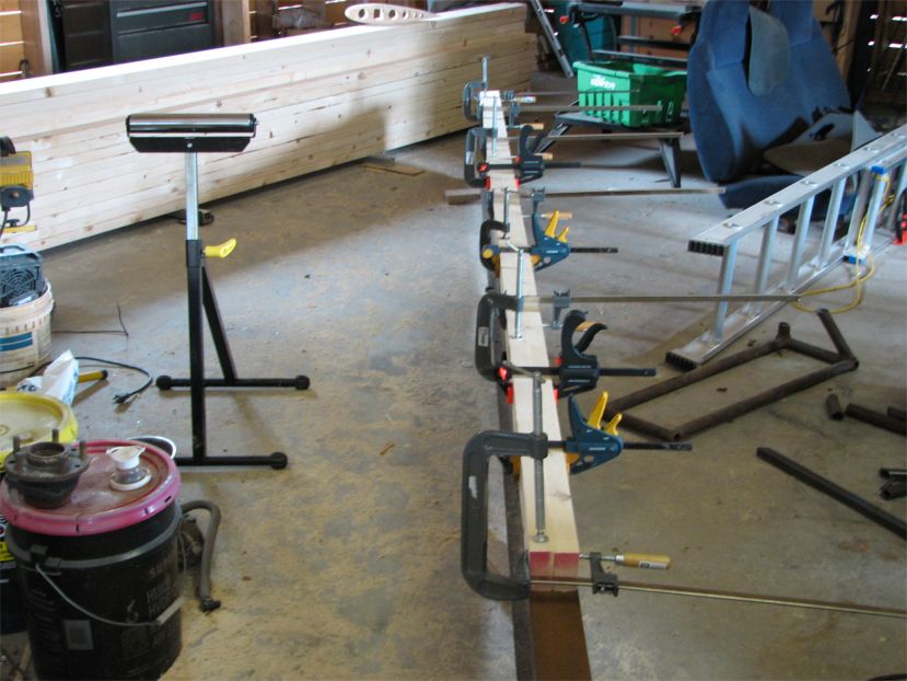

Well I decided to actually build the monster, a straight bladed H-Rotor VAWT with 12 foot blades and an 18 foot diameter. I have started with the blades first and have a huge amount of glueing to do.

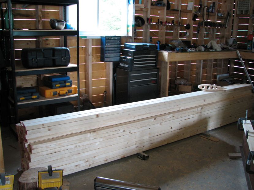

Here is a pic of the pile of lumber I am using to build the blades:
This pile of lumber is 39 spruce 2"x6"x12' that has been halved to create 78 2"x3"x12' pieces. The idea is to laminate 13 of these pieces together which will eventually form half a blade. This will be done 6 times to create 3 blades. I am initially building 3 blades for this turbine, however I plan to build my hub so that I can use either a 2 or 3 blade format. If the performance from a three blade configuration is poor then I can use the two blade configuration that worked well with my 3'x5' model. I expect I will be glueing these together until mid summer before I can actually start shaping these into blades, since I only have the one glueing jig (12" I-beam).

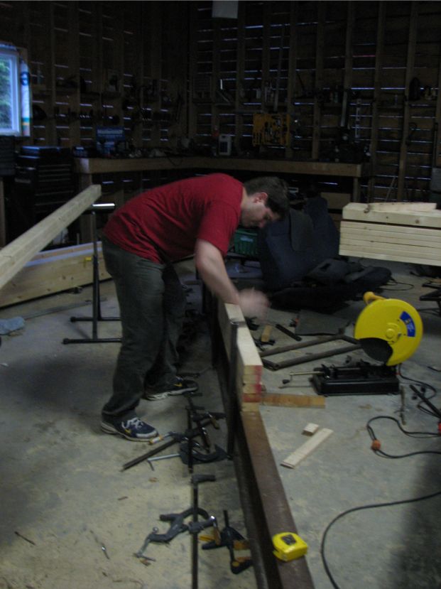

Here is a pic of the jig:
I will have to glue 72 times just to create the laminated half blade pieces. I have been at it now for a couple of weeks and it has become my daily religious ceremony to the wind gods, I must perform the glue ritual each day ;-)

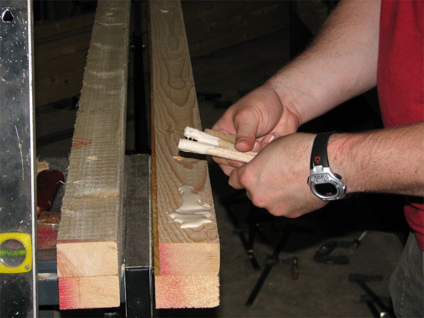

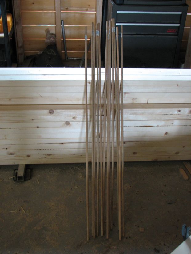

Here are the wooden dowels that will be used to strengthen the laminated half blades:

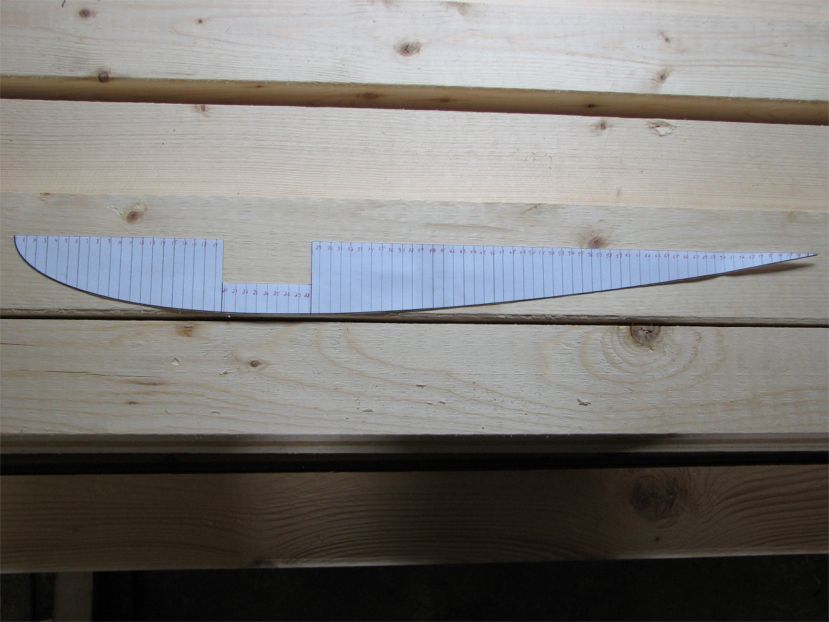

Here is my template with 80 stations that will be used to shape the blades:
I will add to this build diary as progress continues, since I will be mainly glueing for some time, it will be a while before there is any major progress. I am thinking strongly about modifying my glue jig so that I can stack and glue more pieces at a time.

« Reply #12 on: May 31, 2006, 12:28:07 PM »

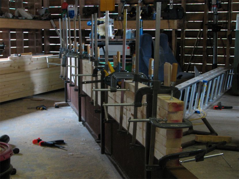

I got a few more clamps and modified my clamping jig by welding some uprights to it so I can glue and stack now and do 3 days worth of glueing in one day. Thats much better, I couldn't imagine glueing everyday for 3 months, but I can handle 1 month of glueing.
Here is a pic of the updated jig:
thats all for now,

I am glueing 2 and sometimes 3 pieces together at a time for a couple of reasons. First is my limited tool supply. I have a short 7/16" drill bit that will only go through a maximum of 3 thick when drilling holes for the wooden dowels that are going to glued through each half blade. The next tool problem is my thickness planer only will plane up to 12" wide pieces, so I can't glue together too many at once. Then my jig will only allow me to glue together a maximum of 7 pieces at once. I also think that glueing them in 2 and 3 pieces at a time helps straightnen the pieces. Some have had some warpage and glueing them this way seems to help with that too. Now if you are wondering why I am building half blades as opposed to just glueing together the 2x6's to start with and carving out the blade shape, it is because I am putting in a steel spar. If you look at the template pic above you will notice a notch mark in it on the straight side. This notch will run down the length of the blade and allow me to put in my steel spar.
I hope that that answers your questions as to why I might take this seemingly strange approach to building blades.

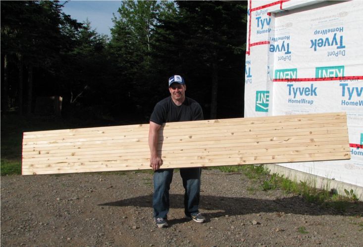

Here is a picture of me holding the 12' long laminated section of 13 pieces. This piece will eventually be half a blade. I am slumped over and my knees are buckling under the weight of this blade section. Hurry up and snap the picture already! It weighs around 200lbs so it was a pretty good lift. A little more gluing (only 5 days of it left, hooray!) and then on to the thickness plane phase.

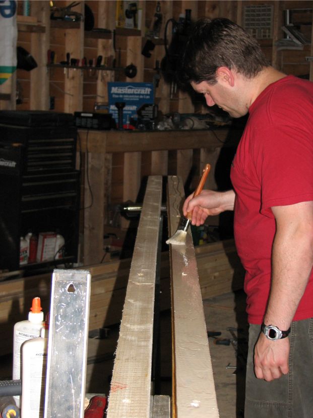

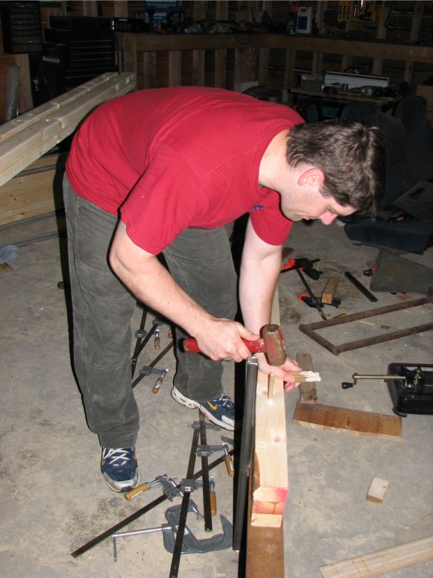

At last the second gluing phase has wrapped up. I took a few pics of the last quarter piece being laminated.
First I coated the dowels in glue:
Then I hammered them into the piece on the jig:
Then I brushed the glue on the already laminated 2 piece:
Then I joined the two pieces together:
This process was repeated for the next piece of 2 laminated wood. Then the unit was clamped to the jig. Finally, the last quarter to be laminated. I now have 12 laminated quarter pieces, six of 6 pieces laminated together, and six of 7 pieces laminated together. The next phase is the planing phase. Unfortunately the planer is in need of repairs and I have to wait until the parts come in for it.
