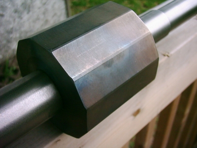

I thought I would borrow a picture from Zubbly, who is in the process of modifying a 7.5 HP Baldor motor, to illustrate something to you.  He's probably busy working on it right now.
Search for his posting on his progress on this conversion: he's leading the way for us, IMHO.  The flats on this rotor, made from scratch, securely locate the magnets and facilitate their alignment.
On close examination, the flats of this rotor show no skew.  To machine the part with skew would be very difficult, without an expensive bill from a CNC operator.  I can only assume that he's going to arrange skewing in some other fashion.
A possible improvement on the rotor would be to machine two arrays of flats, one end offset several degrees from the other.  It would work with the drawing you posted above.  Magnets 1/2 as long could be fitted, bonded, and/or screwed down.

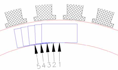

Re: (But I ain't Zubbly)
« Reply #46 on: June 17, 2006, 10:24:46 PM »

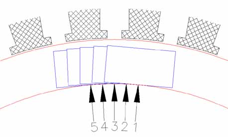

If it's a choice between two rules of thumb:
"first and last magnets aligned over adjacent slots",
and
"skew the rotor by 10 degrees to de-cog",
I'd go with A)
Comparing the rotor of your motor to mine, yours has a smaller diameter, but is 2x
as long.  The rotor I will convert is 5.5" in diameter and 2" long.  The same skew
angle should be used on your rotor and mine.  The resulting helix angle would make
yours look very different than mine, but that's not what we're after.
Permit me, then to refer to first principles (A collective sigh from the non-geeks
out there; I can hear you).  But I know you're a mechanical engineer, so I'm sure
you will relish this. :^)
In the first view, five (5) magnets are arranged on the rotor in a skewed fashion.
The stator teeth are visible above.  I assumed that there are 36 teeth in the stator.
The rotation between #1 and #5 is 10 degrees.  Mag #1 is currently aligned with
the top stator tooth, Mag #5 with the tooth to the left.  Both are as close to
the stator tooth as they're going to get, and their magnetism would keep them
there, because the are attracted to the iron teeth.  Mag #3 is in between teeth,
so it could go either way.  Mag's #2 & #4 are attracted to opposite teeth;
their pulls cancel each other out.
In the next drawing, the rotor has rotated by 5 degrees.  The magnet closest to
a stator tooth is #3.  Mags #1 and #5 are between stator teeth.  Mags #2 and #4
are attracted to the same tooth as #3, but on opposite sides, so their pulls
cancel out again.
I haven't shown intermediate positions, but when I tried them in CAD, and measured,
I found that magnets tended to pull to one tooth more than another.

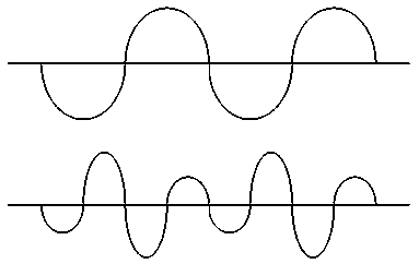

When you look at it from a "Potential energy" point of view, then the first
position has the lowest PE, this is where the motor will prefer to cog to.
The second position also is a low point of PE, but not as low as the first.
Intermediate positions had a preference for one tooth or another, but two
magnets are still cancelling each other's cog, like in the other two points.
Picture a sine wave with a harmonic in it that makes one valley lower than the
next valley.  Compared to the original sine wave, with higher peaks, less
energy is required to get over each peak.  It takes now less torque to start the rotor.
Therefore, this skewing is not so much "DE-cogging", but "LESS-cogging".
I hope this helped.
If there is any arrangement of magnets that further improves on this geometry,
then it would be of benefit to investigate.
« Last Edit: June 17, 2006, 10:24:46 PM by SparWeb »
« Reply #47 on: June 17, 2006, 10:49:56 PM »
Thanks Steven, it confirms what I was thinking myself. Nevertheless, Zubbly's skewing method has proven to work, whereas my smaller angle hasn't proven itself yet. But I think theoretically you & I are correct here. It's all a matter of projection, it depends from what direction you look at the rotor. An angle of 10deg in one projection can not be simply transferred to another projection. But I'm not sure if this is what Zubbly was actually doing, that's why I keep hammering on this to get it clarified. Maybe I'm annoying, so be it.
I've made another drawing that explains it as good as I can. It's similar to yours.
http://www.otherpower.com/images/scimages/3538/explanation_for_zubbly.jpg
http://www.fieldlines.com/comments/2006/6/18/11456/6477/2#2
Peter.
« Last Edit: June 17, 2006, 10:49:56 PM by dinges »
« Reply #48 on: June 18, 2006, 02:10:52 AM »
Peter,
you are cunningly running this thought in two threads. I had not read this one till now.:)
The problem with your description of your angle definition, is that it relies on the length of the rotor. The shorter the rotor, the steeper the angle in your reference (3.5 deg). A shorter rotor would be more deg, longer would be less.
In Zubblies definition, it doesn't matter what length the rotor is, his definition defines the start and end points with a radial deg measurement. So his 10 deg is relevant for all rotors in a 36 slot config, regardless of the rotor lenghth. Your 3.5 deg is dependant on rotor length, and as such is pertinant only to your motor in its use.
Have fun with this conversion, and don't get too bogged down in definitions. It is clear you understand the concepts involved, so I expect a successful outcome here.
.......oztules
