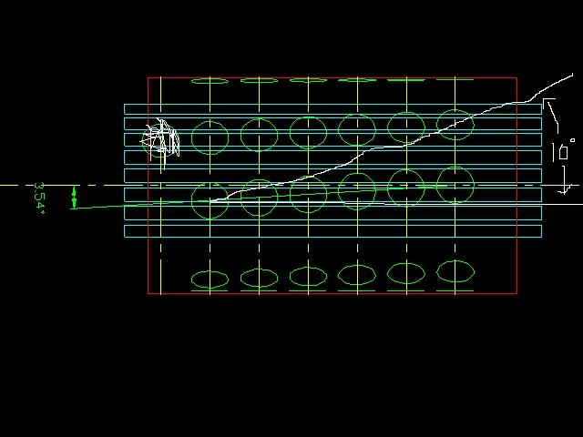

Below is the current design for the rotor; nothing is final yet, so there may be changes.
Next step: ordering the magnets and building of the rotor. Drawings are more or less finished, only have to make one calculation (of rotor to axle), the amount of negative play to end up with a strong enough crimp.

Another try w.r.t. skewing the magnets.
In the picture below we see the rotor; the blue lines are a projection of the stator ribs/slots. As can be easily seen, the left-most magnet is over an adjacent stator rib from the right-most magnet.
And, what's more strange, at first sight: the magnets are not skewed by 10 degrees but by 3.5 degrees !!
BTW, thanks Sparweb, for the reply to my initial diary. It confirms what I was thinking. I hope Zubbly understands my explanation. I'm curious whether, when he talks of an angle of 10 deg. skewing, he skews 10deg where I skew 3.5 deg; because, strange as it may seem at first, in my drawing below, the magnets are skewed by 10 degrees and by 3.5 degrees, depending on the projection of the rotor! Maybe I've misunderstood Zubbly here, but I don't think this point can be made too clear for other readers on this board.
So, Zubbly, please (dis)confirm: the angle in my drawing that is 3.5 deg, do you make THAT ONE 10 degrees? Because if so, then your magnets would not span 1 but several stator slots.

Peter
As far as I can see, the skew angle depends on the number of slots and the core length, you seem to have it right for your case.
I can only comment on some alternators I made years ago with Alcomax magnets and with steel pole shoes. These had very defined edges compared to neos and it is obvious that with neo things are not as critical.
With the steel poles, without skew you needed a pipe wrench to turn it and it turned like a stepper motor. Any skew helped to some extent, but there was one angle where cog virtually vanished, it was very critical and was not the theoretical angle, but close.
I think with neo the field has "soft" edges. The worst case I think will be with curved neos that fit the stator curvature. With block magnets or lots of smaller ones the field edge is not well defined and in some cases it may even work with any value of skew angle.
Once again it seems that hours of mathematical analysis will at best only give you a starting point, but with your magnets it is likely to be good enough.
I proved these angles with the steel poles by skewing the core pack, which was far easier than making lots of pole shoes with different skew angle.
Again the issue with neo may not be the same as with steel pole shoes, but as long as cog was not severe I never found it to be the issue that determined start up.
With even a fair bit of cog, the thing would rock itself off the cog point and start rotating in modest wind. It took a lot more wind to overcome the iron loss and pull out of stall and come up to speed.

Peter how does this magnet configuration match up with the coil span?
 If you skew the mags and its to narrow and doesnt cut in and out itll probably cog pretty bad.
 Go to Zubblys anotherpower photo gallery i think its page 7 and hell show you the relationship of the two.

« Reply #5 on: June 18, 2006, 09:16:04 AM »
hi again Peter,
it boils down to this. the drop string check i have mentioned should land one slot over. you can view it as 10 degrees or 3.5 degrees, or any way you wish, as long as the string check is observed.
a few other things can possibly come into play. the width of the mags you use and how they cross the stator tooth barrier related to their width. in reality, you could be off a degree or 2 either way and still work out fine. but i just suggest to shoot for the one stator tooth offset as a standard starting point. this is "not" an exact science as there are way too many variables that can come into play. i am just trying to keep instructions as simple as possible. if you wish to take analysis to the extreme thats great as some may appreciate a more in depth explanation to relate to.
just one other thing i wish to mention. when plotting the exact location and centre distances between all the mags in one pole, think of it as one magnet. keep the mags as close together as possible but with still maintaining structural integrity. assuming you use multiple round mags and depending on what material you make a magnet cage from, on aluminum i try to keep a wall thickness between mags (at the turned down rotor surface) to approx 1 mm of aluminum between mags. you may find thatincreasing it a bit may be better to help form the ideal mag pole width. this is part of the reason why i sometimes use 1/2 inch diam mags or 3/4 inch wide mags.

« Reply #6 on: June 18, 2006, 10:06:50 AM »
Thanks Zubbly,
In that case I think I misunderstood you. You do skew one slot, not 10 degree; then I made the 'error' of taking an angle in one plane and transferring it to another :)
It's just that in your pictures it looked like you skewed very much more than the 10 degrees/one slot.
As to the width (and the volume) I have limited choice of suitable magnets, 12.7x6 and 15x8. I'd rather have 12.7x8 or 12.7x10 (your 1/2"x3/8") for more magnetic volume, but alas. Also because I'd rather have less spacing between the magnets and a bit more span on the rotor. It's just that it doesn't work out very well with these magnet sizes. :(  Will check if I can fit 20x10 magnets in, this may be the last option.
As to the span of the coils: I don't think it's 12-10-8 wound; at least, inside the coil there are 5 free slots, not the 6... Strange. Are there other systems of winding too than 12-10-8? If so, I hope it won't have an effect on converting this motor.
Glad the misunderstanding is solved :)

« Reply #7 on: June 19, 2006, 08:18:49 AM »
Hello Dinges,
  I think I know what is confusing you.
One stator tooth creates a skew angle of 10 degrees.  The line of that angle has no width.  We see that angle as a 2 dimensional image.
Magnets have width, which adds a 3rd dimension.
Try to imagine your placement of 12 magnets as one big magnet.  In your drawing above, your 3.5 degree angle does not measure to the top of the magnet.
Measure the angle of skew by measuring to the magnet in the upper right hand corner.  That should be closer to the 10 degrees of skew.
When you measure the angle, measure to the center points of each individual round magnet.
Does this make sense, or do I need to explain further?  (Your picture showed 13 round magnets, with 7 in the upper row.  I scribbled out the 13th magnet for clarity.)

Try to think of the group of 12 little magnets as one big magnet.  Measure skew of the magnet group as a whole.  You were measuring skew by thinking of one row of little magnets as the whole magnet.  Having 2 rows of little magnets changes the angle you need to measure.  You need to measure to the top row of little magnets to get an accurate skew measurement.

You were right, that leftmost magnet shouldn't be there, had added it as an aid while drawing. Because the leftmost and rightmost magnet should not be exactly at the same position (but over different stator slots); only if you add an EXTRA magnet, than that magnet should have the same position as the first one. If the first & last magnet occupy the same position (over a different slot) one would still have slight cogging, I think. But maybe I'm nitpicking :)
As far as angle goes, I disagree; see rest of my explanations. However, I think that the full width of the magnets should fit between the two coil legs. So, if you measure the width of the coil (say, 50mm), then the skewed magnets (full span, tip to tip) should fit inside, I think. But again, think I'm nitpicking here.
To be honest, like with axial fluxes, you have to really screw up to end up with something that does not generate.
Peter.

This evening some work has been done (finally) on the rotor for the 3HP conversion. A totally new steel rotor has been made (out of one piece of C45; old axle is discarded). An aluminium sleeve had been machined. It was Loctited in place. However, .02mm positive play (on diameter...) is too little for Loctite. As if we shouldn't have known. Not even 40.000kg (40 ton) of pressure could get the last 28mm (abt. 1") on. So, excess aluminium sleeve has been cut off. A new ring will have to be machined for the other end and Loctited in place.
Too bad it will have to be patched up, when it could have been perfect.
When that's done, pockets for the magnets can be machined and Loctited in place. That'll be for another time though.
Pictures are below. I'll let them speak for themselves, without too much commentary. Have been reduced to 40% kB-size, but will resize next time to 20%. Not much detail seems to get lost.
