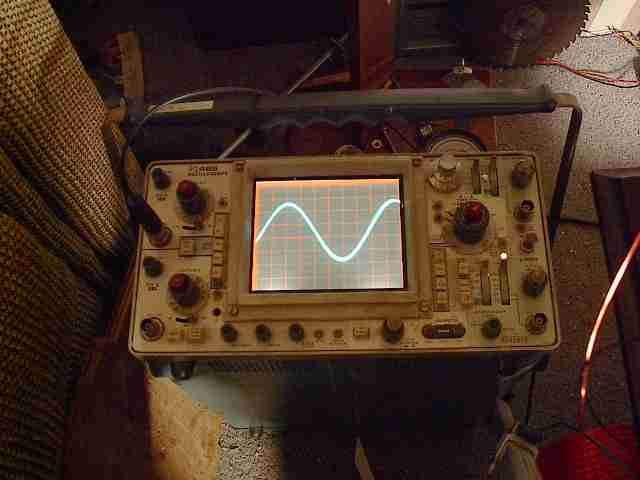

« Reply #20 on: June 28, 2006, 02:08:48 AM »
why bother ?
what would be the point? of someone taking the time to prove one way or another , people are still making the inside of their coils the size of their magnets , when i proved that making the inside of the coil considerably less than the magnet size did not detract from the output in the least , it still  produced a perfect sinewave .
these are the specifics
magnet dia. 0.875"
coil OD 1.5"
coil ID 0.5"
  1. poles
  2. " dia rotor
dist. between magnets approx 0.480" dont remember exactly
so why bother?
« Last Edit: June 28, 2006, 02:08:48 AM by willib »
Re: Idea for ultra compact coils + easy to bending
« Reply #21 on: June 28, 2006, 03:55:16 AM »
I'm not aware of any experiments of this kind that you have done, Willib, so if you've published it somewhere on this board, please provide the link.
As far as a 'perfect sinewave' goes: did you perform a Fourier analysis on it (or something else) to determine the amount of harmonics and shape of the sinewave? Because in my experience, something that looks like a beautiful sinewave sometimes isn't so perfect.
Modern digital scopes (like Tektronix TDS210) can perform a Fourier analysis/spectrum analysis) and can show you the amount of harmonics present. Just judging a sinewave 'by looks' on a scopescreen is dangerous in this case, I think.
« Last Edit: June 28, 2006, 03:55:16 AM by dinges »
« Reply #22 on: June 28, 2006, 07:24:47 AM »
dinges;
I have to agree there. I try not to get involved in this stuff too much but a lot of people make claims that just do not add up. Constructing an entire theory from one data point based on one visual observation is unlikely to be accurate.
Just an opinion based on a couple decades of troubleshooting.
Carry on.
« Last Edit: June 28, 2006, 07:24:47 AM by TomW »

yes you were not around , or i'm sure you would have commented..
this is the conclusion that i came to , you can back up if you want to ,at the time i was under the assumption by visual analysis , that there would be a cancellation effect due to the inner windings being smaller than the magnet size, but the opposite was true .
there was no cancellation because as a magnet approached the center of the coil the wave was approaching zero .
in an effort to be dialup friendly ive included a smaller size photo of the waveform , below.
30KB
http://www.fieldlines.com/comments/2006/3/16/195739/099/33#33
this is the complete discussion.
http://www.fieldlines.com/story/2006/3/16/195739/099
i dont really believe there is a need for Fourier analysis , considering the waveforms produced by skewing a conversion probably dont look half as good , and no one ever asked Zubbly to do a Fourier analysis on the wave comming from his machines , and they charge a battery perfectly well.
« Last Edit: June 30, 2006, 05:16:12 PM by willib »
