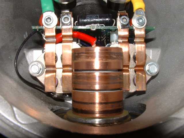

With camera and tools in hand and Quaz tied up I went to get the info for reverse engineering. This might be the last time I could get to this unit. I cracked the case to reveal this.

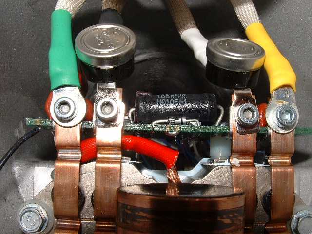

To my surprise a saw what look like two thermal switches. What for who knows.
It was late at night and I have to work fast. Next picture of the slip rings.

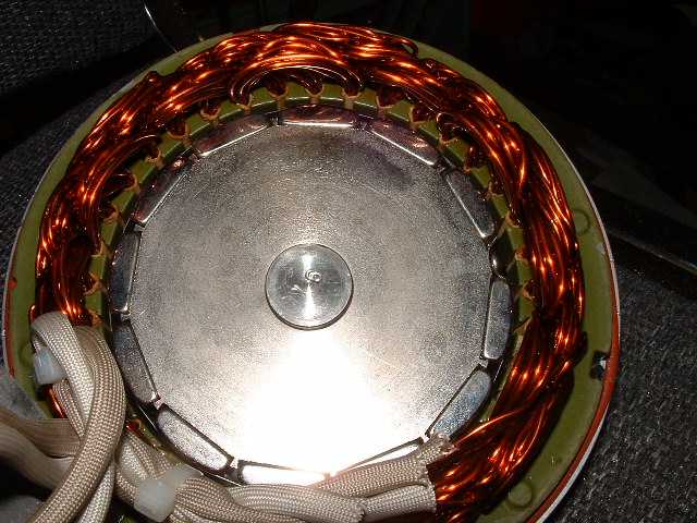

The rotor and the coils. Looks like a auto alternator conversion.

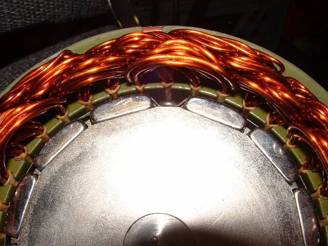

I noticed a small gap between the magnets and had to get a closer look.
The magnets are held in by a band of stainless steel and a small screw. I wonder if the magnets are glued in also? The magnet are flat on one side and quite rounded on the other. They do not follow the arc of the metal lams. These things must be to minimize cog. MR. X

Yes shaping the poles to form a non uniform air gap does help reduce the cog.
Any departure from a totally uniform gap will help. On larger machines it is done to improve waveform, but that doesn't matter here.

Can you explain how a non-uniform airgap reduces cogging?
And if it does, flat magnets should do the trick too? Because then the distance in the middle of the magnet to the stator would be bigger than at the sides of the magnet, basically an 'inside-out' situation from what's pictured above.
I like the idea of the stainless steel band to secure magnets in place.

The overtemperature safeties have me puzzled a bit too... When the stator gets too hot it disconnects, causing runaway of the prop, I'd think.

« Reply #4 on: June 28, 2006, 03:44:45 AM »
On a closer look... The curvature of the magnets is almost equal to the curvature of the stator, suggesting that the manufacturer wanted to keep airgap as constant as possible (which would cause MORE cogging?).

   Last one of these I saw had caramelized coils, hence the thermal cutouts perhaps? Also, SWWP sells individual blades as spare parts so overspeed probably doesn't worry them too much. I think the blades on these things flex into stall at high speed regardless of alternator load anyway, noisy but usually effective.
  Paul.
« Last Edit: June 28, 2006, 05:28:59 AM by PaulJ »
There is a measurable difference in the edge as apposed to the middle. I would say that a square edge must have sharper flux lines and would be closer at the edge thus more cogging. X

« Reply #8 on: June 28, 2006, 04:05:28 PM »
Interesting it almost seems instead of skewing one slot.This setup skips a slot for reduced cogging maybe.

« Reply #17 on: June 29, 2006, 07:57:02 AM »
I think the cog is further reduced by the unequal spacing in the magnets.  There is that gap, for the screw that holds the stainless band, which means the magnets dont line up perfectly with teh slots all around.
Even with all that though - these machines still have a fairly serious issue with cogging I think.  It takes quite a fair wind to get them spinning.

Flux mentioned waveform, then I noticed the space between the magnets for the screw.
Would the irregular spacing of the magnets cause a hiccup in the waveform, or introduce a harmonic?
Or would it all come out in the wash?
While testing my genny, I hadn't glued the magnets down as I repeatedly re-arranged them - at one point the stator touched the magnet faces and moved them around a lot.
But I didn't notice any effect on the voltage....
Intriguing photographs, BTW.
Perhaps the thermal switches protect the generator, but the blades can handle whatever wind speed mother nature can throw at them...?  Hence over-speed isn't an issue.

I'm interested ine SS band, and those 105c thermal cutout switches.

« Reply #21 on: June 29, 2006, 07:28:28 PM »
In my 12 volt 403 Industrials (2) the stator coils are as follows:
Outer phase 50 turns of #20.
Middle phase 22 turns of #17.
Inner phase 18 turns of #16.
I know this because I just finished rewinding one with equal phases of 30 turns of #18 in an attempt to get better low wind performance. This will raise the cut-in speed but will be made up with a boost converter a la Flux. The swept area will also be increased.
My rotor is different than shown above with unarced rectangular skewed magnets. There's virtually no cog. I don't know if this came before or after the one shown.
