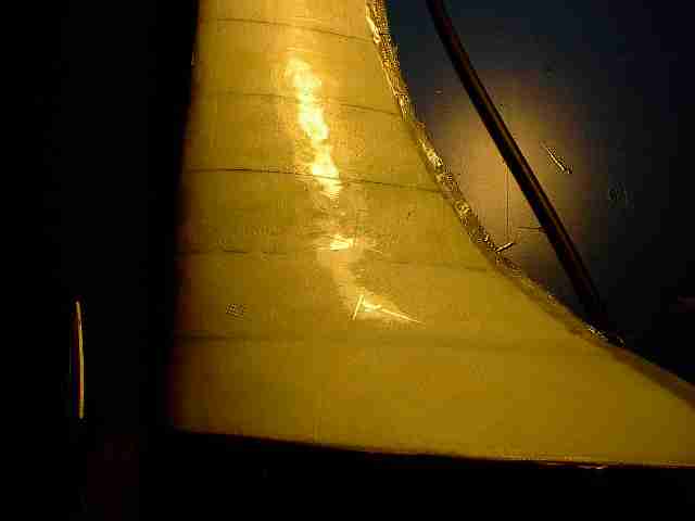

this is the blade now , its curing in the vacuum bag.
i hope this comes out ok.
i've finised the outside shell on both sides it looks really nice.
i had a tough time figuring how to get the two halves to meet correctly at the trailing edge .but vacuum baging seems to do the trick..
i just checked it , it looks done !!
i'm going to leave it on for a little bit more

why does the blade look like the foam blanks i was doing before ,you might ask?
thats because i didnt know how the canned foam would turn out , so i made another blade and first epoxied it to one half, then i epoxied the leading edge , and just now i epoxied the windward half to the shell , and the trailing edge.
« Last Edit: July 03, 2006, 10:55:26 PM by willib »

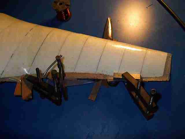

Re: blade almost done
« Reply #2 on: July 03, 2006, 11:08:42 PM »
it was still tacky so i used a few clamps to seal the trailing edge a little better
« Last Edit: July 03, 2006, 11:08:42 PM by willib »

really shiney huh?
that is the lift part of the blade you are looking at .
the shell is epoxy and glass , the inside is shaped foam
now i have to trim the trailing edge , epoxy the root base on , (that i hook the blade to the hub with ) and test it.
