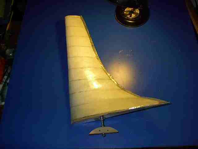

i was thinking of ways to test out my blades.
What parameters should i use to test them
what i have to work with is
a 16" fan
a mini gen
a 0 to 20 N scale
scope to measure rpm
multimeters
i was thinking of a no load test vs. a loaded test.
but i dont want the measly gen output to detract from the focus of the experiment.
the epoxy glass combo added about 1N weight to the blades
they weigh about 1.15 N without the epoxy glass and about 2.15N with the epoxy glass
http://www.digitaldutch.com/unitconverter/
sorry about the weird weight scale but thats all i have to measure weight.
1.15N  converts to 0.26 lbs i think.
so each blade weighs a  1/4 lb , before epoxy glass, 0.48lbs after , and that includes the wooden hub mount, four 1/4 20 nuts about three inches of 1/4 20 threaded rod , and four lock washers and four flat washers.
getting back to testing
since i only have one epoxy glassed i had to add weight to the other two.
so i found two metal objects about 1N in weight and got them balanced.
how should i test them.
i think , that a 200mA load is the same , no matter what  the alternator parameters are?
when testing these before (pre glass) i got about 1.5A  out of them , the tips were bent back  a couple inches , which is one reason i went and made the shells for them.

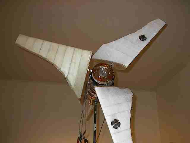

Well willib, I think you have a number of problems. Is it just the picture or my eyes, but do all three blades have a different planform? Why would you want to test a rotor with three different blades? The results wouldn't mean much and vibration would be an issue.
"i was thinking of a no load test vs. a loaded test."
I don't think an unloaded test tells you anything usefull other than it rotates. My grandson's pin wheel does that.
"a 16" fan"
You can't use a small fan on a rotor that's much larger in diameter and get anything usefull. Short of a wind tunnel or a much larger fan (questionable because of swirl), I'm afraid you're stuck with the wind.
"i think , that a 200mA load is the same , no matter what  the alternator parameters are?" Wrong. Measuring power out of an alternator requires knowledge of the alternator efficiency vs. output to extract the rotor power.
You can't put balancing weights on the airfoil surface. It will alter the airfoil lift.
Kitno455 has the right idea. Set up a Prony brake to measure the rotor torque. Apply a variable load to the alternator and record torque, RPM and windspeed (you DO need an anemometer in any case). From that you can extract the rotor performance.
In my opinion, you're in for a disappointment. Blades with those tremendous roots are going to have loads of drag. I'd be very surprised if you exceed 20% rotor efficiency and a TSR of two.
I think you've gone wrong from the start by taking the results from a blade calculator and then only using a section of that result. Don't think you can do that. You keep quoting a TSR of 6 which is probably what you plugged into the calculator but by only using a piece of that design, the TSR goes out the window.
Did you ever come up with the performance data for that airfoil?

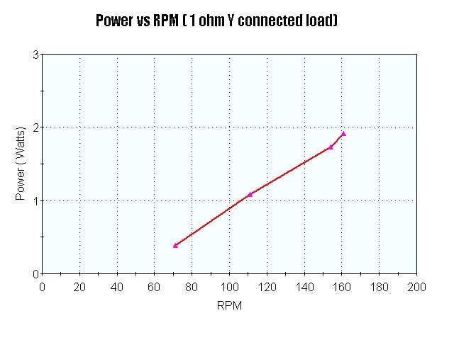

« Reply #6 on: July 06, 2006, 07:46:39 PM »
this is what i got.
http://www.otherpower.com/images/scimages/2965/line_299DC3A8.jpeg
this is with a Y connected load of three 1 ohm resistors.
its all i had.
i could maybe scrounge up some 1/2 ohm resistors .
i varied the wind as seen by the blades
i'm not sure what this means , but i think the blades are stronger than the alt, because when i short out all three phases together , it still turns.
« Last Edit: July 06, 2006, 07:46:39 PM by willib »

I thought this post was about measuring rotor performance.
Your graph only says something about the alternator since you didn't supply wind speed.
As a reference point, an area of 9.6 sq ft (3.5 ft diameter) has an available wind power of 49 watts at 10 mph.
« Last Edit: July 06, 2006, 09:52:45 PM by SamoaPower »

« Reply #8 on: July 06, 2006, 11:06:00 PM »
Wind speed ... i am using a fan.
i do not have a wind gauge.
49 Watts !! on what planet?
try 20
« Last Edit: July 06, 2006, 11:06:00 PM by willib »

"Wind speed ... i am using a fan."
Doesn't work, period!
"i do not have a wind gauge."
There is no meaningful measurement you can make on rotor performance without knowing wind velocity.
"49 Watts !! on what planet?
try 20"
Wind Power (Watts)= 0.5 x rho x V^3 x A x K
where:
rho = air density in slugs/ft^3 = .002378 (nominal)
V = wind velocity in mph = 10
A = swept area in ft^2 = 9.6
K = units factor = 4.31
Pw = 0.5 x .002378 x 1000 x 9.6 x 4.31 = 49.2 watts
This is the power in the wind. Not the power out of the rotor or out of an alternator. This is what you have to start with. For a Cp=0.2 (overall efficiency), you would see about 10 watts.

I was tempted to keep out of this, but I have to agree with Samoapower.
Unless you have a large wind tunnel or have a decent anemometer with data aquisition system and a means of taking 1 min or 10 min averages of power over a long period and sorting the results into bins, you might as well not bother.
The only thing that you could do is to try direct comparisons between blades with identical alternators as loads, in close proximity at the same time.
From the pictures it looks as though your chord gives you a tsr of about 3. I have no idea of what it is form the angles as I don't know what they are.
The prony brake is fine in a wind tunnel, but no use in real life wind. You need a lot of skill and knowledge to make any sense from a simple fan. At least try to make some form of wind tunnel out of it before wasting effort.
Your trailing edge looks to be thick but that may be a photographic problem.
There is little that most people can do about blade design and testing with the facilities available. Some useful work has been done on blade profiles for wind power, mostly for large machines and not relevant to small ones. Some design has been done on profiles for small blades and if you can get hold of those profiles and use them as intended they should be fine. Use them not as intended and all the benefit goes out of the window.
Many promising sections that have worked well for aircraft fail to show benefit for wind power.
Unless you are quite skilled in this field or have exceptional facilities you will not do any better than the type of blades that DanB or Hugh Piggott use unless you are extremely lucky and the result could be much worse.
Your ideas on alternator design are odd but are easily verified. By all means keep posting your blade ideas, but I would advise others to ignore it until we have genuine proof of results.
I try not to be negative in my comments but there are times when it seems to be necessary to prevent others with limited experience thinking that they are reading something useful.

"From the pictures it looks as though your chord gives you a tsr of about 3. I have no idea of what it is from the angles as I don't know what they are."
station # , angle , chord length
  1. , 42 , 13"
  2. , 23 , 10"
  3. , 14 . 7.2"
  4. , 9.5 , 6.2"
  5. , 6.5 , 5.3"
  6. , 4.5 , 4.5"
  7. , 3 , 4"
  8. , 1.9 , 3.8"
  9. , 1 , 3.3"
  10. , .3 , 2.6"
i took some liberties in my designs as most people do.
what i did was i took the chord lengths from a two blade design and incorporated it into a three blade design, this gives me a stout blade , with more  airfoil surface area
i also neglected the blade calculator's choice of a root section , 20" was a little too extreme , even for me. so i made it a more reasonable 13"
« Last Edit: July 07, 2006, 08:34:52 AM by willib »

Interesting.
Not sure what angle of attack and CL you chose but from the angle on the outer part where it matters you are nearer tsr 8 or a bit higher.
If you used the chord for 2 blades they you should be 50% high on the values for tsr6 if that is what you aimed for. Your actual figures are 2 to 3 times what I would expect.
« Last Edit: July 07, 2006, 02:06:10 PM by Flux »

Yes you are right if you use 6 deg as the angle of attack. I used 4 deg.
six deg should still be perfectly acceptable, I never tried 6 deg.
Still disagree with your chord by a large amount, I think you must be using a very low value of CL even allowing for your choosing the values for 2 blade.
Your chord seems far too much at the tip. It may look worse because you have gone to the extremes at the root that the calculators imply.
I admit that my blades always want to run below the design tsr in higher winds, but seem happy at about 12 mph. I always assumed that the drag was increasing at the higher speeds but perhaps using AOA of 5 or 6 deg would be better.
I have also found that you can increase the chord a significant amount without trouble, but I think you have gone too far.
If you can manage meaningful tests then it would certainly be a good start.

Flux,
I concur about his chords.
I disagree however, about how to select the AOA. I believe willib used 6 degrees because that's the default in the calculator rather than the data for his airfoil. For best efficiency, the AOA should be that which occurs at maximum L/D for the chosen airfoil. For a particular airfoil I use, a change in AOA from 4 to 6 degrees results in a CL change of 0.94 to 1.18, which is more than 25%.
There is also a AOA correction factor based on the blade aspect ratio that hopefully, the calculator takes into account. Like you pointed out before, the calculators are just a starting point.
I don't believe that the AOA should be chosen arbitrarily, even over a narrow range of 2 degrees.

Yes Flux , that is what i meant.
would the stator have to be able  stop the blades , when shorted , to make this test more meaningful?
because it doesnt ..
and since i've changed the AOA to its proper value , its ability to stop the blades  has dimished.
they  used to run at 17 RPM with all three phases shorted
now they run at 33 RPM with all three phases shorted
this is with the fan on high
« Last Edit: July 09, 2006, 03:56:41 PM by willib »
