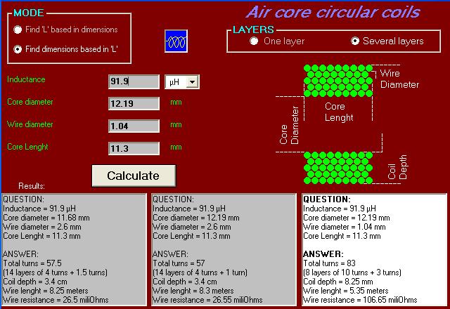

Syncronous rectification of three phase is a daunting task , but admirable.
i too was thinking of sync rectifing an alt, because as you say , diode losses can be excessive at high power.
the problem as i see it , can be broken down to sync rectifing each phase seperatly, which implies three seperate circuits.
i tried doing just that , sync rectifing a single phase , as a starting point .
i used the wave itself to drive the gates of four Fets , in an H pattern with cris crossing gate connections , maybe it was the breadboard connections that was giving me problems , i dont know.
anyway it came down to switching  , the gates , of two fets at a time , to produce a rectified sine wave
and since you would be switching them when current flow is at its minimum , zero crossing, there is little chance  of spikes across the fets, and since voltage leads current in an inductive circuit , knowing the inductance of your alt may prove benificial.
but combining the three outputs , without using diodes , only complicates the body diode problem, to a point that i finally gave up on the idea.
in the end i figure that a little loss at the beginning is better than a non workable circuit at the end :), for me anyway.
and have decided to concentrate my efforts to using pwm , in a little boost circuit that i'm going to try tonight , as i am about to wind a 91.9uH inductor , air core .
i set the parameters to output 24A into a 24V battery , nothing spectacular ,but if all goes well , who knows
this should be interesting , i just realized that i cant measure 24A yet , but i have a few analog ammeter gauges that just need the proper shunt.
hi ho , hi ho
« Last Edit: July 16, 2006, 07:09:03 AM by willib »

Willi,
We're talking synchronous rectification at the output of a dc-dc converter, which is single phase.
Air-cored inductors are not a good idea. You want a ferrite core and a switching frequency of 20-50 KHz.
« Last Edit: July 16, 2006, 07:36:51 AM by commanda »

Hi Willib,
24A on an air coil.... better man than me. Best of luck with that. Will be keen to see the results on this one.
Amanda will speak for herself,.... but I think she will be rectifying the three phase as per normal, boosting / pfc to 320v or so, and then bucking down and then rectifying with the synchronous fets. I'm interested in seeing how she wants to gate them.
Keep us informed with your progress Willib

« Reply #14 on: July 16, 2006, 02:05:22 PM »
Amanda,
I'm curious about something.
Not that I necessarily disagree with you, but what are your reasons for reccomending against air-core inductors in switchers? Is it because of the smaller size and lower I^2R losses for ferrite or something else like distributed capacity or radiated field in air-core? Is the lack of core losses and no saturation issues for air-core not attractive enough? Or is it that it's what everyone seems to do?
I also see that Oz seems to find 24 amps in an air-core rather daunting. Not sure why.
I'm not trying to be contrary here, just curious.
« Last Edit: July 16, 2006, 02:05:22 PM by SamoaPower »

« Reply #16 on: July 16, 2006, 03:36:50 PM »
SamoaPower,
There was a discussion on air-cored inductors here recently
http://www.fieldlines.com/story/2006/3/17/185646/194
from message 26.
There was another one, but can't seem to find it at the moment.
« Last Edit: July 16, 2006, 03:36:50 PM by commanda »

« Reply #19 on: July 16, 2006, 05:35:54 PM »
Thanks Amanda.
The only thing I saw in Flux' treatise was his comment:
"I think you will have a hard time without a core and your L/R ratios will not be good."

its not large at all , the resistance is supposed to be 106 milli ohms , not too bad , i dont think..
supposed, meaning i havnt tested it for resistance yet , sure i could have counted the number of turns... grrrr, but that would have been to easy ..
http://www.otherpower.com/images/scimages/2965/air_core.JPG
sooo i have it wound ,and i am really curious to see what will happen,,
general question:
i am able to adjust the pwm ,sooo do ya think it will try to pump 24 A into 24 V right from the get go , yes i'm still using 1.25 Khz  , and no i havnt started working on changing the pwm , would anyone be interested in a programmed pic with varible pwm,when i get back to programming them , what should i watch out for with this little bugger
 i suppose its time to 'S' or get off the pot , hi ho hi ho

I squared R.
24 * 24 * .106  equals 57.6 watts.

Well Willib,
I won't argue with your calculator , but my gut tells me that something just don't add up. ... more like 2A - 3Amps perhaps....but I have been plenty wrong on these things  before.
Let me say that I hope like hell it works as you want it to. It just seems  underdone to me....
All the best on this....
................oztules

« Reply #24 on: July 16, 2006, 10:46:18 PM »
it doesnt seem big enough? physically?
the resistance is 0.121 ohms so i suppose i have to take a few turns off
« Last Edit: July 16, 2006, 10:46:18 PM by willib »
Re: Fisher & Paykel start up torque
« Reply #25 on: July 16, 2006, 11:16:53 PM »
V over I = R
.399/3.74 equals 0.107 ohms.
close enough for me
soooo what are you saying?
« Last Edit: July 16, 2006, 11:16:53 PM by willib »

« Reply #26 on: July 16, 2006, 11:30:40 PM »
I'm saying you're going to be dissipating 57.6 watts in a very small space equals LOTSA heat.

« Reply #27 on: July 17, 2006, 12:02:13 AM »
oops
just blew out two fets damn ...
in the morning i'll find out what i did.
night night

« Reply #28 on: July 17, 2006, 01:42:52 AM »
Have you got any current limit on those fets?
What about soft start. Most dedicated pwm chips include soft start.
In a pic, you'd need to start the pwm at essentially zero and let it build up over probably tens of milliseconds.
Starting with absolutely no stored magnetic field in the inductor and going straight to full on with no pulse by pulse current limit will almost definitely blow your fets into next week.
And another good tip; when running up a pwm supply for the first time, put some serious resistance in the dc input leads to limit destruction current until you get it basically working.
« Last Edit: July 17, 2006, 01:42:52 AM by commanda »

« Reply #29 on: July 17, 2006, 04:07:04 PM »
ive limited the current coming from the donor battery to six amps , aparently that isnt a problem , i dont know what happened last night , but both fets still work , one is a little melted , but it still works.
i adjusted the pwm down  to the point where i was getting maximum output current .
the output current , going into two 12V batteries is .06A
the input current at that reading was .7A
not good results to say the least,
i just realized what happened last night , i was using a resistive load ( a light bulb), it didnt like that at all
« Last Edit: July 17, 2006, 04:07:04 PM by willib »

Hi Willib
It looks like even I was too optimistic....give it a core and see if it gets any better. If it does, guess what?
.........oztules

« Reply #31 on: July 17, 2006, 06:51:45 PM »
I gave it a core , and for the same output current (.06A) the input current was (.6A) ten to one .a slight improvement
with a maximum output current of  .11a
I thought i would take a different approach (this time) and design it from the ground up , which i did.
I used a boost calculator to give me an inductance value for my boost converter using my 1.25khz pwm .
then i used another calculator to give me dimensions for the inductor
it should have worked ! , famous last words i suppose.
