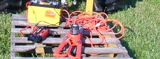

I have had gas chain saws for years.  But wanted to try  some thing a bit more green.
I have seen posts  on use an electric chain saw with an inverter.
As I was looking  around Home Depot  I came a cross this.

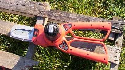

It's a Black and Decker Alligator.  It has a 4 inch bar and can cut up to 6 inch trees.
It opens up like hedge shears .   And only pull. 4.5 amps.  You can reach right thru a fence with it.  And the guards  keep things a bit safer . Cuts quick clean and quite
The battery  is a 100 amp hour deep cycle  and the inverter is a 750 watt Black an Decker I found at garage sale for 30 bucks  some time a go , Makes for a nice looking matched set  : )
To keep it charged I am using  the 45 watt solar kit from Harbor freight.
Works out pretty good  I run down long before  the battery an I to take a day or two to recharge :  )

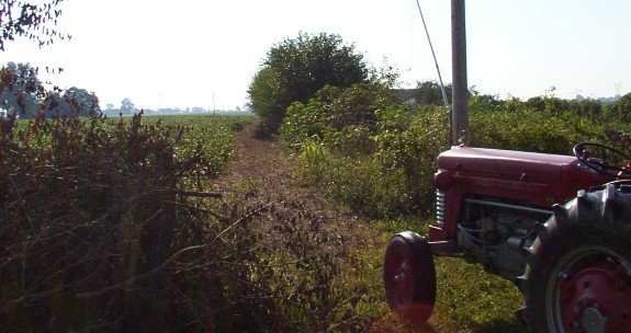

Here is part of a row I am clearing . And some of the brush all ready cleared   to the left.
All and all its working out great I find it a lot handier and safer than a standard   chain saw.
For working close to the fence .    And I don't miss the noise and fumes.
