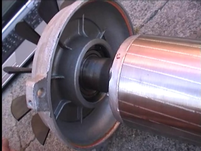

Hi all, I just thought I would just post a quick note on my motor. Things haven't really moved much I have been on holiday and just got back to work on it. Not much done today, just stripped it down and had a nosy around. Here are some pics:
Much bigger bearing housing than last time, the whole thing is massive, it looks to be very well built.
Theres the rotor, very big plenty of room for my mags, not sure what size im going with yet, I was thinking of 1/2inch dia by 1/4 discs. I've still got to work everything out yet.

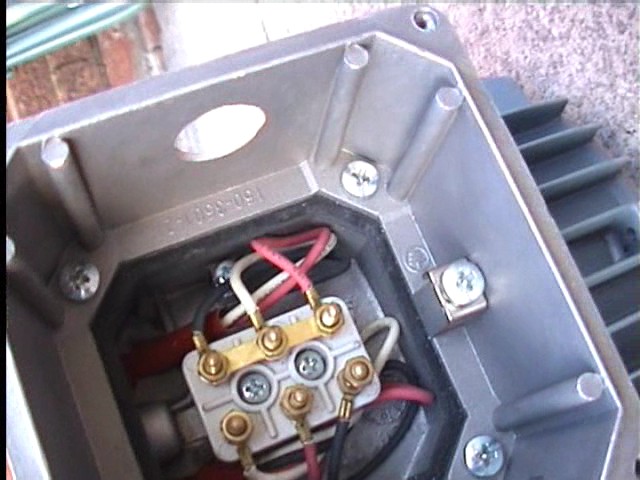

There's the wiring, not sure how to use this yet as my 3 phase knowledge is limited. How would I connect my rectifiers to that??

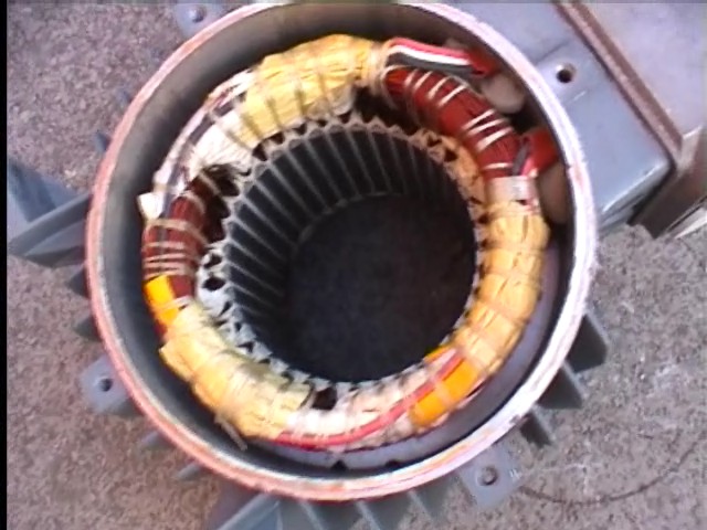

There's the main motor assembly, very well built. The stator has 36 slots on it.
So far the project looks promissing and should hopefully make a good genny. It bears a very strong resembalance to Zubbly's 'production run' motor, almost all of it seems exactly the same except the voltage/current ratings. His voltage is higher but my current is higher. Like Zubblys it is IP55 rated, so it should be water proof??
Zubbly if you read this could you give me some word on that motor you had, how well did it work out? I couldn't seem to find any follow up of that one.
I dont think this motor has even been used yet, or it has had very little use, everything seems new and clean. I think it was a great ebay bargain at £10.
This time everything is going to be done by the book. Going to use Zubbly's method of creating a cage for the mags. Mag wise I'm not sure how many rows yet but I'm going with multiple disc mags on 10 degree skew, am I correct in saying that one pole should fit inside one coil??. One thing I have noticed is that the shaft is a lot harder to turn than the last motor I had, but I think the bearings were badly worn on the last one.
Any thoughts/comments on how I should proceed would be great.

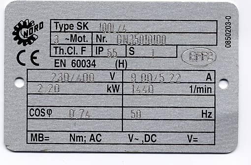

kitno455
  • Posts: 442
Re: 3hp Motor Conversion Update
« Reply #1 on: July 28, 2006, 02:04:07 PM »
post pic of nameplate, esp. rpms and volts/amps
allan
« Last Edit: July 28, 2006, 02:04:07 PM by kitno455 »
andyman5002
  • Posts: 71
« Reply #2 on: July 28, 2006, 02:11:59 PM »
Here is the nameplate
Andy
« Last Edit: July 28, 2006, 02:11:59 PM by andyman5002 »

output voltage of the original winding was 78.5 volt at 300 rpm star connection 1 circuit and 45 volt delta connection 1 circuit. the original winding was 230-460 volt, 1 and 2 circuit star. i added the 3 extra leads to make it 1 and 2 circuit star and delta.
right now you have 6 leads in your connection box that is connected for star. by switching those cross links across from each other, you will have delta connection.

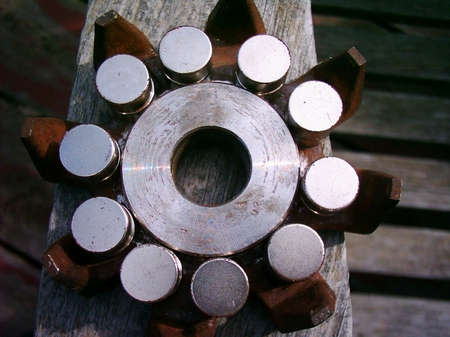

« Reply #11 on: July 29, 2006, 12:14:57 PM »
Andy,
I was facing this choice: 48 magnets 15x8mm; or 40 magnets 20x10mm (all round magnets).
I had calculated the total volume of the magnets, it appeared that with the 20x10 magnets I had much more volume. Don't remember the figures exactly, but according to Zubbly's rule, I'd get abt. 700W with the 15x8mm ones, and abt. 1100-1200W with the 20x10 ones. Don't take the exact power-figures as a fixed thing, it's what you end up with when using Zubbly's rule. The most important thing here is that with the bigger magnets (even though fewer of them) I had much more magnetic material in the rotor, thus more power. Over 60% improvement.
See if you can fit the 20x10 magnets in, how many, and how much magnetic volume you end up with.
My rotor is 89mm diameter; total length was 150mm, of which 120mm is actually available for magnetic material. (the stator is 120mm long too) Seems my stator & rotor are a tad longer than yours, but not much (8mm).
BTW, figuring this part out has so far been the hardest part of my conversion... Took a lot of sketching and calculating. AutoCAD is great for making quick sketches to see if it'll all fit.

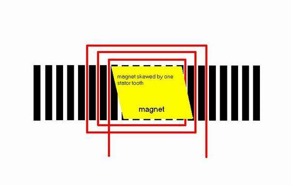

Motor conversions are not really my thing, but I have been thinking about the choice of magnet.
The ideal things are curved magnets and with them 1/4 " thick and an air gap of about 1mm (.040"), you should get a gap density of about 1T. As the teeth are a bit smaller than the slots in most cores you will have the teeth well saturated. The total gap density will still increase with the teeth saturated but the gain will be small for a large increase in magnet thickness and with very thick magnets you will not get much beyond 1.1T in the gap.
Assuming that other shape magnets can be got down to about 1mm air gap (which should be possible with multiple circular ones) then there seems little point in using magnets much more than 5/16 thick.
You loose a lot by having round magnets which have a poor stacking factor. I doubt that you can make this up much by using thicker magnets due to the tooth saturation.
I suspect the main aim should be to pack the magnets as effectively as possible. As long as you have a minimum thickness of about 5/16" I think you can consider area rather than volume as the determining factor in deciding the output.
With larger non curved magnets you will not be able to maintain the 1mm gap so there is a need for thicker magnets, but you gain by having the full surface area rather than a poor fraction with small circular magnets.
Zubbly's watts out per volume of magnet may be a reasonable guide but increasing volume by choosing magnets that are longer than necessary may be wasting magnet material.
There has been a lot of interest in motor conversions lately, but everyone talks about output. I would like to see figures of iron loss, how it is affected by flux density and also how output is affected by flux density. Is absolute output everything or do you achieve it at a larger cost in magnets and at the expense of lower low end efficiency.
Room for lots of decent research.
« Last Edit: July 29, 2006, 02:48:03 PM by Flux »

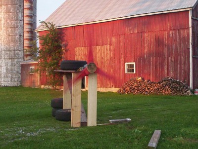

Andyman i think even Zubbly would say you need around 12ft to help break the initial cog.
 My mags are arc segs and the airgap was 1/16th.
 Notice i said was, they were just removed and finding a new home.All 16 of them plus 8 more on 3hp Sparky.
 Mag size aprx 1in x 1 1/2x 5/16 n48 naughty boys.
 You wouldnt have skew the stator if caging allthough its fun.
« Last Edit: July 29, 2006, 03:02:00 PM by vawtman »
« Reply #22 on: July 30, 2006, 01:34:19 AM »
The iron loss can't be calculated simply and we would never have the data on the core material if it could.
I was hoping that someone would actually measure it along with efficiency at various points. Perhaps it is not as easy as with a dual rotor and it would most likely be someone with a big lathe that would be able to do this.
Measuring torque is the fun bit and without a torquemeter coupling or mounting the stator on bearings as in a dynamometer, the simplest way would be to swing the shaft in a lathe, with tailstock support if needed and measure the torque reaction on the stator with a spring balance ( scale?).
It is the alternator input that needs matching to the blades. Once someone had done a curve the figures may be good enough to give others some idea of the input load from the output tests .
« Last Edit: July 30, 2006, 01:34:19 AM by Flux »

Not sure I understand. The skew depends on the number of slots and needs to be such that the displacement over the width of the rotor is the same as the pitch from one slot tooth to the next. ( 10 deg in rotary angle for a 36 slot core) . This will not be the angle of the magnets across the rotor.
For 3 phase the pole width is about 2/3 of a pole pitch, so your total magnet area will be about 2/3 of the circumference. ( magnets 2/3, gaps 1/3). Hope this makes sense.
If it means you get more magnets in then you can exceed 2/3 with the magnets. You make less use of the magnets if the poles are too wide but you gain up to the point where the thing is covered in magnets. I wouldn't go to extreme but if you gain a row of magnets by exceeding the 2/3 then go for it.
« Last Edit: July 30, 2006, 06:20:09 AM by Flux »

Andy,
Have you read the Zubbly pdf-file? You'll see that the skewed magnet (the extreme two points of it) overlap the legs of the coil a bit; I.e., an unskewed magnet should sit inside the coil, but when it's skewed, it can extend/overlap a bit:
http://www.otherpower.com/images/scimages/253/magnet_skewed_between_coil_legs.jpg
I tried a quick search for the link to the full (part 1, 2 & 3) Zubbly conversion pdf-file, but can't seem to find it now. Hope someone else can help, or search yourself. It's explained in detail there. BTW, Zubbly's document should definitely be in the FAQ!
"For 3 phase the pole width is about 2/3 of a pole pitch, so your total magnet area will be about 2/3 of the circumference. ( magnets 2/3, gaps 1/3). Hope this makes sense."
Flux, I didn't know that and it was something I had wondered about a few times. Some guys fill the rotor to the brim with magnets. I have made a few sketches, and if you do fill the rotor completely up, you will get voltage cancellation (thus, less output, or, as you put it, non-optimal use of the extra magnets). Seems that in my rotor, I have about 2/3 filled with magnets too. Didn't know of your rule, just had to figure it out myself & make some sketches. Glad you confirm.
« Last Edit: July 30, 2006, 06:54:55 AM by dinges »

Ok there is a lot of new information there. I read somewhere that it had to fit into a coil or something. Zubbly said 7 sator teeth, which that diagram shows, that was the diagram I was looking for i think. I thought the pole, clump of magnets, was just skewed on a 10 degree angle and that was that. But then I thought that this may cause cancellation because the pole will not be totally inside the coil, and will partly be in another one, but zubblys diagram seems to show this. Im going to have to re-read all of this for it sink in. I haven't read zubbly's PDF, and I agree it should be in the FAQ.
There is a lot for me to learn yet :)
So it seems I have gone just over this 2/3 rule with my 52mm pole widths. Im not clued up on the term pole pitch either :(. I think I will do some reading later on today. Also if the pole should not be skewed 10 degrees, how do you calculate the correct angle?
Im sure I'll get there in the end, its very interesting learning all of this and I would like to thank everyone for their help.
Thanks Andy

That 2/3-rule is a guideline; a few mm won't kill you. Besides, converting motors to gennies isn't a science, more like an art (at the moment, at least. Hopefully more hard data will turn up in the future).
Flux said it, but I'll say again: the 10deg skew does NOT project onto the rotor. See this discussion (lengthy!) for more info:
http://www.fieldlines.com/story/2006/6/15/19126/8190
http://www.fieldlines.com/story/2006/6/18/11456/6477
If you skew by one slot, you should be fine. IMO, it should be a tad less than one slot, but this is probably nitpicking. Put the rotor in the motor, put a mark on it at the left under one slot, at the other end under the next slot, and draw a straight line on the rotor. That's your skew angle, NOT the 10 deg (with 36 slots, as in your case).
The good thing is, you'll have to really mess up to end up with something that does NOT generate electricity. But the less cogg, the better, of course.
« Last Edit: July 30, 2006, 08:14:23 AM by dinges »

Thanks for the links they have cleared quite a lot up with my skewing concerns. I have done as you said and the skew angle seems to be 5 degrees. Which seems the same as the skew on the aluminium slots on the rotor. It turns out that I also measured the pole width incorrectly. I measured from the edge of the top the of the stator slot not the horizontal leg, so it works out to be 50mm now. I should still be able to use the same configuration of mags though.
