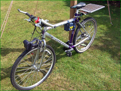

This project was a way of using the ongoing power I am producing both from my 100w Ametek wind generator and 5w solar panel.
The basis of the project was a second hand Sinclair Zeta II bought on eBay for £21 ($40) - originally manufactured from 1997 - 2000, but no longer avilable.It uses a 12v 7ah Yuasa sla battery and the motors max power rating is 168 watts - coupled with a rear mounted 12v 5w solar panel with blocking diode and 1 amp fuse fitted.
I had the bike and solar panel already, the additional total cost to make was £30($50).
i.e about 6 gallons of fuel (petrol) in U.K (absolute madness).
It works well for my daily 2 mile commute to work, although the motor is under powered and is more use as pedaling assistance.
However it requires No licence, tax or insurance(in the UK) + No fuel costs or parking fees or queuing in traffic!
More info and hi-res pictures on my website.
http://www.gotwind.org/solar_electric_bicycle_project.htm
Ben.

Looks quite good. Obviously it wont last long on the small battery but it could be upgraded. By the way, you said "my 100 wind generators" instead of "my 100w wind generator's" lol!

You would see better results with a hub motor ... I believe they sell for $130.00 or so depending on type ...

I agree powerbuoy hub motors are the best but V.expensive.-
Best price I can find for a hub motor kit is £339.99 ($649.00).
I tried to achieve solar propulsion on a reasonable budget.

You could try changing the knobblies for some road tyres. That might improve it a bit.
Can the Zeta be run downhill to charge the battery? I have a long downhill to the station in the morning but an inevitable long uphill in the evening. It would be nice to have a generator braking down and then motor assisting back up.
I could aford a Zeta but not a hub.

Ben
 I have the Zeta111. 200 watt motor,7.5ah battery.
It has a 6.5 mile range at 10 mph on level ground.
 I pull a small trailer all the time.Once a month
i go to town shopping [50 mile's round trip].
 The Zeta get's used on the way home to help climb the hill's.It does real well the last hill on the way home is 1/2 mile from the house,it is a
22degree grade 1/4 mile long.Without help i would never be able to climb it,with the Zeta not a problem.
 OH on the newer version the motor and battery
are contained in the same housing and hang's off of the handelbars,easy to remove when not needed.
I wouldn't take anything in the world for mine.
LOVE IT
Elvin
PS a slick front tire works better[not as much belt slip]

Road tires roll MUCH easier than mountain-bike tires.
If the drive system needs knobby tires on the front, I would still change the rear tire.

Ben;
NICE Bike!
  Try looking out for some of the newer I energy "D" cell sized battery packs. They are now available in 12Vdc 10Ah packs that weigh 1/3 what the SLA does, price isn't too bad either.
You'll be able easily to use them down to 70% of total charge which will have them lasting much much longer then the SLA which shouldn't be used much further then 20%.
If you decide to put lights on it, go for LEDs they now a days are as bright as the normal ones and draw so much less power.
