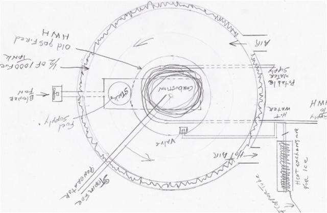

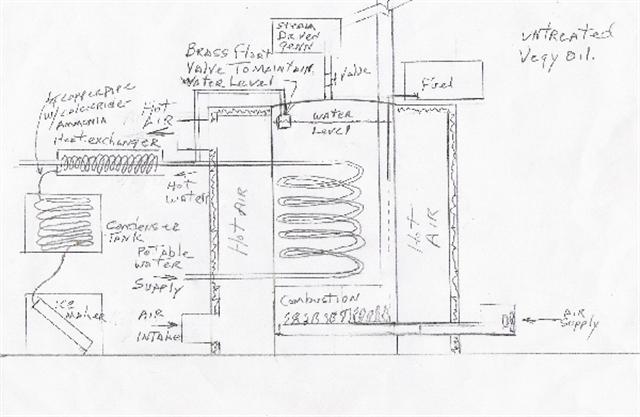

thanks john, this unit will run 24/7 except for maintance and the more heat, the better to produce the different products that it will be making. each of the functions will have several factors regulating their output and isolation from the boiler unit. after the rate of burn is established, no other control will be needed. i want this unit to be as close to self substaining as i can it make for ease of operation, with sensors, relay activated valves and safety valves in place along with a large fuel tank, it should run with little help from me. i can design (with your help) and build the machanical end of this system but will be completely lost when it comes to the main control panel and the sub panels that it will take to keep it safe and the unit running smoothly. my hope is that when i get to the different stages of operation the good people here will continue to guide me through it. IF IT WORKS AS PLANNED the unit could be the basic power sourse of any off grid living simply by using or replacing the boiler as the power sourse. i have no thoughts of going off grid and have solar and wind production, but thought this unit would help others that are thanking of doing so. i'm having fun pepa.

thanks Ron for your comment, this is something new to me so i try to follow what other people have found that works. i found an article on mother earth that someone had pointed me to and followed it as close as i could, in the design of the burner pan. his pan was machined out of a block fo aluminun and had a funnel shaped burner to cut down on residue buildup. the rounded end of an old air tank gave me a close copy, only larger. i have been hunting a large gas fired hwh without luck and started looking for something else that would work. the drip system he used was the same as the old army field kitchen heaters except they used gas. after the four hour burn was over and the pan cooled down, there was no residue left in the pan except a couple of little bumps that were probably the ash from the piece of paper that i used to start the fire. i still need the large tank for a heat exchange boiler, will keep posting as i go. pepa
