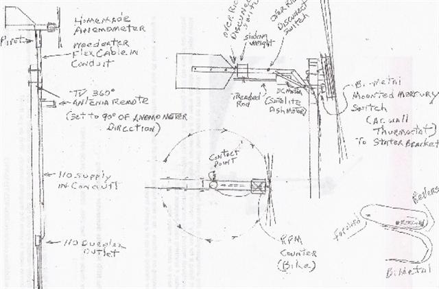

Hi folks, do to some medical problems, I have not been able to do any shop work for a while and could only think about what is needed to be done. Very boring work when you don't have anything to think with. Like most of the people on this site, I try to keep up with current post and the problems that are posted along with the good work that is done. I would like for you to look at the project that I came up with and give me your take on the merits of it working or not. Not having the electronic abilities that I would like, I have had to use materials that I have some experience with and that I thought would do the job. I know that there are better ways, but if it works! Item description - automatic furling or yaw. #1 system sets 99% of the time doing nothing until needed. #2 thermostat activates electric circuit to motor when stator starts to overheat #3 motor moves sliding weight on tail boom to lighten tail and cause machine to yaw (very little movement is needed). Weight is stopped by a kill switch. #4 tail furls to yaw windmill until thermostat cools down. Circuit is inactive, tail stays light, circuit needs to be reset... #5 anemometer keeps track of wind direction. #6 thermostat cools and activate a new circuit to move the weight back to its original position. Kill switch stops motor in original position. #7
Circuit is ready for next round of overheating. any help will be welcome thanks, pepa

First though is about using glass-tube reed switches for limit switches, they make some w/ decent current handling and also double-pole... only gotcha would be possible false contact-make if switch specifications do not reject falses when vibrations hit its known resonances...
Simple Tstat would not have parasitic monitoring losses, but on further thought the metals of Tstat left in stator could be subject to heating and losses from flux eddy flows. Might be a valid application for a heat pipe made from glass or plastic.
If active monitoring is wanted how about an IR sensor that reads target temperature through a hole bored into stator and so keeps conductive materials out of rotor footprint while being weather resistant...

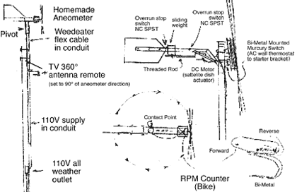

We all know yo're a busy man, but please oh please make your sketches on unused paper! HA, that's funny.
I took the liberty of dressing up the sketch and setting the type. I have the tiff file I made in photoshop if you want it. If I have something in the text wrong It's cause the background messes with old tired eyes. So I will monitor your comments if I've messed anything up.
I'm not sure I understand, do you plan on using old house thermostats to read the stator temperature?
What is the lower right thing? Is that a bi-directional switch of some kind like a car window switch?
Anyway, if you want this in a tiff hirez file can do. Email me @ above.

hi DanG, thanks for the comment, i was not thinking about the vibration. the bi=metal could be used as part of the contact without using the mercury contacts, because the heat of the stator will make the points move a certain way each time it is heated and is very accurate. some bench test will have to be made to determine the location of switch on stator or bracket. could you give me more details on the valid application for a heat pipe. thanks pepa. Roger. email sent thanks

ok, so let me chime in with an opportunity to spend a little money and eliminate a potential headache:
have a look at the datasheet at:
http://www.airpax.net/site/utilities/eliterature/pdfs/Airpax_TSP_5003_0805.pdf
and see if that doesn't neatly solve the temperature monitoring problem. . . of course, $20 or so per switch could be a little off-putting for those who have a tight budget.
I've used these to protect BIG (~100kw continuous input, watercooled) electromagnets.  Granted, my application is DC . . .  but I've also seen these switches in all manner of  power supplies, motor drives, MOTORS,  and the like, serving as overtemperature interlocks.  they work and they don't take much space.  they're not inherently  watertight, so I'd tape mine up (to keep resin out) and submerge it in the stator casting. they're rated pretty generously, unlike the contacts in a thermostat. . . .
because they're small (circa 1cm or 3/8" diameter on the sense element), the potential for eddy current heating and other troubles is down from what a re-purposed home thermostat might experience.
Just a thought.
(I'm actually planning to scatter a couple of integrated circuit temp sensors in my castings. . . but there's a lot more that has to happen in the feedback path between sensor and mill if you go that route. I might put one of these in as a failsafe. . . . one of these days i'm gonna have to leave off planning and start building. . . .)
-Dan

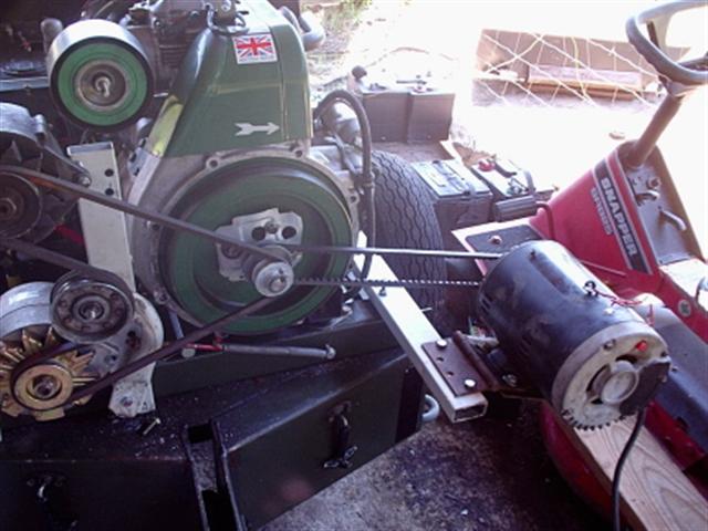

Hi Dan, the part works great, does this switch work both ways or do I need two switches to activate the two circuits, #1 hi temp #2 low temps. I could not see how it would work both ways from the speck sheet( don't know what I am looking at) I need to activate one circuit at the time from the same electrical supply line. Any help would be great thanks,  pepa
The petter with the new shaft extension

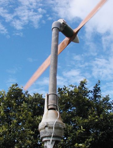

SamoaPower
  • Posts: 417
Re: motorized furling
« Reply #18 on: September 28, 2006, 11:34:04 PM »
harrie and pepa,
This is a quick throw-together test set-up for experimenting with controlled yaw. See:
http://www.fieldlines.com/story/2006/6/26/12214/2424
I think I deserve a KISS merit badge for this one, it took all of 20 minutes to put together using an Ametek. The yaw motor is a ham antenna rotator.
With controlled yaw, no tail feathers are needed and you have free choice of upwind or downwind. I prefer downwind for blade proximity issues.
I'm convinced enough of the merits of controlled yaw that I'm committed to using it on the 16 footer under construction.
« Last Edit: September 28, 2006, 11:34:04 PM by SamoaPower »

 Samoa, that was an interesting post. How well does it track the wind? Can it move with the wind, or does it all have to be controled by the gear motor?
« Last Edit: September 29, 2006, 06:26:13 PM by jmk »

jmk,
The idea with controlled yaw is that you don't want it to flail around by the wind directly. It only turns by the rotator. The rotator controller receives wind direction data from the site anemometer/wind vane. After averaging, it turns the rotator to the average wind direction. This way, turbulent gusts are averaged out and the seeking is a lot more gentle.
I've found very little difference in output power with 30 degree wind offsets so, quick wind direction tracking is not necessary or desirable.
