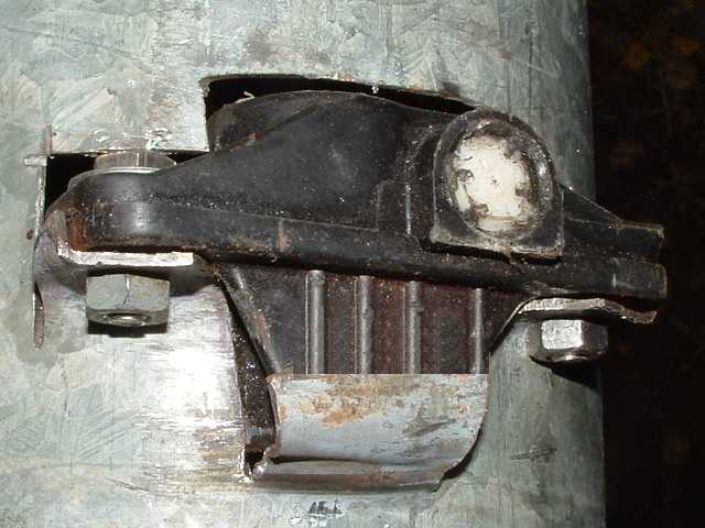

This first picture is of the worm pinion mounted on the tower pipe.
I first cut the opening from cardboard and then when it fit well I cut the metal.

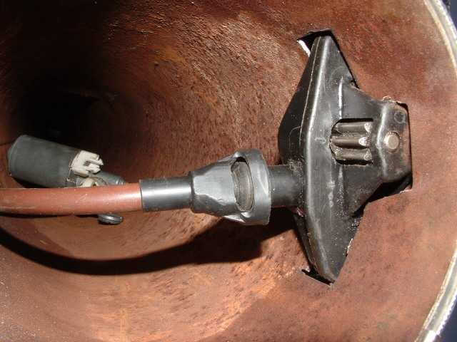

An inside view shows the positioning of the pinion and the worm motor connected by the flex cable.
The worm motor fits nicely inside the tower and there is a slow curve in the flex cable.

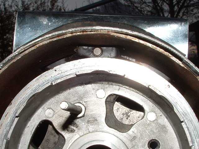

The yaw gear is held in place to verify the spacing to the pinion. My measurements worked out well.

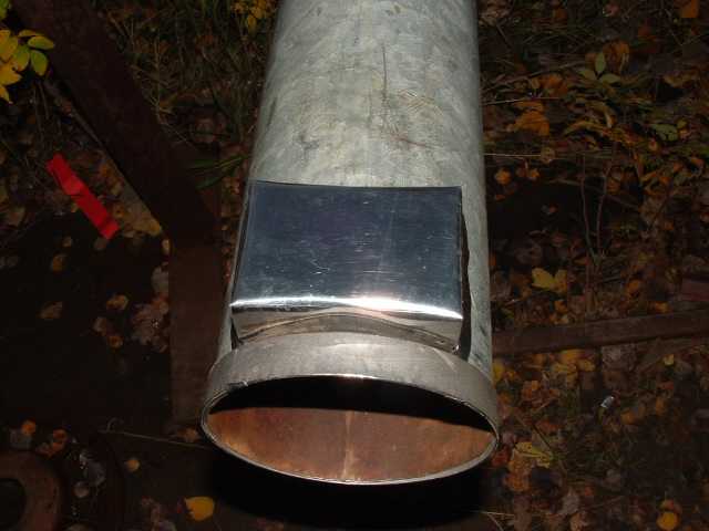

Pictured in the last frame is the stainless steel cover to protect the protruding pinion.

I envy your mechanical skills, facilities and execution. When I questioned the rotational speed, I didn't realize that the pinion was also worm drive. I hope it can stand up to the required braking torque. What size machine do you plan on using with this?
I'm certainly glad to see someone, besides myself, that recognizes the advantages of controlled yaw and are willing to pursue it. You will save a whole bunch of bucks over what I'm doing for my 16' machine with a commercial rotator, a Yaesu G-2800SDX, which has 180 Ft-Lb of rotational torque and 1800 Ft-Lb of braking torque. As you can see, braking torque is probably more significant.

SamoaPower, I was thinking also along the lines of yaw torque. The yaw gear came from a small motor bike clutch. It is rubber mounted to the aluminum body. I mounted it on a vise and can get a twist of 5 degrees. Grease on the bronze ring should dampen the acceleration/ deceleration. My tests gave me 4 rpm at 12v. Also the pinions and worms are well made. Two of them have to accelerate/decelerate a bench seat and 3 hefty men.
