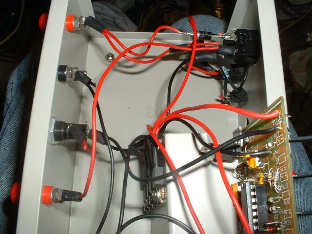

Bought one of the HF solar panel deals yesterday--the 3 panel one.
Hooked it up and played a bit with it and shut it down and unhooked it completely from the batteries (pair of Trojan 105's) and solar panels at dusk.
This morning it wouldn't charge, so being the inquisitive type--and really curious--I took it apart.
IT"S NOT exactly a charge "controller". It's a dump load controller based on battery volts only.
It also has a "cute" circuit that I think is supposed to short the panels out (which is where my trouble seems to be while it's "supposed" to be charging).
Now, if it's turned on--that shorting gizmo is supposed to be OFF--it ain't.
And if panel voltage is on, and the battery is unconnected (or fully charged--I think?) and there's no load on the "LOAD" terminals--the "short" is supposed to be there--it IS--no matter if and how ya connect or unconnect stuff...or reguardless of battery voltage.
It's a cheap azzed thing--don't trust your batteries or anything to it!

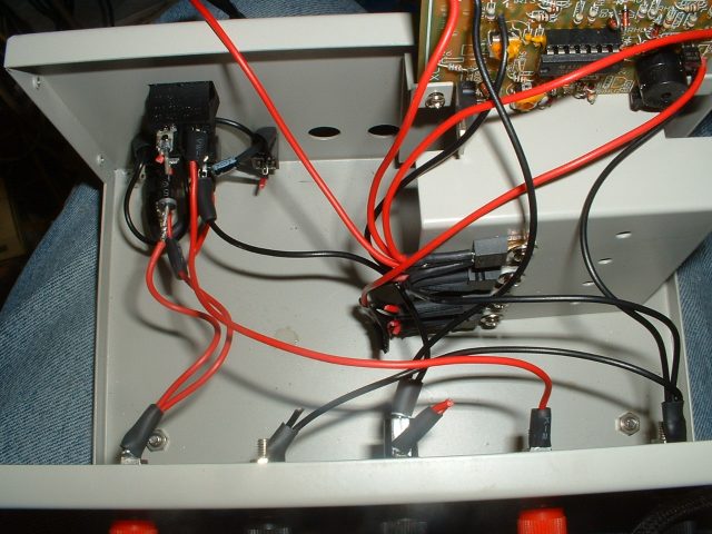

Look at the following pictures---it HAS a blocking diode in it..
See the straight connection from the panel terminal to the battery terminal on the negative black wire?
See the red panel + wire going to the switch and if the switch is turned on, it goes through the diode and to the battery positive--that's a 3 or 5 amp switch max--that's a 1N5402 "blocking" diode, rated 3 amps MAX (I saw 3 plus a tad over amps yesterday at mid-day). Don't parallel two sets of panels through one controller!
And yeah--I cut it all to $%%$## on the wiring, took all the little 9v and 6v (78XX regulators) out--took out the shorting FET--took out the load FET from the circuit completely.
This is just a pilot/trial setup and I'm ordering a MUCH better controller like right now!
It "would" work as specified IF you had a load stuck into the little phone plugs that would help keep the voltage down going to the batteries--but if it's sized to small--your batteries will cook.
Just a small warning on these --I suppose they are the latest versions out ??--so-called controllers.
Old adage of "ya get what ya pay for" holds true.
But the FET's are nice and large 45 amps or so each, and there's a nice chassis and indicating leds just waiting--I might just use it and put another PWM circuit onboard and actually make it into something useful afterall.

the "literature" says when the level of the battery falls below 11 volts the charger/controller automatically shuts off the power output (output/load plugins) for over discharge protection.
Over charge is disconnect at 14.5 volts. The battery is not disconnected, the panels are shorted, and as far as I can tell with a short (punny--no?) look, or even a "long" look, the controller boards dc voltage is shorted at the same time as well--nice design. This thing could oscillate itself to death--off--on--off--on, etc at a rapid rate, and must have.
The circuit board is missing a few components here and there according to the layout silkscreen on the top. Seems to be a rehash of an old board....maybe to make it cheaper.
Didn't even figure on using it for any "controller" for the panels. It was just a temporary hookup for a day or two. New toy to play with, etc..you know.
Only point I wanted to make was that it really doesn't control much--just shuts off the juice with a shorting FET across the panel lines, and manages to cut it's own throat at the same time.
This one really "shorted" the panel lines--they are (were) staying that way.
Haven't tested the FET's yet..but they are rated nicely.
They are MTP50N06 type FET's. Both "should" be ok, they're rated high enough.
Did test the 3 amp blocking diode--it's ok, very surprising since it's just a 3 amp diode. 1N5402 type.
I need a dump load controller type anyway, well bigger then 1 1/2 amp load--that's the fuse size to protect the 780X voltage regulators for the "output" plugs.
I'll look at the SS-10, or maybe a bit bigger. Or just rebuild this chassis/box the right way (even easier then waiting a few days for the mail and less $$ since I have a ton of the stuff to do it with already). I'm already waiting for my "kill-a-watt" meter rather impatiently--it's been a whole 2 days now since I ordered it..hi--hi.
Bruce S---yeah it squealed, until it just quit working and then it "innnqked"--just one time each switch on--that's the sound it made when I turned it on, disconnected the battery or anything, and it managed to keep the shorting FET on with 2.75 volts from the panels and short out it's own dc voltage too--nice.
I pretty well gutted the wiring and circuit board from the "controller", but left the straight through connection for panel to battery--it ain't going to overcharge much of anything at 3 amps I hook to it.
But for the price of the panels and a couple of CFL's--ain't so bad a price even without much of a "controller" thrown in.
