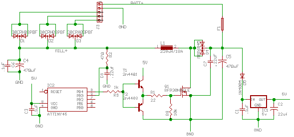

« Reply #34 on: October 15, 2006, 08:44:06 AM »
Here's the corrected low pass filter -
I've also swapped the pins of the analog in and PWM out signals. The Tiny45 has over 30 port functions that can be assigned to its six pins but the assignment in the original schematic wasn't a valid combination; now it should work.
- Ed.

« Reply #35 on: October 15, 2006, 10:49:55 AM »
I guess my understanding of MPPT with the booster circuit is stuck - this is all more or less a question:
If the FET is held in the off state, the prop will spin as fast as the wind will turn it. The converter and battery will cause no load on the alternator/prop because the volts are too low for current to flow into the battery.
In what I call zero duty cycle, the FET is turned off and the mill would be free-wheeling below battery cut in voltage.
When the duty cycle is increase up from zero, here's a range where the circuit may be boosting but output voltage is still too low to conduct current to the battery. Except for some inefficiency in the boost circuit, there's still no load on the alternator and the blade doesn't change speed (much) and the input voltage doesn't change (much). (Is this correct or is there something about the battery that will allow it to use even a very small amount of inductor-stored energy? If so, then the alternator is loaded, the blade slows down and we're into the next case...)
Increasing the duty cycle allows the inductor to store more energy and eventually a point is reached where the voltage achieved is just high enough for current to flow to the battery. This point isn't stable because now there is a load on the alternator and it will slow the mill down some and the input voltage will drop and the duty cycle will have to be increase to get the output voltage up a little bit more so that current will continue to flow into the battery.
If we were just sweeping the PWM from zero on up, we'd go from no load on the alternator and no power and eventually get to the point where the blade has slowed to to it's maximum power point (at a slower blade RMP and lower voltage then the free-wheeling, unloaded alternator.)
Here's where I get really confused:
What happens if we increase the duty cycle a little bit more from that point? I realize that if the duty cycle goes to 100%, then the alternator is shorted and mill stalls/stops. But what happens if th duty cycle is just increased a little? The inductor takes more of a charge but it can't develop more volts to the battery. Likewise, it can't deliver more amps to the battery because that would be more power and, by definition, this case is where we increased the duty cycle past the maximum power point. Or does it briefly deliver more power and slow the blade down to the point where it delivers less power... So, where does the the extra inductor energy go? Heat? To slow down the blade. Or, if it can't discharge, does it continue to draw power from the alternator on the next cycle of the PWM clock? (If not, that would imply that there might be a maximum power "plateau" instead of "point.")
Thank you,
- Ed.
« Last Edit: October 15, 2006, 10:49:55 AM by elt »

Re: Building a voltage booster
« Reply #37 on: October 15, 2006, 12:58:03 PM »
I think you have to look at this as energy transfer.
With no gate pulse, you are right, there is no conduction below main bridge cut in.
If you gate the mosfet you store energy in the inductor. When you turn the fet off the energy has to go somewhere. There will be a large voltage spike and during the interval when this spike is above battery volts current will flow into the battery.
With small fet conduction angles, the energy will be small and only a momentary current spike will flow. With about 50% fet drive pwm the energy stored will be such that with a 2;1 boost the thing behaves more or less as a stiff 2;1 voltage converter and energy will be transfered during the whole of the fet off period.
The thing will still boost some energy from considerably lower than half battery volts but conduction will be for a shorter period than the fet off period.
The prop is also an energy source. If the pwm is too short the prop will have to run fast to deliver its energy to the battery. If the pwm is too long the prop will run slow.
The maximum energy is transfered when the prop runs at a speed that keeps it on the peak of its power curve for that wind speed.
The system is stable at any point, the available energy from the prop will be transfered. The prop speed will settle to a point where its available energy is transfered. It is the same as a current limited circuit, power flow will sort itself out and the supply voltage will adjust to suit.
Even if the voltage converter had a precisely defined ratio it would still be stable because of the series characteristic of the prop's power capability.
You must limit the gate drive, it must never go to 100% ( limit it to 60% should do)
At 50% the alternator - converter combination will be too stiff and the prop will stall just beyond cut in.
The analog control works by feeding back a current signal that phases back the pwm.
A high gain loop would result in constant current output and the prop would run away.
As you lower the gain the current rises, the lower the gain the higher it rises until at zero gain you are back at fixed pulse width and stall.
By choosing a suitable gain you let the prop speed rise at a rate close to that needed to track maximum power.
I have no idea how you do this by digital means, you may be able to implement a variable gain or you may have to attack things from a completely different direction but the end result must be the same. You need a pwm for each wind speed, chosen to keep the prop output a maximum at that wind speed.
« Last Edit: October 15, 2006, 12:58:03 PM by Flux »
« Reply #41 on: October 16, 2006, 08:09:01 AM »
Thanks for your comments Dave.
I basically follow your idea of how to implement gain by multiplying by a factor.
My problem is mainly that I was brought up with amplidynes and thyratrons. I have never fully got to grips with basic logic and I am absolutely hopeless at maths, so anything that needs that type of thought is difficult.
You are right that this can be done from speed, that is the first way I did it, and I also suggested to Elt that it was a way. I did not find it as easy as current, but I have simplified many things from that first attempt.
I assume that a processor can calculate speed from the interval between voltage crossings. That would seem more accurate and less bothered by noise than using input volts, which is related to speed, but a bit indirectly.
To you it is probably easier to mess with software than change a few wires, but not the case for me. Just a way in which modern ideas move on.
The rest of the world seems to be hung up on how to control this thing, my problem has been in adapting basic converter ideas developed for a few watt supplies to something that can handle serious power.
I only proposed this boost converter as a simple solution and one that I have used for years. The Buck converter option is a far more elegant solution that reduces the troubles of volt drop in diodes and cables. It is a far more challenging problem when all the machine output has to pass through the converter rather than a few hundred watts in low wind.
I am sure the solution comes closer every day and when it is done reliably we shall not have to worry about fried stators and we shall see outputs several times what is safely possible with resistance matching.
