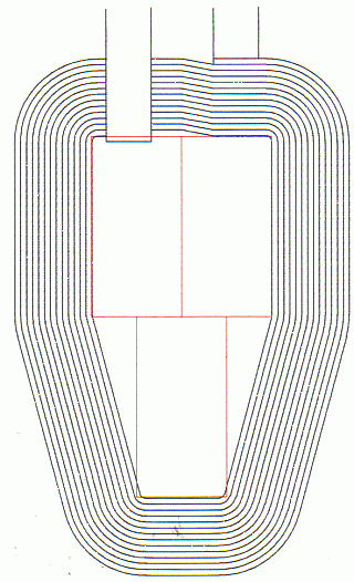

The coils for this 12 volt system have only 13 turns. This was calculated to give a cut-in  speed of 100 rpm which is a 12 mph wind speed for my 16' air rotor. Anything between 10-14 mph should be fine since the energy peak for this site is 16 mph.
I decided to use the commonly available 2x1x.5" N42 magnets to keep costs down. Each of the 16 magnet poles on each rotor consists of three of these arranged in a `T' formation, which approximates a wedge shape. A total of 96 magnets and 96 in^3 are used. The magnet surface area for each pole is 6 in^2. The magnet 0.5" thickness dictates a coil thickness of the same amount to allow a reasonable air gap of 0.75". Nothing need be added for casting. The size of the composite magnet `T' dictates the hole size of the coil.
Given the rough dimensions of the coil, it now remains to select the wire size and winding format. Since transfer of heat from the interior of the coil to the outside surface is by conduction, it is obvious that a very high copper density is desirable, with minimal dead air space between adjacent wires and layers. Dead air is a very poor thermal conductor. To this end, square wire is indicated and is used here and since it has about 20% more copper for a given size, it also has 20% lower resistance. Square wire isn't perfect however, having radii on the corners. It's also a bit expensive.
Crossover of wire in the winding process also introduces an air space, so it was decided to use only one turn per layer since few turns are needed. This produces a spiral coil with no helical component, so no crossovers. To reduce eddy current potential, multiple parallel wires are indicated - the in-hand (so called ) winding. Seven strands of #14 square wire results in a coil thickness of 0.48" satisfying that requirement.
Allowing for insulation thickness, corner radius and a bonding agent results in a copper density of 92%. Compare this to the 60-70% obtained by many. Heat transfer should be significantly improved.
The stator design calls for the coils to also serve as structural elements. This calls for not only high density, but that the coils are well bonded together to approximate a solid block of copper. A few epoxy types were tested and JB Weld provided the best bond to the wire insulation. It also has iron powder filler that should improve its thermal conductance. So, not only does it bond the coil, it also fills in the dead air spaces to improve heat transfer.

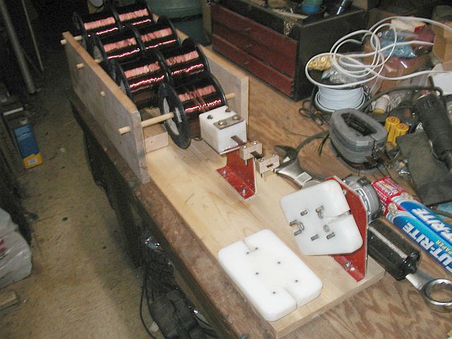

The Winding Jig

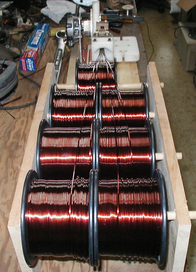

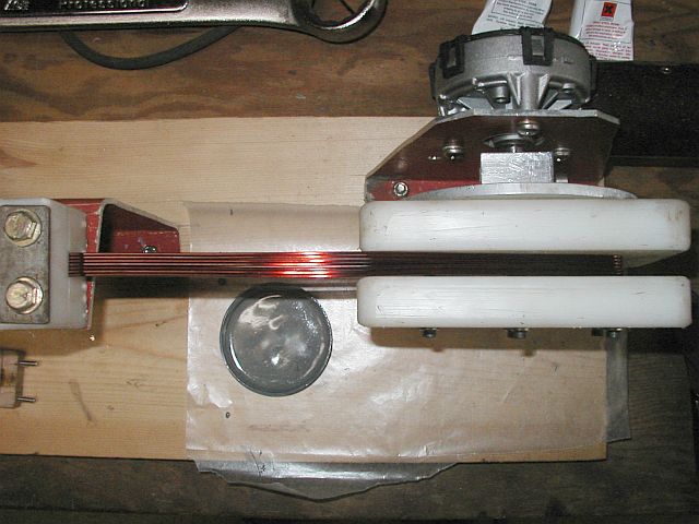

To obtain uniformity and because winding 7x #14 seemed a bit daunting, a winding fixture was needed. Here's what I came up with. It's about 3' long by 9" wide.
You're looking at over $600 worth of #14 square but not all will be used on this one machine.
I originally planned to power and automate the winding process but I grossly underestimated the necessary winding tension needed for 7x #14. It became clear on the first test that the 120 watt DC motor, although well geared down, wasn't up to the task of supplying the necessary torque. So, I had to resort to the Armstrong method shown here. Believe me, the long handle is necessary.

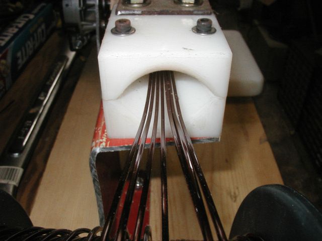

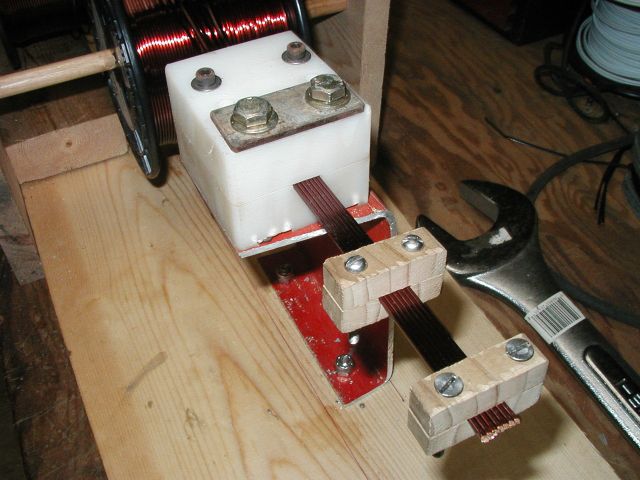

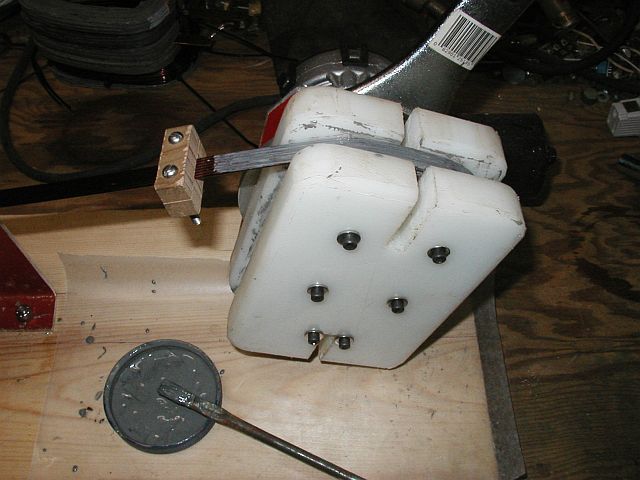

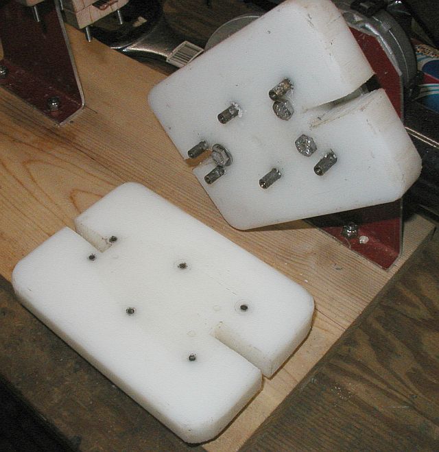

This is the input end of the collimator/tensioner. It's made from two pieces of 0.94" HDPE.

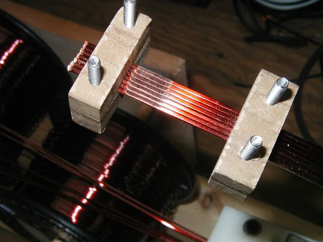

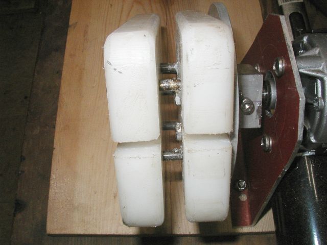

This is the output end of the tensioner. Tension is adjusted by the two large bolts. Also shown are two notched clamps to hold the wire while preparing the end.

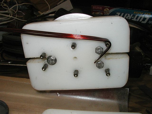

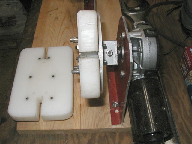

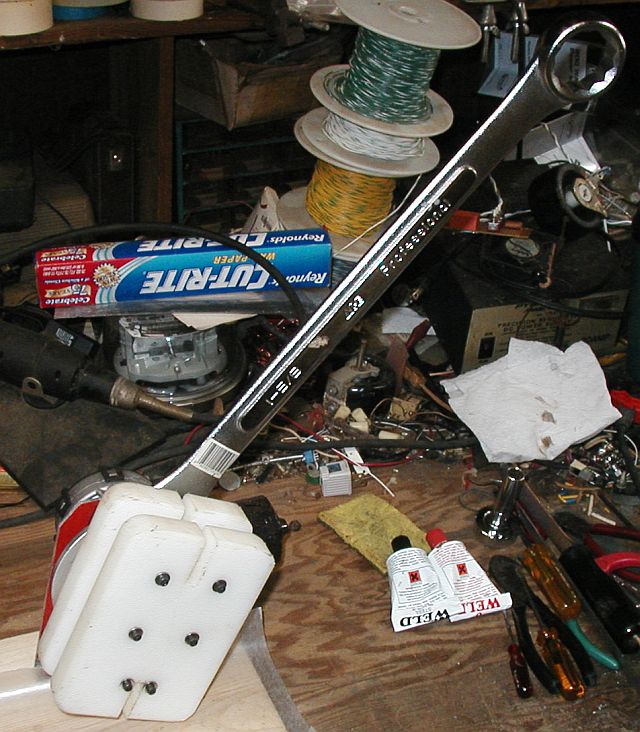

This is the coil mandrel also made from HDPE. The coil corner posts are 0.25" brass threaded standoffs. They are coated with melted candle wax to prevent epoxy from sticking. The fixed half is bolted to an aluminum faceplate, which is on the gearbox shaft. Even though found unsuitable, the motor/gearbox was used unpowered to provide braking torque. Who says a worm drive won't rotate backwards? The slots allow fastening cable ties while assembled if necessary.

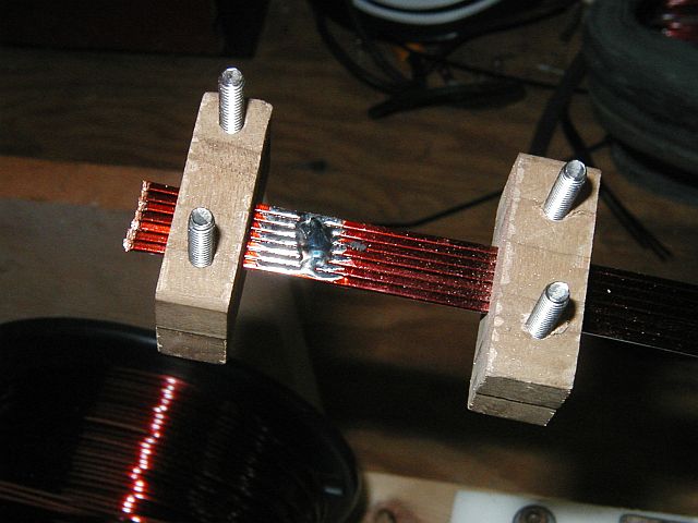

The start end is first prepared by grinding  off insulation with a Dremel tool. It's much easier to prepare this solder joint at this point rather than after completing the coil since it's on the inside.
The wire is then tinned and a solder bridge left to keep things together. The wire will then be cut on the left side of the solder area.
The prepared end is bent around the start corner post. It's bent farther than it will end up so that it can hold position under the necessary winding torque. The removable half of the mandrel will now be installed.

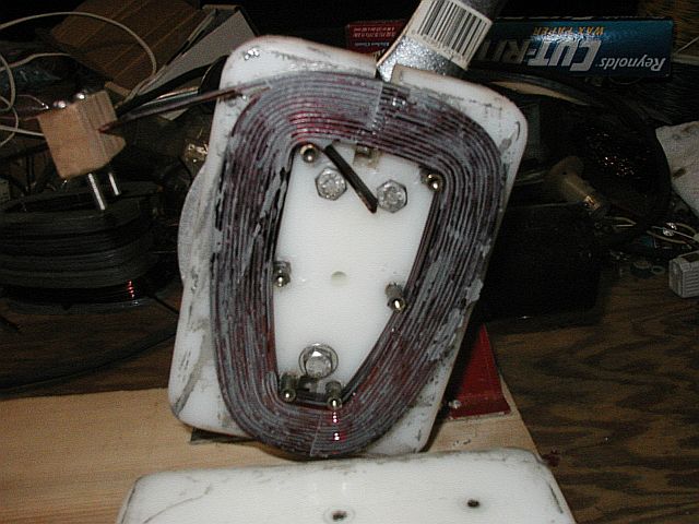

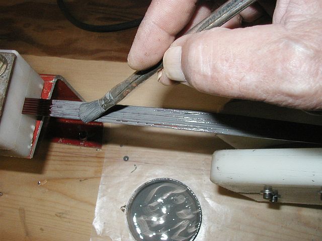

We're now ready to get some exercise. The epoxy is mixed, adding a little acetone to thin it for easier application. From here on, the major problem is maintaining adequate and equal tension on the wire. Frequent back-tensioning of individual spools is necessary to equalize them. If  this was to be a production system, I'd certainly find a better way. I have to do only 12.
Epoxy is brushed on as we go. It adds substantially to the time since only 6" can be applied at a time. The weight of the handle/wrench plus the gearbox keep it tensioned during the process.
Turns are counted through the mandrel slots. This is the end point. A clamp is installed and the tensioner is tightened right down. Again, the handle weight maintains tension. It's left in this position for 24 hours.

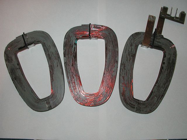

The ready to pop off coil. I'm glad that pretty doesn't count for much. As a precaution, a cable tie will be put around the start and finish (it comes off later).
The Results
I now have a coil with a near-rectangular cross-section and as dense as I know how to make it. It has a measured resistance of 4.6 milliohms and a measured inductance of 17.5 uH. It's outside dimensions are 4"x6".
The one on the right has connection links of 0.5"x0.04" copper. The gadget at the upper right is a calibrated shunt for measurement purposes.

your jig for aligning the wires and keeping tention on them reminds me of many of the setups i used to make for xformer winding and coils that needed to be made perfectly layered.
just a tip on the main tensioner: if you use a heavy coil spring over each of the 2 bolts, you can adjust the tention and leave it. the tention setting will last a very long time without having to constantly tighten after a little wear in the tention block.

A number of improvements to the jig came to mind along the way, but since this was basically a one-shot device, I didn't persue them. I found that tension needed to be adjusted during the wind because of changing winding radius.
Yes, the G-10 FRP plate is really fantastic, albeit expensive ($25/sq ft in 1/4"). It's been around a long time, at least 40 years. I recall using some outdoors for 15 years and was still fine. Don't know why we don't see more used in RE. I think it will make an excellent stator plate with cut-outs for the coils.

What I like about HDPE is that I can work it with my woodworking tools, not having a machine shop. Table saw, router etc.
JB even recommends thinning with acetone.
I don't expect a problem with the magnets since they will be retained by a 0.25" thick aluminum disk with cut-outs shaped to the magnet layout. There may be a bit of an issue with getting them in the cut-outs in the first place, but once there, I don't think they will go anywhere.

Nice work--the coils look nice (pretty strong looking to me and ya can't see that from the ground when installed--ya have to know it's there from the start!).
Might want to chunk a couple of them in the oven set to 180-200F or so for an hour or two to see what 'equalization" may occur when they heat up later, and it wouldn't hurt to do that anyway because of the stiffness of the wire. Seven in hand #14 square musta been a bear to wrap.
Then test the heck out of them setup with the rotors/mags.
Just watch the bending radius for square wire(s), it's not quite as sharp as round can be.

Re: A Different Alternator - Part 2
« Reply #17 on: October 24, 2006, 01:46:20 PM »

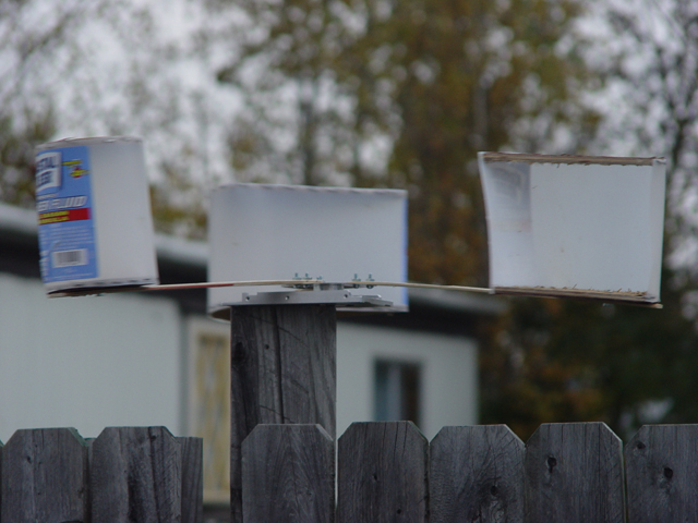

Man, you put my coil winder to shame....
But our machines share all the same elements.  I tensioned the wire like yours, two plates clamped together, but I used a piece of fabric to reduce friction.  Tension on the spool was maintained by stacking washers on the spool shaft and then adding a compression spring.  The spring kept all parts in contact with each other, and by tightening a bolt I could tighten the spool.  Nothing would grab or loosen because the washers maintained constant friction as they turn.
Hmmm, never did upload my pictures.  Hope you see what I mean anyway.
A wiper motor would have worked better for my 18 gauge wire.  Sorry it didn't work for you.
« Last Edit: October 24, 2006, 01:46:20 PM by SparWeb »

« Reply #18 on: October 24, 2006, 05:57:29 PM »
Thanks for the comments Steve.
I'm not sure that tensioning the spools is the way to go because as the wire is used and the radius on the spool changes, the tension will change.
I really did underestimate the necessary tension for 7x #14 square. I looked it up, after the fact, and found that 58lb was recommended for single strand. This explains why I need a two foot handle. Wow, 406lb!
I think if I was to do it again, I would use individual adjustable friction tensioners prior to the collimator to equalize the strand tension and the collective device to set the final tension.
Dense coils do come at a price.
« Last Edit: October 24, 2006, 05:57:29 PM by SamoaPower »
« Reply #19 on: October 25, 2006, 01:17:30 PM »
Good points, but I tensioned the spool not to put tension on the coil I was winding, but to prevent the wire from "springing" off a loose spool and becoming a mess.  You could put a small compression spring on the dowels through your spools and some washers to achieve the same effect.  The frction on the spool doesn't have to be significant compared to the coil tension.
For coil tension, maybe a pair of hard rubber rollers with a brake would do?  Rubber rollers can be liberated from old photocopiers.
« Last Edit: October 25, 2006, 01:17:30 PM by SparWeb »
