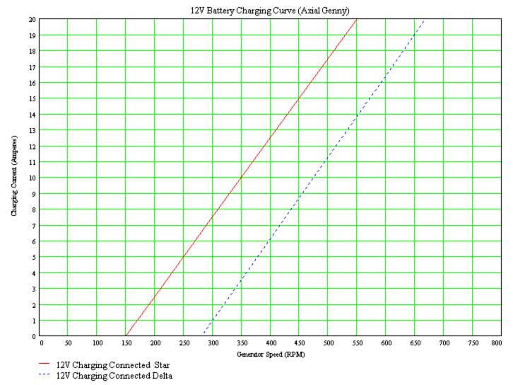

My drill press was very useful for testing this alternator.  The hub's cylindrical dust cap (they're usually domed) allows a belt to be placed around the end of the hub and the chuck of the drill press is able to turn it.  No pulleys required.  The mount was cobbled together a bit to mount in the vise, hold the hub, and hold the stator in position.  You can see the bicycle spedometer in the lower center which gives me a RPM reading.
The ½ HP motor of the drill press turned the alternator well in most tests.  In some tests, the power of the press was not enough to maintain speed.  Despite the press' inability to turn the alternator faster than this, the charging current curve up to this point was straight enough to expect it to be constant up to the stator wiring's rated current (about 20A).
With airflow on the stator, its encapsulation in an epoxy board, and the thinness of the stator, it's hard to tell in advance whether the stator will be able to deliver more or less current than that, without burning out.  Only experience will tell.
Resting with the 20A maximum current assumption, then the alternator can deliver up to 250 Watts charging a 12V battery.
Star Cut-in is at 150 RPM and rated speed is about 550 RPM.
Delta Cut-in is at 280 RPM and rated speed is about 680 RPM.
I haven't computed efficiency yet, but it was immediately obvious that the Delta connection required much less torque to turn than Star, as evidenced by the drill press pooping out at 240 RPM when turning the genny in star, while in Delta I got it up to 400).
(No, belting up the ratios faster doesn't help.  When you're at 100% power, increasing RPM just lowers the torque - the belts either slip or slow down).

Nice results.
Power out would suit a 6ft prop. Bit slow in star for 12v, just a bit fast for 24v.
Looks to be a perfect candidate for 12V star/delta or 24V star with boost converter.
Remember that in delta you can handle 1.7 x current in star for same winding current.
Delta will be easier to drive as the torque is reduced. If you devise a way of measuring input power you will find star is more efficient, but delta is perfectly good enough.
If you do think about switching then star/Jerry is easier to do and may be a bit more efficient. If you have decent bearings I don't see why you can't manage with 1/16" air gaps on a machine that size.
Can I reply to your other post here about cogging and starting torque on the motor conversion. You have almost devised a way of measuring iron loss and with your tacho you can do it.
If you set the tacho to measure rpm, you have the torque from your pull test. Using shaft diameter and pull you can get torque, then with speed you can measure power in.
It would be very interesting to add a pulley the same diameter as the hub on the axial so you can do a no load power comparison on the 2 machines.You may need a long bit of string to avoid confusion from the large inertia of the axial machine.

SparWeb, the bicycle speedometer, how do you get an actual rpm reading from mph? You talk about increased spacing between the rotors this should also allow you to adjust the blade vs alternator match. Progress looks good, carry on.

One way, set the speedometer to kph, set the wheel size to 167cm cir.
A reading of 12.6kph = 126RPMs.
