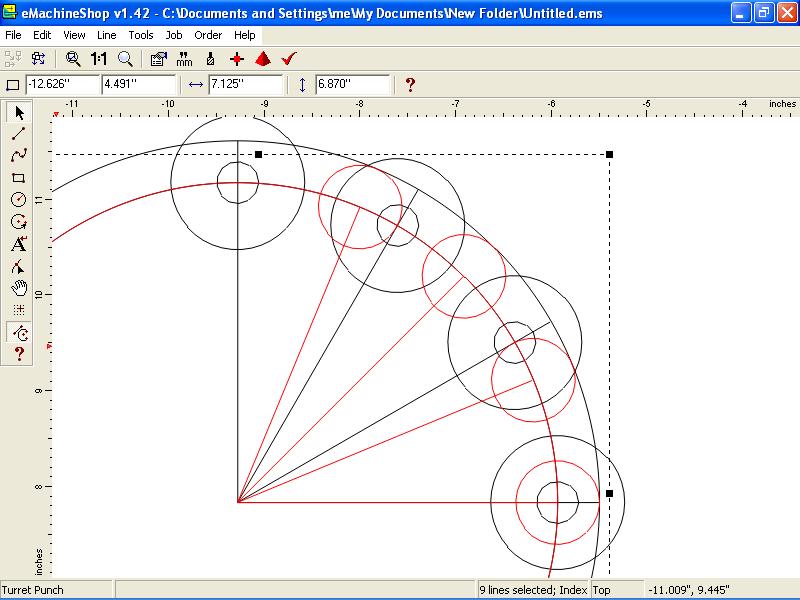

got a new axial flux minigen in the works
i'm using 7/8"dia x 1/2" mags
the rotors are unique lol
almost 8" dia
suprizingly it didnt take that long to cut by hand
my "lathe" needs more power though , its just a coppier motor , pwm powered.
i'm thinking of using the motor as the bearing for the alt
its a 16 mag , 12 coil machine (4 coils per phase)
and i will be using 0.045"dia wire
the rotors are almost 8" dia
the coils are a departure from my usual 2x magnet dia , i've tried to optimize them a bit
instead of 1.75" dia ,
 i'm toying with the idea of making them 1.34"dia
10 turns wide x 9 turns deep giving 0.111 ohms per coil and 0.445 ohms per phase and using just 22'of wire per coil
the hole will be 0.437" dia.
i may not need that many turns though because i was getting 2V per coil at 83 RPM (88 turns), on my 11"dia testbed.
i'm figuring 114RPM to 150RPM for the same 2V on the new machine

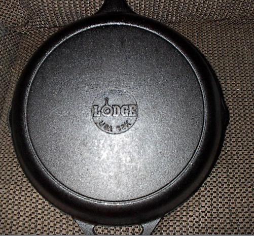

Stir fry mini gen
« Reply #1 on: October 23, 2006, 10:42:27 PM »

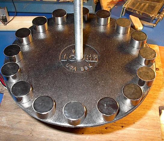

i used a 8" skillet for the rotor

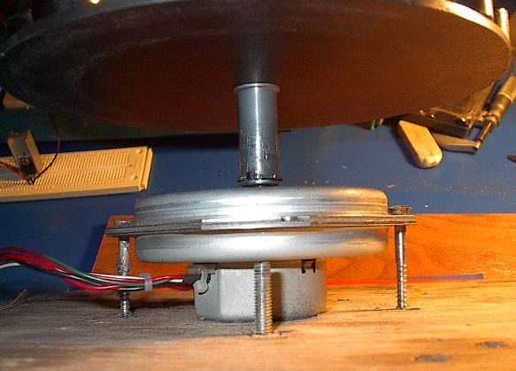

My "lathe" lol

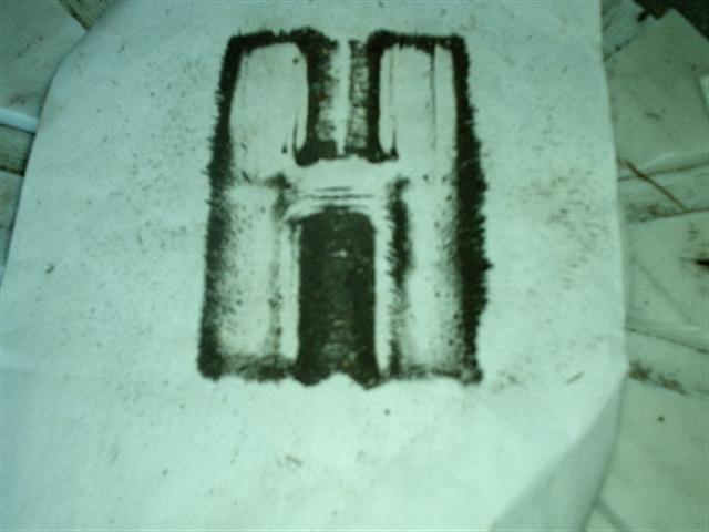

a shot of part of the stator with magnets in red
iron filings , there is a magnet in there somewhere

I thought you were crazy when you said 'cast iron skillet'.  Looks good.
What does the 'lathe' use for a cutting tool and holder, or does it just spin the magnet disk for testing?
« Last Edit: October 24, 2006, 06:34:16 AM by ghurd »
Re: my new mini gen
« Reply #3 on: October 24, 2006, 08:13:53 AM »
 i'm sure it sounded wacky when i mentioned it , but it works !!
the 'lathe' uss a tightly held file as a tool holder lol
and spins the rotor and mags at over 600 rpm
the rotor in the photo is tapped with a 3/8" thread and spins very true
the rotors are 0.165" thick i wish they were a tad thicker though
but they are very flat , much flatter than the imported ones i was going to buy
it didnt take that long to cut the flat out of the skillet because they are cast iron (soft metal), probably less than 45mins with a hacksaw

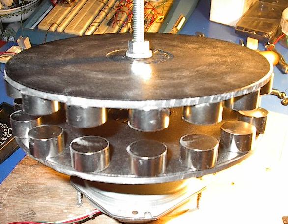

got the other rotor cut and installed the magnets
it took twice as long with a smaller hacksaw than i used before
it should be easy to check the effeciency of this one , since it is built on a DC motor

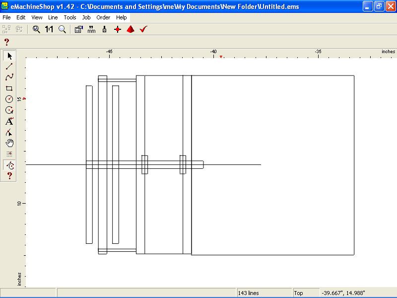

i drew a crude diagram of the spindle i plan to use when i'm done with the DC motor
the spindle is 5/8-11 threaded rod , i had to file the dia a little to get the bearings to fit
just have to locate a 5/8-11 tap and a tap drill
vawtman your wife will be happy i havnt used jewelry yet in my windmills :)

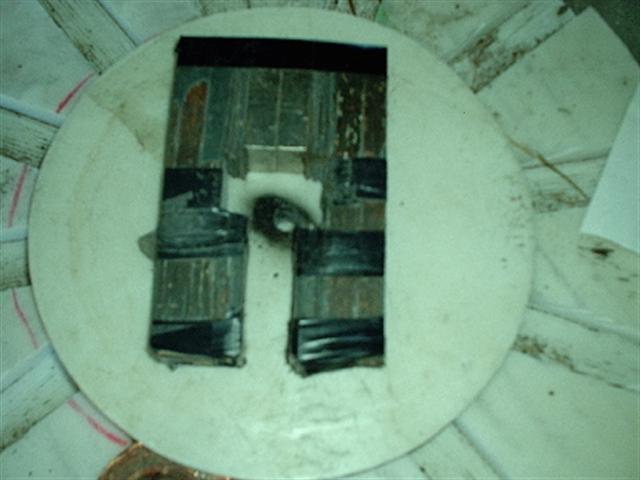

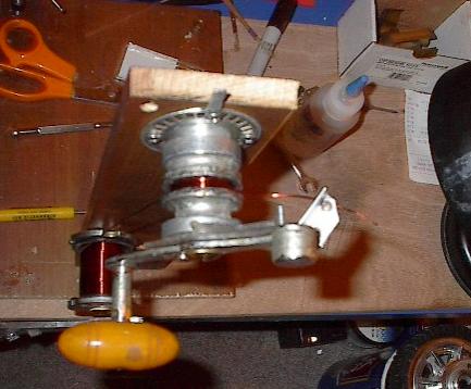

new coil on the way
« Reply #9 on: October 28, 2006, 08:08:42 PM »
it should be done ( cured )in half an hour
60 turns of 0.045"dia wire
« Last Edit: October 28, 2006, 08:08:42 PM by willib »

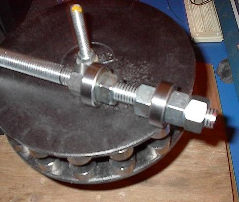

« Reply #10 on: October 29, 2006, 12:22:38 AM »
oops just bent the shaft!
should have used jacking screws
luckily there are no broken magnets
i guess 3/8 threaded rod is no match for neos
i dont recomend doing it this way , but it has worked for me in the past, on my large testbed, which BTW HAS jacking screws, doooh!!
i thought i would bring the mags closer than 5/8"
considering my coil is just 0.260 wide i was shooting for 0.270 , close enough
so i took the top mags off
dropped the upper plate a little
then was in the process of assembling the upper ones back , when the shaft bent
i can unattach the 4 pairs fairly easily lol
on the bright side the coil worked as planned
2.5V at 240 rpm , cutin should be around 281 RPM @ 14.5V ,i think
this is for a 16 pole 12 coil dual rotor machine with 7/8"dia x 1/2" N40 neos
Rotors are 7.75"dia
with 60 turns of 0.045 wire and 0.075 Ohms per coil , and 0.3 Ohms per phase
14.8' of 0.045"dia wire per coil
coils are about 10 turns wide x 6 turns deep with a 0.45" hole
final dia is 1.35" x 0.27" deep.
« Last Edit: October 29, 2006, 12:22:38 AM by willib »
