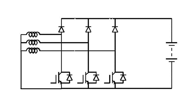

RP
  • Posts: 722
Re: sync rectification
« Reply #15 on: November 19, 2006, 11:53:27 AM »
I've seen "half wave bridge" mentioned a few times.  Can someone please explain what that is in this context?
« Last Edit: November 19, 2006, 11:53:27 AM by RP »

« Reply #19 on: November 19, 2006, 03:12:16 PM »
RP,
It's not "half wave bridge", it's Half-Bridge.
Perhaps this will help:
« Last Edit: November 19, 2006, 03:12:16 PM by SamoaPower »

I am not sure what effect connecting the star point will have. Probably nothing except that you need another lead and have an additional source of RF interference.
At worst it may need a more complicated gate drive. I will try and let you know.
« Reply #24 on: November 21, 2006, 01:33:55 AM »
Scott
It's early in the morning and I haven't looked at this in great detail, but I think you are right. If you match the prop curve by introducing losses in the line, I don't think it matters much where they come from.
The volt drop in a bridge feeding a conventional boost converter is significant and the increase in efficiency using inductors before the bridge is worth having but that is another issue.
Without some form of MPPT the power you gain from keeping the prop out of stall far outweighs anything you gain from messing with electrical efficiency. Adding line resistance at first seems stupid, but it does really work.
The thing about this is that there is no easy way to see what effects these things have unless the improvement is considerable. It is so difficult to measure small changes in performance without weeks of monitoring that if you can see an improvement then the effect is dramatic. You will never see any difference just reducing diode drop even if it is real.
As you say it makes sense to include sync rectification as part of a MPPT scheme, but I don't think it is worth considering otherwise, too costly , complicated and probably unreliable.
We all try to squeeze the last bit of power from the system but sometimes it comes at too high a price to be of real benefit, but we enjoy the fun.
« Last Edit: November 21, 2006, 01:33:55 AM by Flux »
SamoaPower
  • Posts: 417
« Reply #25 on: November 21, 2006, 04:51:44 AM »
Scott,
Looks like you put some real effort into this. If it helped clarify things for you, then it was worthwhile.
I don't think I can agree that the "big picture" helps to clarify the basic issue under discussion. In fact, introducing alternator characteristic variables tends to cloud the 'little picture'.
What your example process illustrates is a poorly designed stator that's not matched very well. To see what I mean, try running your process with a cut-in threshold (zero current) of 8 mph and compare the results. They're quite different.
To examine the value of synchronous rectifiers vs. conventional rectifiers, I still think we only need the simple model.
The largest gains are toward the low end which provides a useful benefit. Even around a typical energy peak speed, the benefit is significant. A lower cut-in also results which allows us to use fewer coil turns for a given cut-in speed.
Thanks for your comments.
Apologies to willib for getting carried away.
« Last Edit: November 21, 2006, 04:51:44 AM by SamoaPower »
« Reply #26 on: November 21, 2006, 09:57:44 AM »
Willib
I should have spotted this immediately, there is no way you can connect the star point to dc- as shown.
If you look at the bottom half of the bridge you have the 3 mosfet body diodes connected directly as a short circuited 3 phase half wave rectifier. You have an expensive eddy current brake.
« Last Edit: November 21, 2006, 09:57:44 AM by Flux »
« Reply #27 on: November 21, 2006, 10:50:46 AM »
oops
those darn body diodes , they help in some cases , and hinder in others
they are not true switches , they are switches with a sometimes pesky diode
« Last Edit: November 21, 2006, 10:50:46 AM by willib »
