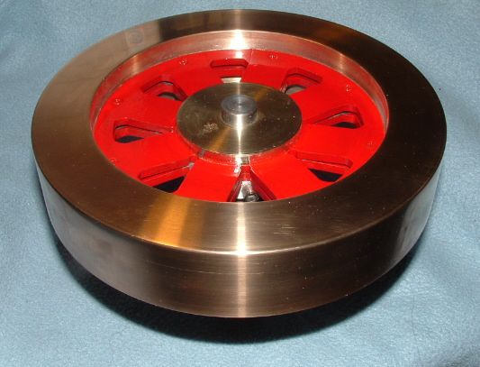

This project has been held-up for a while and with all the Stirling Engine stuff that has been posted last couple of weeks, figure I will join in. The project is a Rena style Stirling Engine. A four cylinder medium temperature engine. I have gathered together most of the parts. This is the first part :
The Flywheel
The center spokes were cut from 1/4" aluminum plate, the hub from brass and the rim is made from bronze. The outside diameter of this flywheel is ten inches and it weights twenty pounds. It will be static balanced and tested to 3600 rpm. The maximum that it will run will be only be around 1500 rpm. Next the crank shaft and main bearings. This should keep me busy for the next couple of days.
Joseph.

I didn't find any info about 'Rena' style stirlings, do you have a link?
Nice work with the flywheel tho... looks very professional.

Paul, I think they also call this one a beta with wobble yoke. I am using a crank shaft. Others use a swash plate because of it's ability to produce smoother action. The pistons that I am using are double ended and the four are connected 90 degrees out of phase. The pistons are from an aircraft auto-pilot. I will be posting some more pictures next couple of days.

Hi joe,
Butifull as usual,
make me ask myself how it you assembled it.
Think of photos of the parts before you put them together
One question:howdo you make those bronze rings.
cast? machine from a huge chunk of bronze?
Thanks ffor the pics anyway
cheers,
stonebrain

Stonebrain, the bronze is bushing stock cutoffs. I bought them from a metal scrap dealer years ago. This one had flywheel written all over it. Two bucks a pound but I love the shine of gold colored things.
Joseph.
