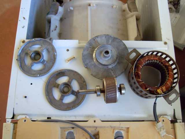

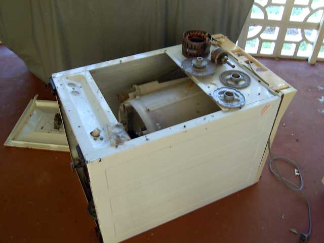

My 12 year old washing machine finally fell apart, and I
splashed out on a new one. While stripping the old one
for useful bits, I caught sight of the old motor.
A quick check showed it was an induction motor. I'm in
Australia, so our stuff is 240VAC 50Hz. Although it had
no spec plate or even a model number, I estimate it was
about a 1/2hp to 1hp (~375W to 750W)? Seems to have a
4-pole 2-phase type of arrangement. It had a capacitor for

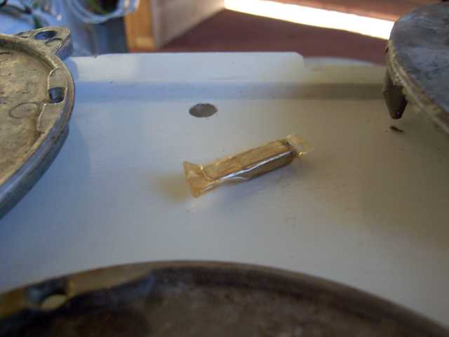

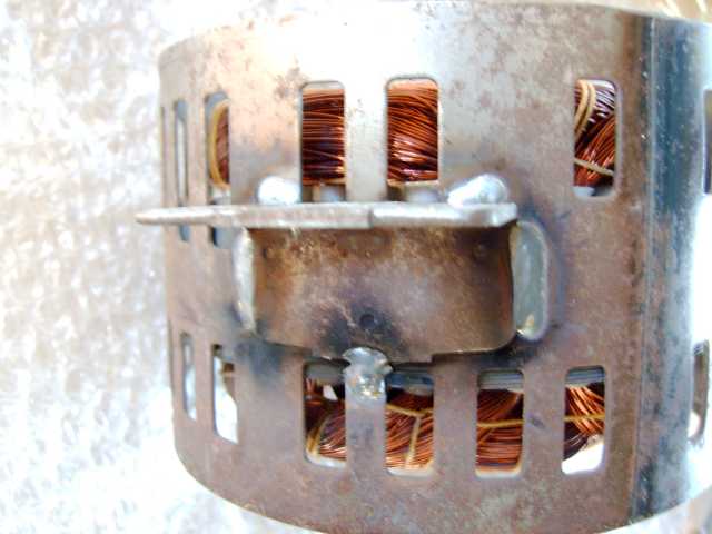

start/run on the second phase and a thermal fuse imbedded
in the windings. I bypassed the fuse to stop it doing anything
silly. This is a close up of the fuse.

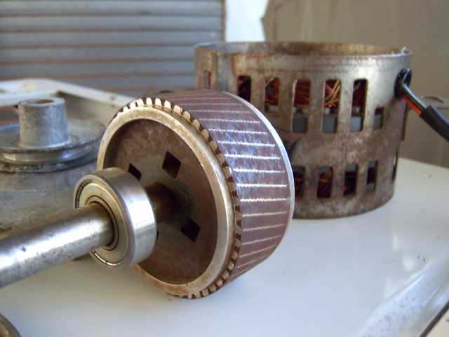

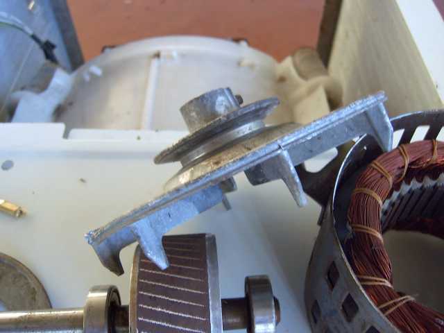

The belt pulley was made of aluminium, and I will turn that
down in the lathe to become part of the blade hub later.

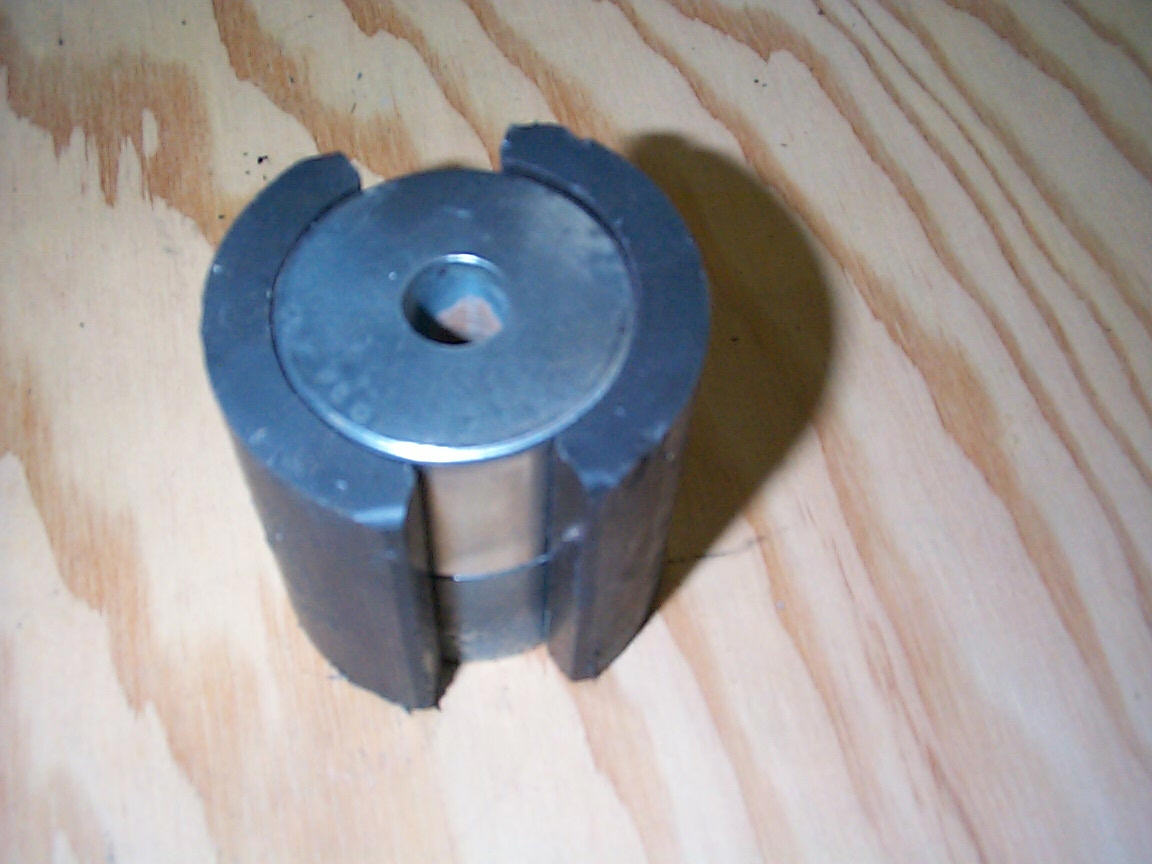

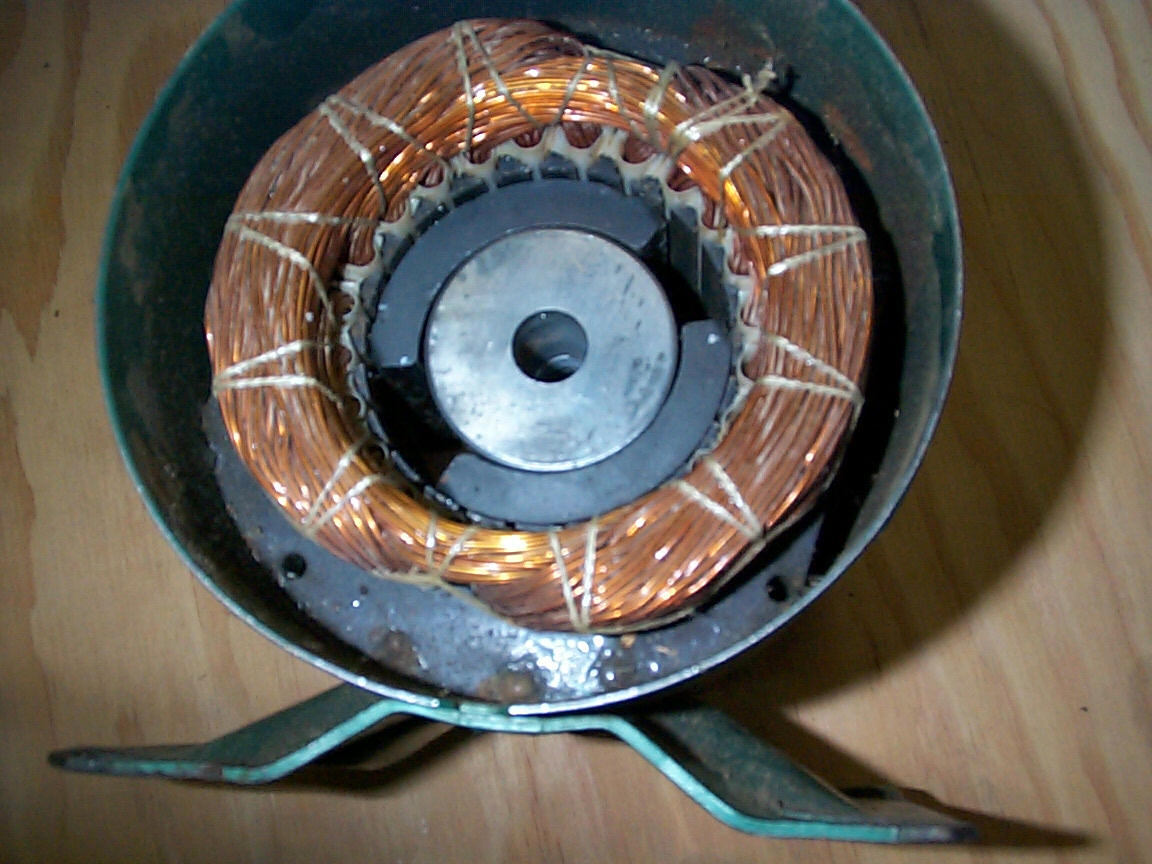

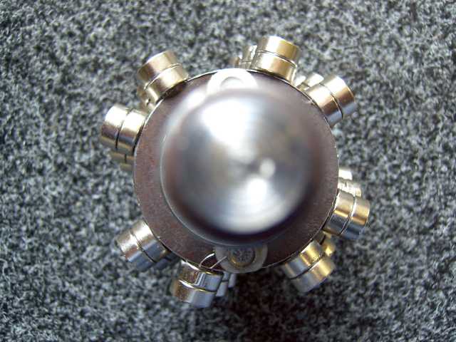

The rotor was about 80mm in diameter, and about 30mm
deep. I thought about buying some long narrow bar magnets
and skewing them slightly. But I remembered I had a pack
of 100 13mm x 5mm disk magnets. Although they are small
and fiddly, I got them for about AU$15 and stacking them
should improve the flux output.

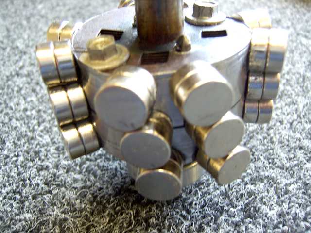

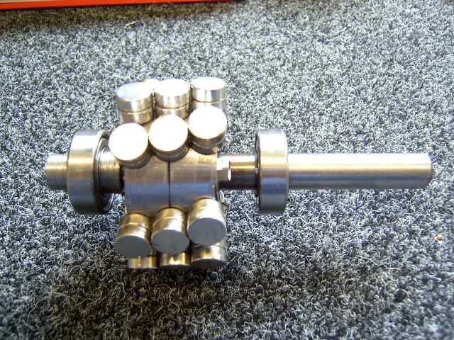

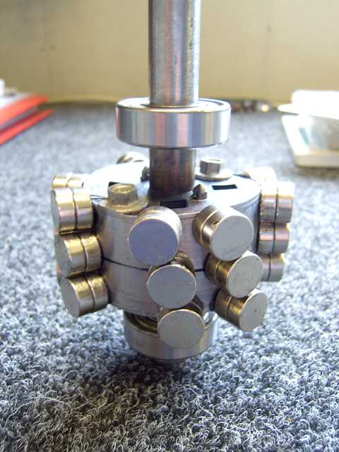

This is what the rotor looked like after being machined down
and with the magnets stacked in a 3x2 configuration. I seem
to allow more space between poles than a lot of other conversion
people do, perhaps I'm fussy about cancellation in the waveform.
Here is a series of pics, where you can also see how I used the
roof screws again to stop the laminates from falling apart. Also
the magnets over hang the rotor a bit. I could have made a fresh
rotor but - bah, this is more of a toy for me :)

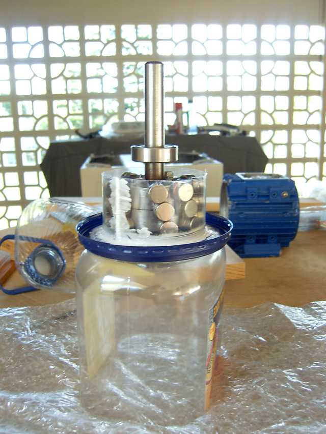

I keep all my old plastic, metal & glass containers these days.
They come in handy for so many things.

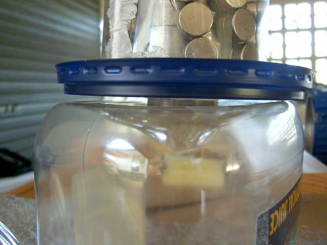

I sliced up an old juice container and wrapped it around the magnets.
Super glue joined it at the overlap. A plastic lid formed the bottom
of the mould, and good old silicone sealed all the gaps. You'll notice
I have not used a cage for the magnets. I want to push the new epoxy
to the limits :)
The rotor sat just nice inside the old juice container base.
Making it both a support and a spill container.

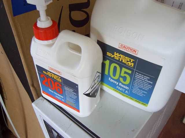

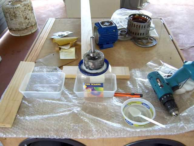

I bought some West System Epoxy this time, as I noticed a
lot of the forum use it. I'm using the 206 slow hardener,
as I'm a firm believer in a better cure for a slow cool/reaction.

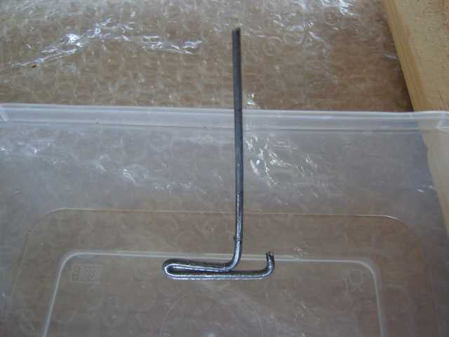

This is my patented :-) epoxy mixing tool. As you can see,
it was not engineered on a CAD system.
I use an old 12V drill connected to a 50Ahr battery for mixing
the epoxy. It means you never go flat in the middle of mixing,
or any other workshop job for that matter :-)

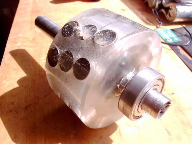

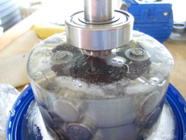

Here is the rotor about 30 minutes after being poured with epoxy.
Most of the bubbles have risen to the top, and formed a froth layer.
After curing for a week in our tropical sun, I put the rotor back
into the lathe and cleaned up the epoxy. The silicone and old
plastic container bits were peeled off easily by hand.
Here it is with the sun behind it. You can see the magnets inside the epoxy.

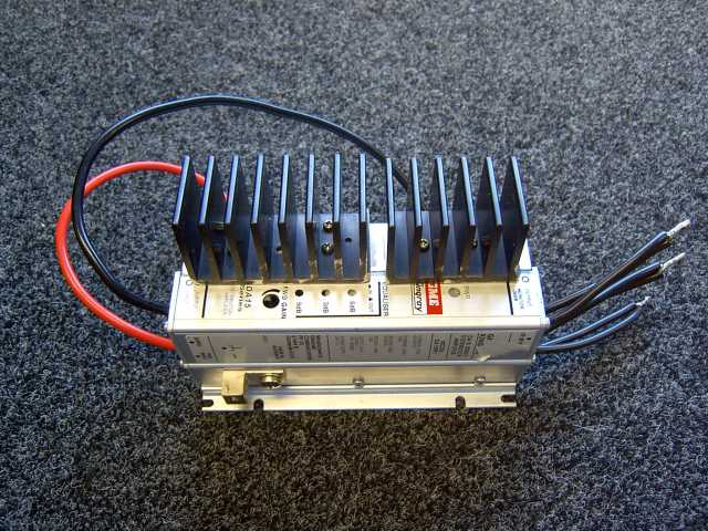

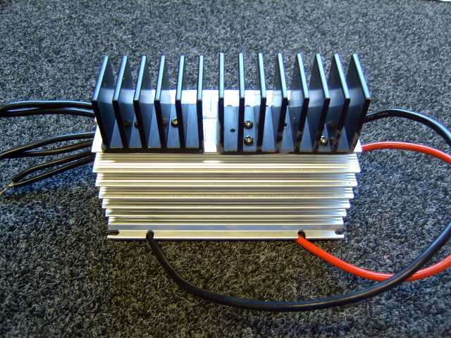

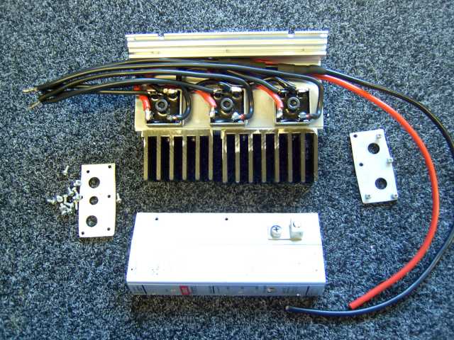

I used an old MATV amp to fit some 50Amp 600Volt bridge
rectifiers to. It was a good opportunity to play with the new
milling machine. I had to make a wider base for the bridges
to mount to, so a second MATV heatsink was cut down and
bolted to the main one. A 2-phase design has only to be treated
as if it were a 3-phase in regards to rectification. Its overkill,
but I have plenty of new bridges laying about.

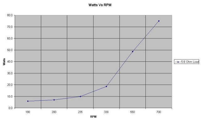

I put the motor back into the lathe and did some tests.
I knew from day one that this would not make much power
due to the 20ohm impedance of each winding. One thing I am
happy with is the waveform. Its an almost perfect sine wave.
The 3hp conversion I did earlier has a slight dip part way
through the wave. I suspect this is caused by a lack of magnets,
as I reduced the magnet count in the final stage of design. I hope
to get some digital waveform images soon.

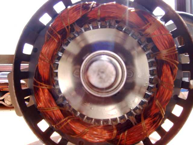

I coated the windings with motor winding lacquer for use
in outdoor environments. And the whole outer casing got
a coat of my favourite 97% zinc protective Gal paint.

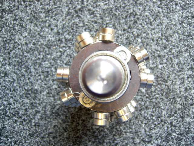

Here are some thought for the 3 phase 2 pole you posted about earlyer.
Sorry for plcing it here but thought it might get over looked in that thred. It was geeting prety long?LOL

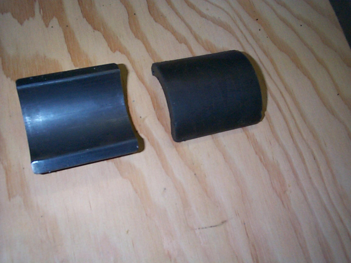

I've played with some 3 phase 2 pole conversions. If your not looking for much power and just expirimenting this might work as well as a group of small NEOs?
Also you might just concidering leaving the stock wireing in the next small 3 phase motor. Just seperate the ends of all coils. Perelell the coils of each phase, use a fullwave bridge for each phase then perelell the outputs of those 3 bridges.
Even though these magnets are only ceramics they cover allmost 100% of the pole face and because of this have practicaly no cogging. The output is low but on a par with the tinny NEOs.
Best part the ceramics are free. I get them from plumbers. Some of the Garbage disposal motor are PM and have a nice littel bridge rectifier also.
Heres a few pictures.
This last 1 is testing.

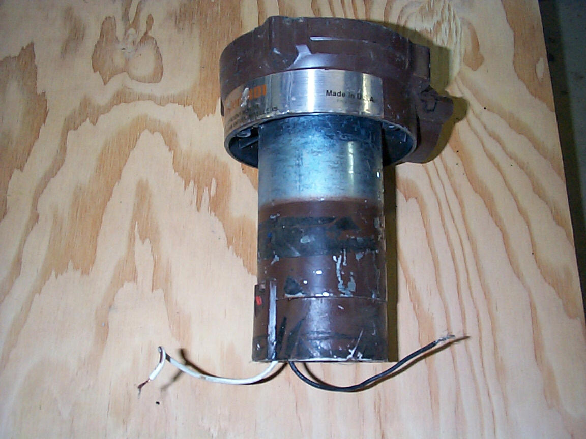

Disposal motor-
Looks just like the "SinkMaster 401".
I scored last spring from under girlfriends sink!
   ( 1/3 HP, 115 Volts, 4.0 Amp, 1900 RPM,60 Hz, 1 PH) that turned out to be a DC motor run off AC with
"nice littel bridge rectifier" hidden inside, smallest square type I've seen so far!
Dam shaft I have left after major hard teardown, (was under sink broken for many years, rusted-up big time!), is just under a half inch long with weird left had threads and about .435 around.
Never flow yet, lack of blades and hubs!

Re: Washing Machine Induction Motor Conversion.
« Reply #6 on: December 31, 2006, 06:46:27 PM »
Cool!
Nice job getting the magnets placed.  How did you hold them down for the initial gluing?
Have you considered reconnecting the coils in parallel?  It looks easier than most of my US motors, which like Jerry's photo, seem almost like a single chunk of coil.  :(

sPuDd
  • Posts: 51
« Reply #10 on: January 01, 2007, 01:54:13 AM »
Ghurd,
   I placed each magnet on the rotor after putting a drop
of "not so super glue" on each one. Lets just say the acetone
came in handy several times. I'd hold each one for a few seconds
till the glue took over. That was it. Then it was ready for epoxy.
I searched for the coil join halfway connection - but I suspect it
was buried deeper than I wished to go without damaging the coils.
As it was I had to coat a few sections again due to scratching.
sPuDd..
