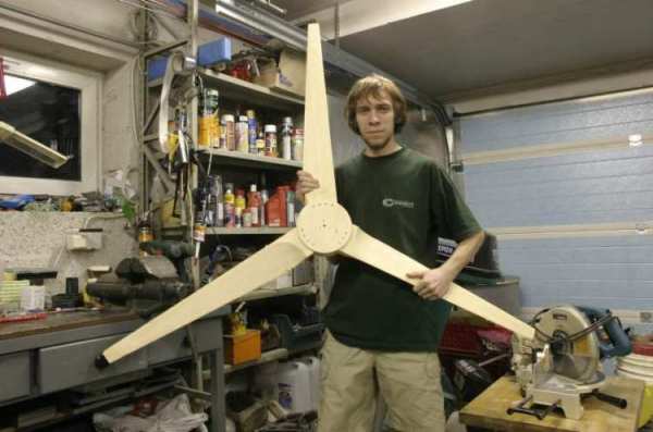

Blades
So as the first thing I started graving out the blades. Sadly I didn't took any pictures of the process but it looked the same as in all the tutorials on the web and in books anyway. Although here's a picture of me posing with the finished rotor.
Making the blades went really fast. First I used formulas from the Piggotts book "Windpower Workshop" to calculate everything needed and then spent half of a day and another evening making one blade. It turned out though that wood work with such a precise shape in such a small scale is quite tricky so I turned to Otherpower's design suggesting using only strait lines form tip to root. Ii took then one day to make all three new blades. Electric planer speeded things really up.

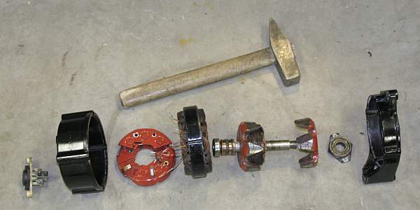

Alternator

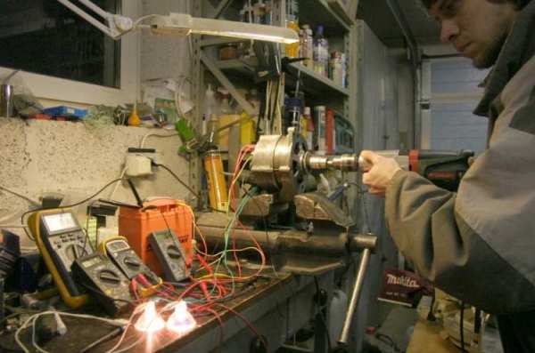

Then on one evening I walked to the nearest junkyard and got myself an Opel Rekord's alternator from year 83'. Costed me 300 EEK (about $25) and looked like it had fallen off by itself, not taken off (horrible!). Well it was the cheapest working one.
It's a Bosch brand rated for 14V, 45A. After little cleaning I started making some tests spinning it around with hand drill.
I used several different wattage 12V halogen bulbs to load the alternator and measured field coil current, output current, voltage and frequency to calculate RPM. The battery was used to excite the field coil before the alternator was producing enough current by itself.

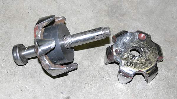

Now about the main concerns regarding car alternators.
The voltage regulator is not suitable in wind power. True of course. But I was thinking, if I use shunt regulator keeping the voltage a little under the rated voltage of the alternator's regulator it wouldn't kick in during normal operation but would still be there to protect the alternator from burning out itself if other controls fail. Not surprisingly bad idea still! I think it depends on the type of the regulator but I didn't realise how suddenly it cuts off the load. Hench if just a little inaccuracy in other controls let the voltage to rise over 14V just for once the voltage regulator would cut off field current leading to unstoppable runaway. Fortunately it's easy to by-bass the regulator.
Then the field coil needs exiting when the alternator has gathered enough speed. Not very hard to devise such a system but it still eats up all your power in low winds just to keep the darn thing exited. I think it would be all the better replacing the field coil with microwave oven magnets - and I'm planning to do just that.
Finally the worst part - high RPM required. Well it doesn't seems so bad at all in my case. Regrettably I didn't made any exact notes during the testing because I wasn't really sure of anything, just wanted to get a overall picture but I will make some more tests soon and keep you posted. Still I noticed that the RPMs didn't rise to hight instead torque started to increase with the load. Maybe it's that the alternator is from a car old enough that doesn't know such high RPMs so the alternator must be a little bit better just to get something out of it.

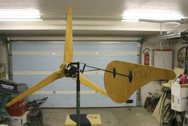

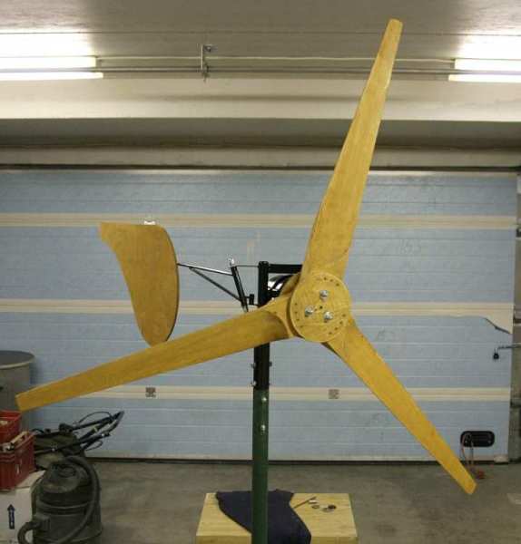

Construction of the windmill
So I discarded the idea of gearing and started building.

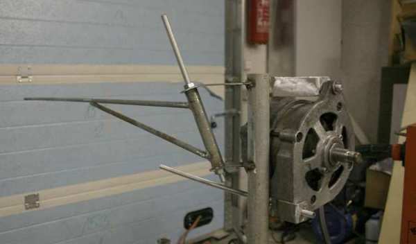

Not much to say here, it's Piggot's furling tail design. Rotor center is ~80mm off from the yaw axis and the tail hinge is aligned at about 20 degrees and 45 degrees away from the rotor axis. Tail stops and yaw bearing are jet to be added.

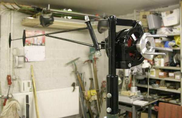

And here it's all put together. Let's take a closer look on it on next pictures.

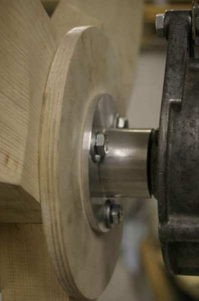

This is how the rotor is mounted on the alternator shaft. The flange is machined out of aluminium. The shaft is threaded and a nut fits inside the flange. Then the rotor is simply bolted on. I don't know if the alternator bearings would hold up, time will tell ...
In the mean while I managed to paint the thing.

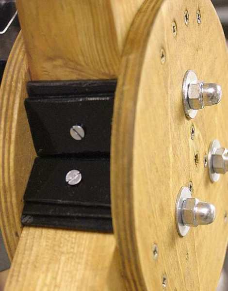

You can see stops for the tail added. The yaw "bearing" is made of different sized pipes. First a PVC pipe is precisely fitted inside the outer steel pipe so it stays put because steel pipes are quite rough inside. Then a smaller steel pipe which is welded on the fat mounting pipe is greased and fitted inside the PVC one. This gives nice free and smooth movement without slacks. I don't think the PVC pipe wears out faster than any other moving part.
Blades are balanced with those pieces of steel screwed to the rotor. And the whole thing is finished on following pictures.
I took two full days all together to build all this. After that it was finally time for some test flight!

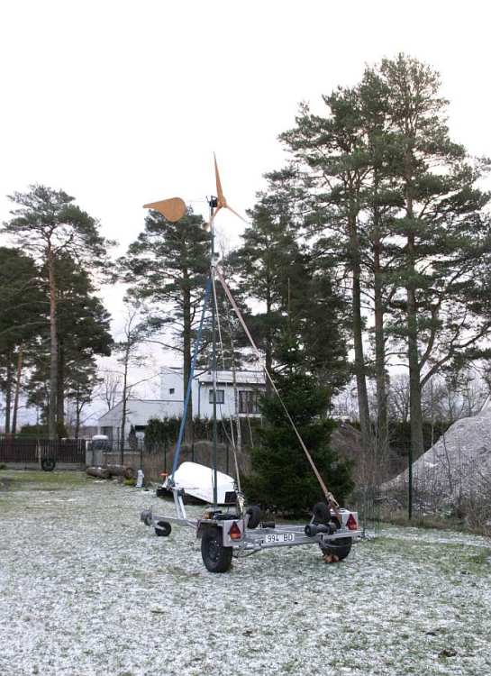

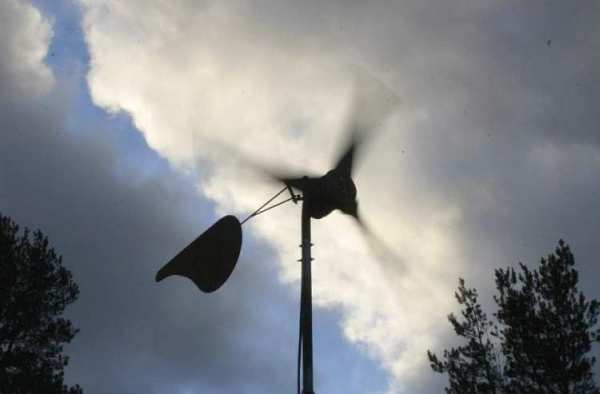

Ehmmm ... yes, that is a boat trailer! I think one can really see the anticipation to get the mill up. :) The trailer is wide an heavy enough for not dipping over and the winch was already in place, I only removed one of the bottom rollers and mounted my tower - what a great portable tilt-up tower!
The mill was up and flying in an hour and I measured some 300-400 RPM and 6-8V into 0,5W load in a light breeze with the field coil powered by battery.
As of 21.02.2006 the mill is up in the backyard free running just for amusement since there's hardly any wind to do anything useful. Just as someone has stated somewhere: there's a total calm for several weeks after you have gotten up you first mill!

You will need to rewind with about twice the number of turns and half the csa wire to get the speed down to suit your 1.5M prop.
If you want any output below 7M/s you will need to replace the wound field with neos.
All good experience, you will eventually find it less work and you will get better results if you build a PM alternator from scratch. Even a small motor conversion will have a bigger core and give you better results than that car alternator, but we all have to start somewhere.

have you taken the alternator apart? if not, it may be worth a look inside.  many auto alternators are connected delta, and if you re-connect it star, it will reduce your cut in rpm needed and raise your output voltage per rpm.
just another thought. if you are successful in re-connecting the unit to star, keep in mind that your voltage from one output line to the star point will give you 58% of the line voltage. so if you are charging a 12 volt battery (the battery will keep the line voltage of the alternator to that of the battery) you could tap off a line from one of the output lines and one from the star point. this will give you approx 7 volts that you can run to a small bridge rectifier to power the field coil.  its kinda down and dirty, but it is a way of reducing the rotor field strength and perhaps allow you to tweek the system a bit. i am also not sure if there will  be any residual magnetism left in the rotor to get the unit going, so you could perhaps put a excitation button from the battery in order to start the unit with a momentary circuit.

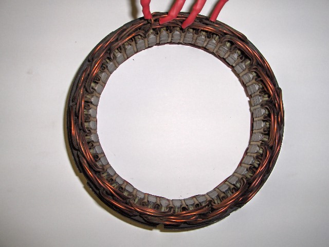

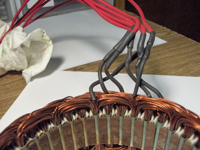

Here are a few pictures of modifications I've made to GM car alternators to reduce rpm and wind speed requierments.
First is to change the wireing scheem to this.
Here is the stator after modifications.

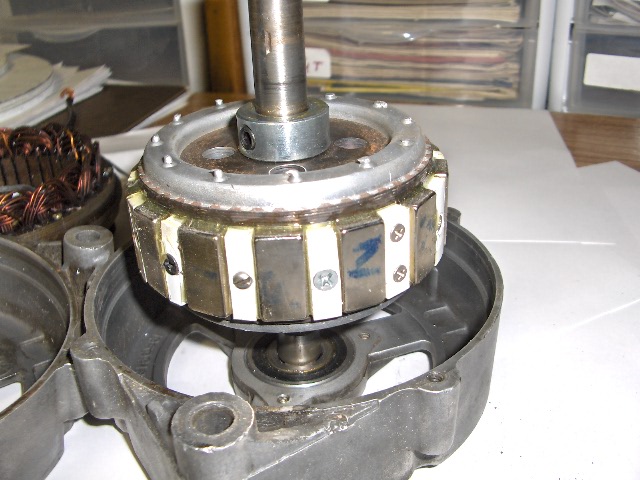

Next I use an armature from an ac motor ocupide with small 1/2"X1"X.25 NEO magnets. This makes for bad cogging but scewing would help reduce that. I also use 2 alternator front faces. This helps acomidate the ac motor armature.
Well can't find the picture I'll post it latter?

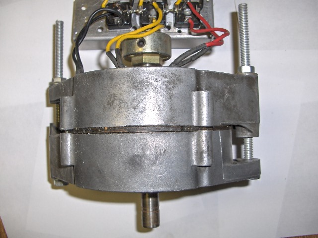

Here is the 2 faced alt.
Heres another alt in the Laithe. 6 wires comming out.
« Last Edit: January 22, 2007, 09:18:24 PM by Jerry »

Yes, I have took the alternator apart. It's already star connected. The field coil I'm not worried about because this is going to be replaced by PMs anyway.

Hi Ahto.
The schematic posted is not equal to delta or star. Star is equal to 2 phase in sires but with a voltage drop. Delta is equal to 3 phases wire perelell no voltage drop.
The schematic I posted is equal to 3 phases wired sires with no voltage drop.
The stator is stock wireing. This reduces rpm requierments drasticly.
« Last Edit: January 23, 2007, 09:17:29 AM by Jerry »

Did you upload the diagram you intended Jerry.
As shown it will require higher speed than star.
« Last Edit: January 23, 2007, 09:58:47 AM by Flux »

12 Neodym 35 dia 14x8mm round magnets I bought from Tevalo. (600EEK)
You need 2-3 times bigger magnets to get good power out of generator.
http://www.tevalo.ee/cgi-bin/web_store.cgi?page=!37-520-52
I have no pictures of this auto(car) alternator modification, but it looks exactly like Jerry-s, only round magnets instead of rectangular ones.
Of course rectangulat magnets are much better.

Hi again folks!
Here's some update. I promised some test results for that car alternator seen above.
 RPM       Amps
   800      0,4
   880      1,3
   950      1,7
   975      2,7
 1000      3,7
 1005      4,4
 1015      4,9
 1030      5,2
 1035      5,8
 1045      6,3
 Volts were 14,5 in all cases.
This was measured on the output with the alternator powering field coil by itself. As can be seen, it would have suited my prop nicely around 7-10 m/s.
Unfortunately this test was the last thing that alternator would ever produce 'cause I continued with modifying it to PM alternator.
"Car alternator for dummies" :P
So I had few of those magnetron magnets laying around and figured that the easiest thing to do would be putting them in place of the original field coil. Well it wasn't easy neither was it wise. Now looking at it it's obvious that there's probably massive flux leakage directly between the "fingers" of the rotor and even without that they were far too weak. RIP car alternator.
At the moment the alternator chassis serving as set of bearings is still up on the tower for the mill to amuse everyone just freewheeling there. The furling system has proven to work although not known at what speed and the boat trailer hasn't dipped over, so that's still good.
As for now I'm planning to build a small axial flux alternator from hard disk magnets to suite my present prop and to continue with tweaking the tail and controls. Would you guys think it be wise to use the alternator chassis and fit the axial flux design inside or would the diameter be too small or something? I'm thinking of 8 poles and 2 coils per phase (3-phase) and aim for 14 volt cut-in. I would use two rotors and double magnets meaning I would cut hard disk magnets in half putting one half on top of other and then place 8 such sets on both rotors.
« Last Edit: January 30, 2007, 12:10:39 PM by Ahto »
jimovonz
  • Posts: 339
Re: Ooops! RIP car alternator
« Reply #21 on: January 30, 2007, 12:19:15 PM »
The gap between the fingers should be considerably less than the gap between the fingers and the laminations. When the rotor is inplace you should get minimal leakage (at least no more than occured with the original field coils). I have had good luck 'recharging' the ceramic magnets from a microwave by placing them on a large neo. In most cases it produces a measureable increse in flux from the ceramic after it is removed. I would be interested to see the output of such a setup...
« Last Edit: January 30, 2007, 12:19:15 PM by jimovonz »
Ahto
  • Posts: 9
« Reply #22 on: January 30, 2007, 12:41:32 PM »
Ohoo? The cap between the fingers was 3-4 times the cap between laminations. Even in original condition. Interesting ...
« Last Edit: January 30, 2007, 12:41:32 PM by Ahto »
