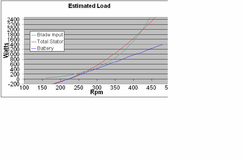

Taking the above assumptions and creating a spreadsheet produced the next graph.
The Excel spreadsheet is uploaded into my files for review.
The cells in blue represent data measured off the test coils.  The cells in yellow are set-up as variable inputs.
I have no idea how correct and/or accurate the spreadsheet came out.  Hopefully, with some of your input it can be improved.   The spreadsheet has been educational for me to see graphically the effect changing a variable has.  Most notable, how adding resistance or opening the magnet gap can move the system out of a slow speed stall.  Initially I had a hard time grasping this concept, which is mentioned in several post.

That's great work so far.  Looking at your power in/out graph, the prop's collected power does not exceed the power required by the stator.  This may not be a problem; the mill just runs slower than you predict, I bet.  I played with your numbers a bit - notice that the curves line up better if you assume 28V charging voltage instead of 25V.
I know of the V(open) - V(charging) equation that the guys here use, but I still view it with suspicion... It's probably close enough for our purposes, though.

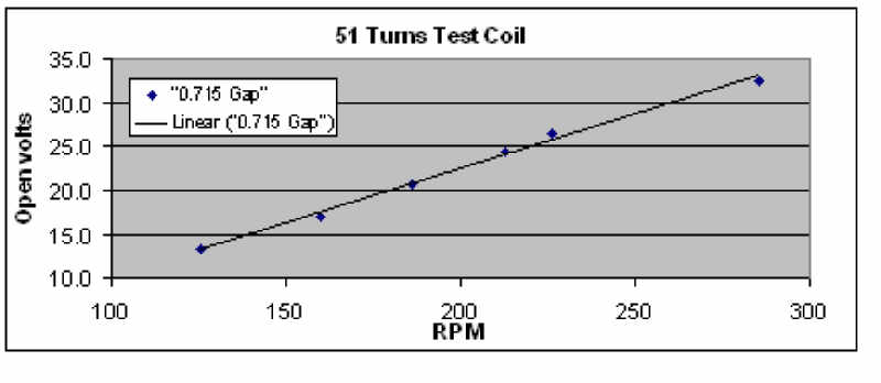

« Reply #10 on: January 28, 2007, 12:27:00 PM »
Made a new test coil, 51 turns two-in-hand out of #14 wire.  The resistance dropped considerably.  Measuring a single coil the highest reading was .068 ohms.  With this coil the trick of heating by shorting it out across the battery charger doesn't work.  The charger kicks out; not enough resistance.
The size of the coil will not be an issue and fits nicely in the stator mold.
Below are the new graphs:
« Last Edit: January 28, 2007, 12:27:00 PM by Boondocker »
