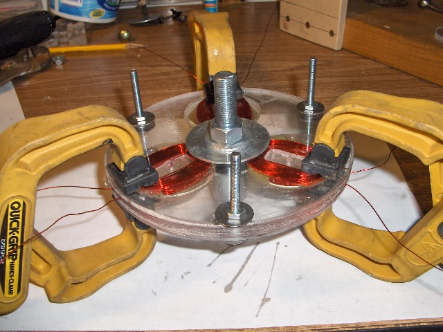

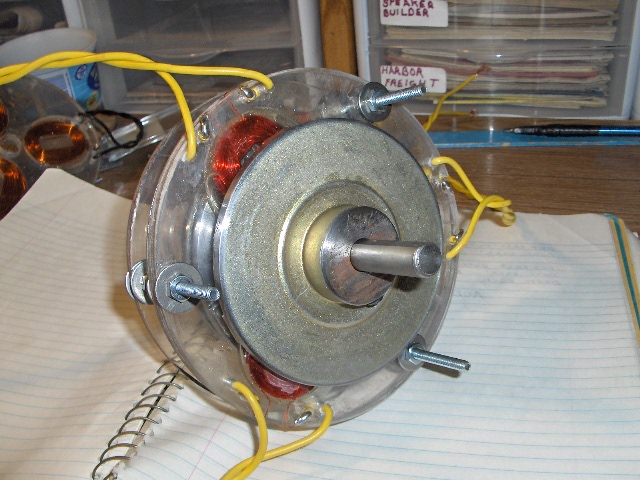

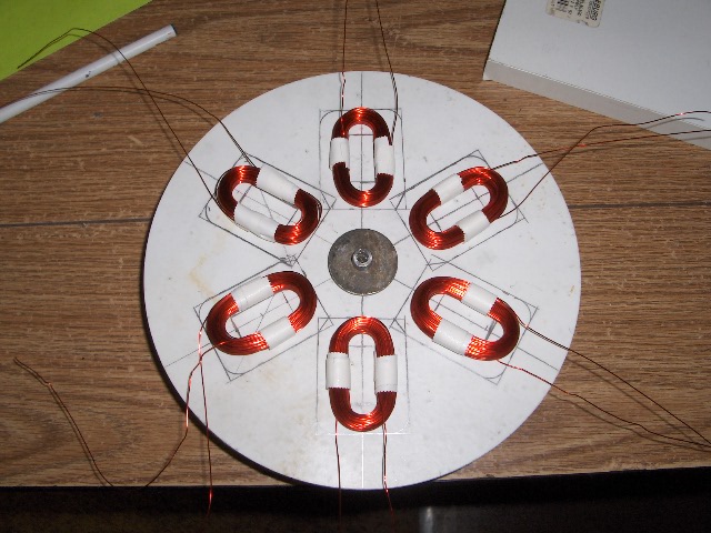

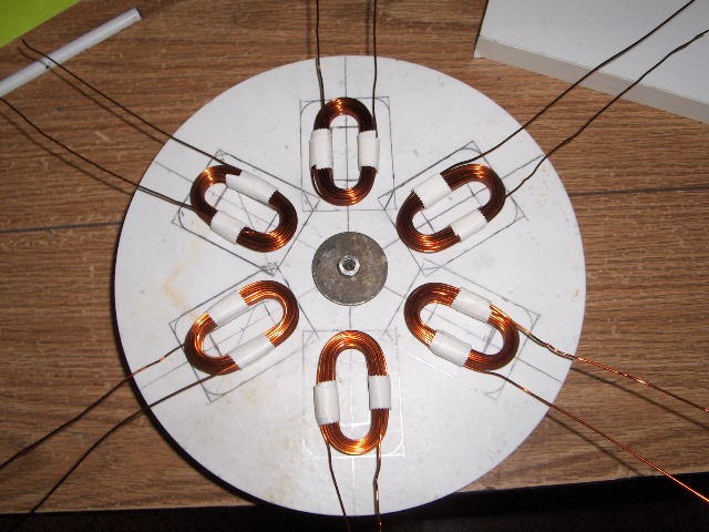

I helped my grandaughter do a school science project. For some reason she elected to do a small wind generator.
Its a 4" dual rotor. The discs are speaker backing plates. She used the same magnets 1"X1/2"X.25".
I'm intrested to see how yours preforms with  none steel discs.

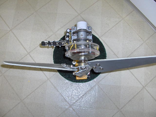

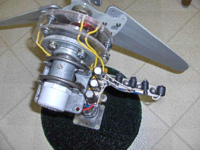

Hi Art.
No it was just for her science fair. Although I did take it to the beach. I set it on a large rock. People were quite facinated with it. It has some LEDs the respond to each phase and one large red LED for all 3 phases. Quite a light show.
I've thought of flying it. Just never figured a good use for the small machine?
« Last Edit: January 25, 2007, 09:21:39 AM by Jerry »

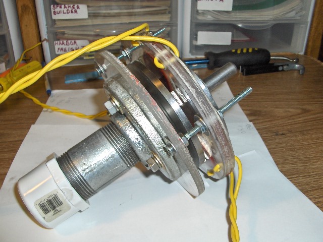

Re: Warning 11 Pitures.
« Reply #6 on: January 25, 2007, 10:28:43 PM »

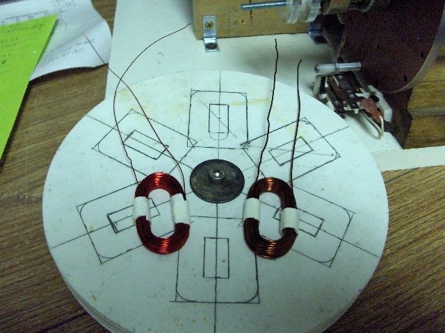

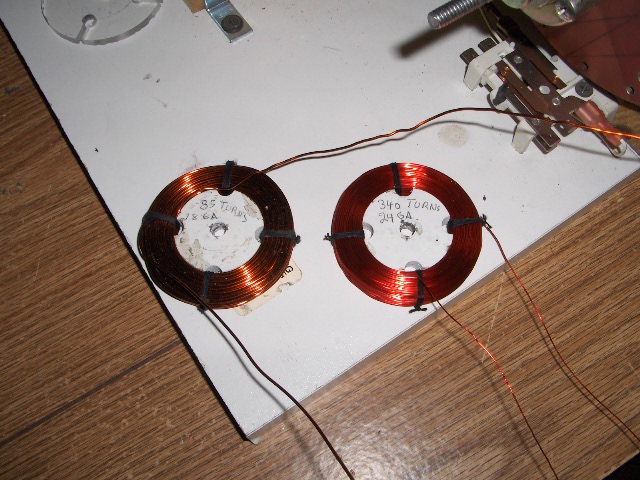

Hi s4w2099.

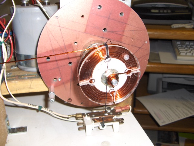

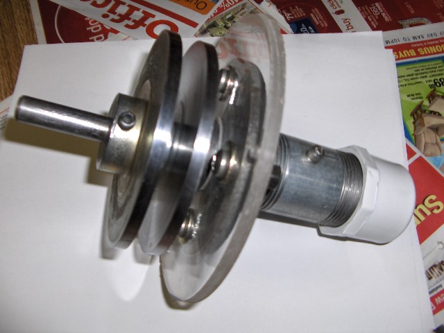

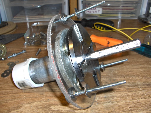

Here are some pictures. I'll just post them. If you have any questions I'll answere latter.
« Last Edit: January 25, 2007, 10:28:43 PM by Jerry »

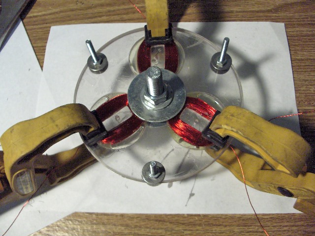

Re: right picture I hope?
« Reply #7 on: January 25, 2007, 10:35:55 PM »
Whoops sorry, that last picture was the wrong one. I'll try that again.
« Last Edit: January 25, 2007, 10:35:55 PM by Jerry »

« Reply #8 on: January 26, 2007, 01:35:24 PM »
Those are nice man!,
I am sorry to tell that my alternator did not work because its not a ferrous rotor surface. I have tested the same stator with other rotors and works very nice.
I will just use the same stator with another rotor. I just dont know where I can find a disk just like yours.
I dont find much information in the forum for this matter but because of the results ferrous rotors MUST be used.
If you guys have any clues please let me know.
« Last Edit: January 26, 2007, 01:35:24 PM by s4w2099 »
