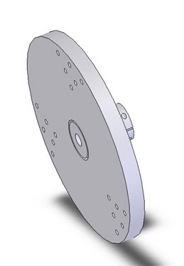

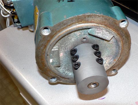

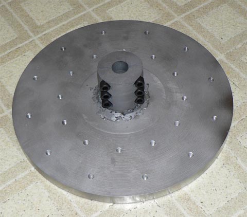

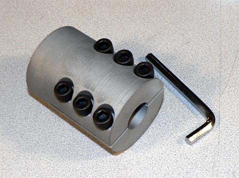

My initial thought for a hub for this gen was to cut a keyway. With the shaft size, I don't think I want to weaken it in any way. I figured a split sleeve with locking screws should be able to hold up if made strong enough. The shaft has a 3/8-24 thread in the end. The sleeve will have three 1/4-20 screws down each side, and all will get loc-tite to make sure they don't back off.
Next will be an 8 inch x 1/2 inch disc with a 1/4-20 bolt pattern for mounting the blades. It will be welded to the end of the sleeve. I am hoping that this will be as permanent as a hub can be. After the hub is finished, it will get a desperately needed paint job.

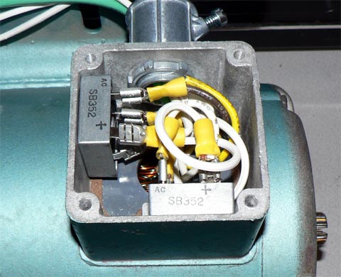

Rectifier mounting. I ended up using loc-tite superglue on the rectifiers. I figured drilling for a screw would end up letting more moisture in. Everything is crimp-connected. It's definitely a tight fit, but everything is in & should dissipate heat fairly well.

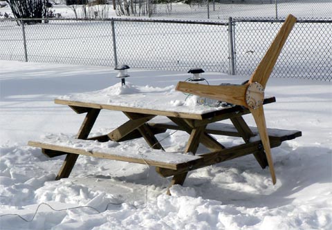

The rotor ended up being stainless. It was the only thing I had on hand. I'll even post my horrid welding job.
As it is outside, I don't think I'll be putting up a tower anytime soon. For the sake of seeing it turn, it is outside for a trial. Not optimal conditions, but it's reached 3 amps charging so far.
Now it's a long wait for decent weather to get it up on a tower.

Trust me, the table and not being able to track the wind has a very serious impact on the output.  It'll do a lot better even 6' up.

I know it's about the worst possible conditions for it. Doing this gets it out of the house, and actually turning more often than not. I've had a couple gusts push it up around 3 amps output, but it certainly isn't going to be doing much at ground level locked down in one position. It's more a case of me getting the satisfaction of seeing it spin, getting some of the clutter out of the house, and a quick & dirty test of startup ability. Considering the conditions outside, I don't think I'll be doing anything more with it until things thaw some. After seeing it spin up fairly easily, I can't wait to get it up in the air.

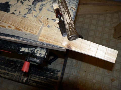

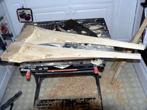

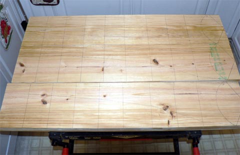

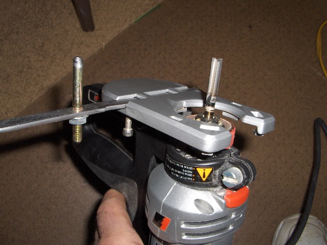

As the weather is horrendous, I decided this would be a good time to do some indoor work. The 5 ft (cut an angle & slap it together) rotor has obvious startup issues. Once it gets going, it spins good although the tsr is way off. I decided to make a "real" rotor for it. What I ended up with is a split-the-difference culmination of numbers from Hugh's spreadsheet, and the Warlock blade calc. I don't like the idea of laminating anything, so I stayed with single thickness boards.
After all is said & done, these will make a very light weight 6 foot rotor with a tsr around 6-7. Two down, one to go. Lots of cutting with a hammer, chisel, and draw plane.
I also have started on the yaw assembly to go over a 2.5" pipe. Providing I can get a break in the weather I am hoping to put it on a 10 foot test pole very soon.

Update! After a considerable amount of time thinking that this conversion was a complete failure, I have good news. First - the problem. I watched this thing run around 300 rpm stalled hard. Regardless of the wind speed, it would hover around 300 & not run much faster. Absolute maximum of .5A charging.
Not acceptable.
I brought it back inside & started checking things out. Tested the windings for a short, and all looked good. The run windings in this motor checked 2.4Ohm, and the start winding checked 3.6Ohm. I figured dropping the start might allow things to loosen up. I rectified the two run windings, & taped off the leads from the start. Re-assembled everything, and back outside it went.
I like having a meter outside directly from the gen so I can watch the electrical & mechanical at the same time. I wired things in to the batteries, turned on the meter, and let things loose. Wind was around 15mph at that time. After seeing the 6ft rotor turn so slowly, I was shocked when it spun up to a blur almost instantly. 3-5A charging, and a rotor speed that is a little unnerving. I stood outside in the freezing wind for 2 hours to watch for signs of any problems. Nothing but a swishing sound & a good steady charging current. All is well.
Seeing the output as it is now - bolted to a picnic table with the tip of the rotor 2 inches from the ground, faced stationary into the prevailing wind, lots of obstacles to block the flow of wind.... I expect that once it ends up on a pole, I should see some impressive output from it. I have no idea why rectifying the start winding causes it to stall so badly, but I can live with the output I'm getting without it.

They may be shorted.  It sometimes doesn't show up with a meter.
I had that problem a couple times. One didn't act shorted until the volts got higher. One didn't act seem shorted, but wouldn't make many volts compared to the other coils.
