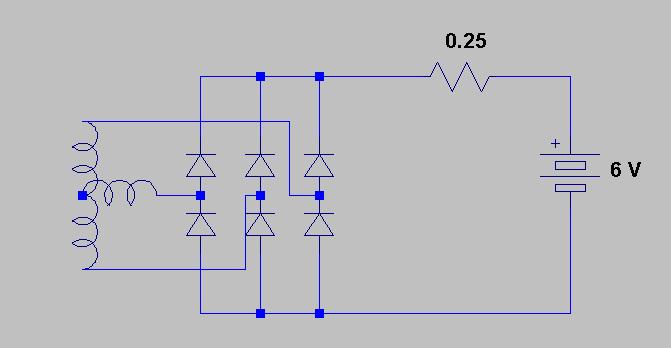

i crossed the 100W barrier
My little mini Gen II output 133.3 watts today!
the voltage across the output was 12.3V
the current was 10.84A
this was into a 6 Volt , 6.5 A/H sealed Lead-Calcium battery
this is a diagram of the circuit
my meter was  reading 2.71V across the .25 ohm shunt ,which is four 1 ohm (10 watt) resistors in parallel.
i might try Ron's , one foot of #10 wire shunt method , because at 10.84 Amps  into the 1/4 ohm resistor , is 28 watts wasted just in the resistors.

Welcome to the 100+ watt club. How did you draw that schimatic? Its nice I like that.

i used linear technology " swCad III
http://www.linear.com/designtools/software/switchercad.jsp
it is more of a circuit analysis program , but makes nice schematics also.
a word of caution though , it is not as intuitive as eMachineshop , as programs go..
but if you decide you want to try it out , i can help..
« Last Edit: March 28, 2007, 09:15:30 AM by willib »

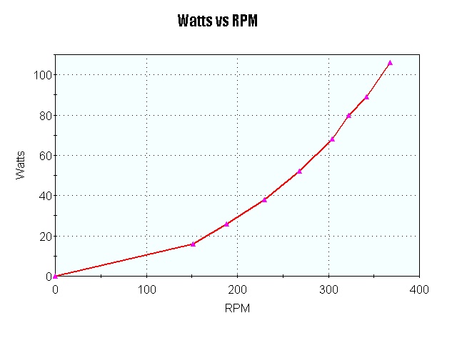

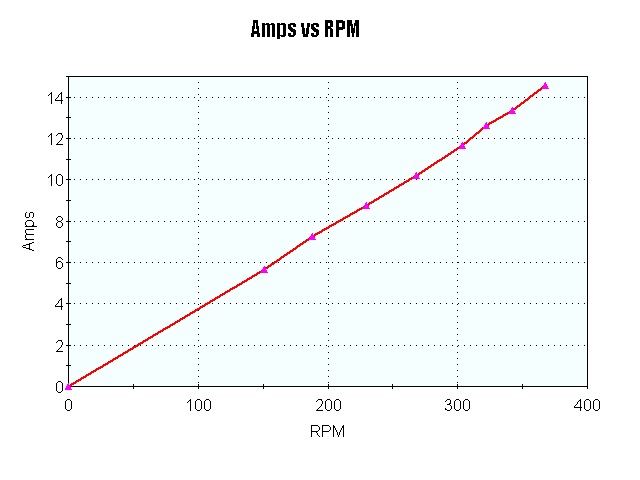

i just finished the graphs you see below , and i am very impressed with the look of them
the Minigen II is more powerfull than i had thought.
the load is a huge honking 0.5 Ohm resistor 100 Watt  1% with a built in heat sink
a batterys voltage will change during testing , so i used the resistor instead
i would have preferred a battery since it is relatively easier to pedal , but the resistor gave me no break at all and i was pretty worn out by the time i got to 106 Watts at 368 RPM.
I used a video camera and a VCR to record the readings from the meters , i used two voltmeters across the resistor , and averaged the volt reading ,
The RPM reading was from one meter taken from one coil
so i was able to step through the test one frame at a time with the VCR , a pretty cool way to do it
the little triangles on the graphs are the plotted points
« Last Edit: March 29, 2007, 10:09:50 PM by willib »

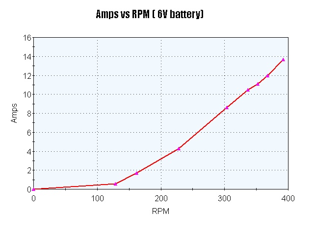

I did some battery charging graphs
Current was measured with a calibrated length of 0.045" dia wire , to 0.01 ohms
i also preformed the test with two 1Farad caps (in parallel) between the Diodes and the load.
i'm not sure of the reason i was able to pedal up to 54.2Hz (407 RPM) with the caps in the circuit , but i wasnt able to go that fast without them.
It may be that the caps gave me a little assistance when i let off the pedals a little bit , and this assistance gave me the break i needed to pedal faster.
Note: i am measuring total alt output , not just current and power into the battery.
although the loss this time is just 2.05 Watts at 14.32 Amps because of the 0.01 ohm shunt.
« Last Edit: March 30, 2007, 02:36:42 PM by willib »
