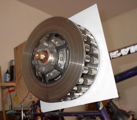

 48 neos , 24 per rotor ,1 inch long by 7/8 inch dia N40 , 18 coils , when done,
I was charging a 6V battery and measuring torque on the stator
this is the data i collected:
 9 Newtons at 6 inches
 160 RPM
and into the 6V battery was
 8.9V at 1.4A
this is the alt i used , before i put half the coils on
so i have 9 coils , from previous experiments ,installed similar to the mini GenII
Although not optimal .. but needed to charge batteries and keep my excercizing going since i took the mini gen II off of the excercize bike
the stator holder is able to rotate about the central axis quite freely.
so i was able to attach a 0- 20 newton spring scale at a distance of 6 inches from the central axis
i am trying to calculate the power output / power input ...efficiency
i'm sure i could figure it out ? , but if anyone has the formula in the front of their thoughts i would really appreciate it

« Reply #5 on: April 10, 2007, 02:23:07 PM »
Thanks Flux thats what i was looking for..
i would include a picture , but it does not look presentable at the moment , none of the coils are soldered together or otherwise connected properly..
i just have aligator clips making the connections , but it is cool when it starts to charge, the stator holder and stator rotate in the direction of rotation and puts a pulling force on the spring scale.

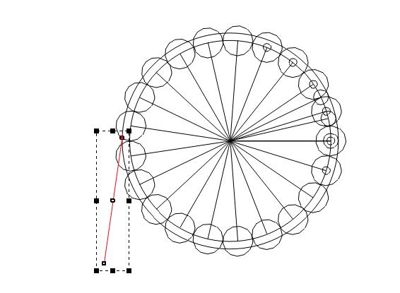

the angle that the spring scale at, is not quite tangent to the direction of rotation
i think that matters a little ?
i havnt done any calculatons yet but i will ,
 this is the approximate angle
