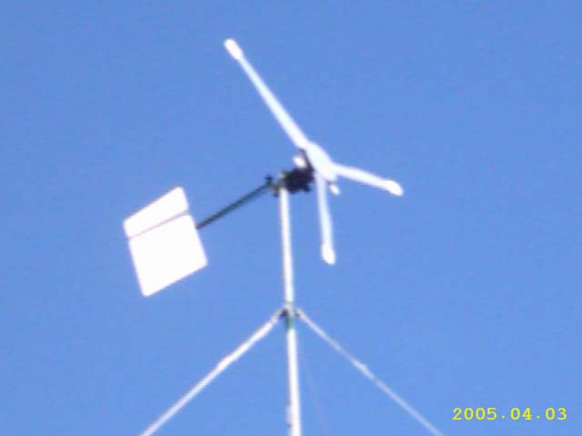

As PM motors/generators have a linear speed/volts relationship, one mearly needs to hand turn with some kind of crank. Most seem to be able to hand turn at 200 rpm but any speeed will allow the curve to be calculated.
A simple hand crank could be a say 1" sq piece of timber about 6" long afixed to the shaft with a saddle clamp, leave the key in the shaft. Place a bolt in the outer end to complete the crank.
My experience with conversions is they are quite efficient beasts so some design has to go into the blades. As your system will be 12v you may find charging volts reached at relativley low rpm's, there is no facility to "open the air gap" as with duel rotors to allow better matching of generator to blades, ie it may stall.
The Amtech may be a good start, you have the parts, plenty of info on here about them, 6' blades may be a little large (they need speed), but go for it. I use Hugh Piggot's blade program, an earlier version than is currently on his site. It allows you to imput desired watts and speed, then it calculates blade diamiter then gives necessary data for carving. There is nothing wrong with sandwitching the blades between ply as Hugh shows in his books, it's a good way to start.
The set in this photo are like that and actually on a TDM, currently on a F&P. I think about 5', can't measure them they are spinning and it's raining(hopefully this is the breake for the season)
The pre drilled hubs I buy come from bearing supply outlets they are designed for matching to sprockets. Available in a large range of hole sizes with same OD (well in the sizes I use anyway).
