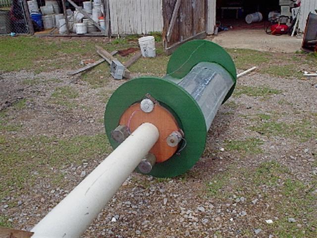

« on: April 19, 2007, 01:59:38 PM »
one good thing about having several projects going at once is the fact that if you get held up or bored with one you can pick up where you left off on another one. this project is to make use of the pile of pm motors that i have on hand and to try a different methed of gearing up without a lot of friction loss. i also want to try using one of the motors to increase or maintain rpm during periods of low wind by having a wind speed controled relay to bypass it's diod at preset wind speeds. this should be a low rpm hi torque unit that produces small but regular amount of amps into my batteries.
enjoying myself, pepa

« Reply #2 on: April 19, 2007, 03:48:46 PM »
hi norm actually it is four pieces of stove pipe 60" high and 36" finished dia. with a 5' section of fiberglass pole as the center. pepa

« Reply #3 on: April 19, 2007, 04:25:40 PM »
I just realized those are motors with the pulleys
riding around the inside edge....neat....I could
do the same thing with 4 stepper motors I have.
  I even have a 5' section of iron pipe that I
can use.....
What's the ratio? Mine would only have to be
about 3 to 1, one lights a 6volt 2led lamp at
about 80 rpm.
 What kind of bearing do you use for the top?
                  ( :>) Norm.

« Reply #4 on: April 19, 2007, 04:55:38 PM »
the bearing is a one and one half inch roller type bearing from a mobile home axel. i used four of the rear wheel sprocket sections from a junk ten speed bike. i have't worked out the ratio for each motor but it should be quiet high as the chain is approx twenty eight inches in dia. i hope this helps, pepa

Re: driveing multible pm motors
« Reply #5 on: April 19, 2007, 05:46:46 PM »
Nice work Pepa
 How does she spin with no load?

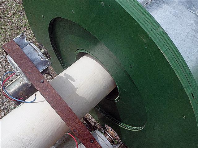

  • Posts: 1538
« Reply #6 on: April 19, 2007, 07:11:33 PM »
Nice work you did there and great idea!
I like that chain and sprocket idea. That may be just what I need for a project myself and I never thought about running one inside a circle like that. It should take all the main stress off the chain and being the chain is not runing normally bending around sprockets no worries about oiling, rusting up, locking up, or breaking under tension.
How did you make that though, I mean to hold the chain in place under loads? How is it fastened in placed?

« Reply #7 on: April 19, 2007, 07:53:45 PM »
hi ntl, i dadoed the inside of the circle to the depth of the chain and epoxied the entire chain into the dado with jb weld, making sure to keep the sprocket tooth area clear.

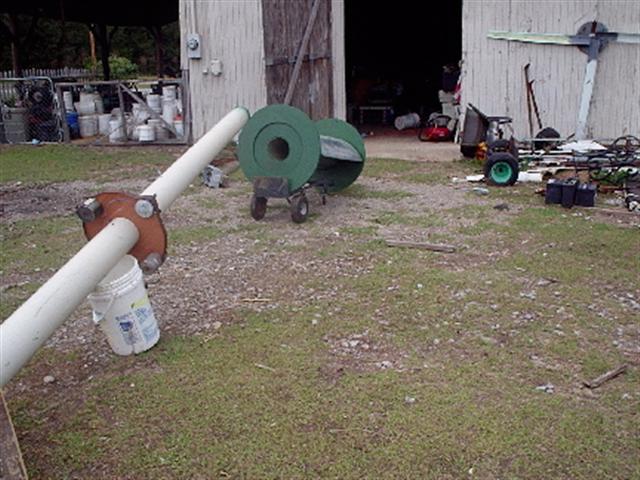

« Reply #8 on: April 19, 2007, 08:32:20 PM »
A Savonious type VAWT 60 inches tall, and 36 inches diameter.
That's a grand total of 7.5 feet of swept area. (with another 7.5 feet dragging the wind.)
That's roughly the equivalent of a 36 inch diameter HAWT, in terms of swept area.
Think of the power you would get from a 3 foot HAWT.  Minus Savonious inefficiencies.  Minus gear reduction inefficiencies.
I hate to sound like a naysayer, but unless you have hurricane winds, it's unlikely you will get any usable power.  4 PM motors are simply going to add way too much drag to ever get anything from such a small rotor.  Odds are, you'll be lucky if it turns.
It's a neat looking project though.  If I were you, I'd try it with one PM motor and see if you can get any power, before you try overloading it with 4 PM motors.

« Reply #9 on: April 19, 2007, 09:09:34 PM »
Here is the same idea, I was thinking of doing
the same thing along time ago but I couldn't
figure how to hold the chain in place until
I just now see how you did it....really neat
Pepa !
Like it shows here, I cut a circle of cardboard....
cut a length of chain so it was just a shade too
short....sanded down the edge of the cardboard
until the chain fit.
  You just gotta be havin' a barrel of fun !
                 ( :>) Norm.
« Last Edit: April 19, 2007, 09:09:34 PM by Norm »

« Reply #11 on: April 19, 2007, 09:16:24 PM »
hay countryboy, this is just an experiment that may work and may not but the small test unit that i built and tested worked fine and with one of the motors helping the wind i thank i might will get a few wats out of it. i do this as a hobby and if it does't work i will try something else and i don't think the design of this unit will have the drag loses that you quoted. wind speeds up as it goes around a rounded object if there is no build up of pressure in front of the rounded object. having fun, pepa.

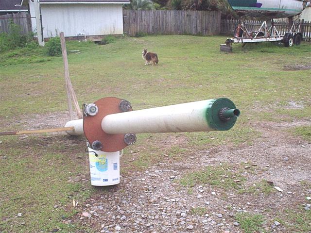

« Reply #12 on: April 19, 2007, 09:22:14 PM »
Even if it is too small he can keep the gear
arrangement disk motors and all and just make
it bigger....wider taller ...it'll fly !

« Reply #13 on: April 19, 2007, 09:41:40 PM »
good thinking Norm, i have the poles and a large pile of sheet metal, if i had some help i could build a monster size unit but i am alone and do this for fun and to try out new (out of the box) ideas. nothing ventured nothing gained!
