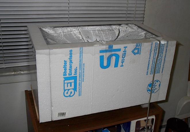

here is what i had in mind
use a fish tank to hold the water to be distilled
make a box to fit ontop of the fishtank
use the fans to blow the hot air in the attic around the tank
use fans inside the aparatus to circlate the evaporated water
use fans to suck cold air from the floor below, and pass this air through tubes to condense the moisture

In order for you to actually distill water and make it safe to drink, you'll need to get the water up to 212F this of course is around the boiling point.
At this point water begins turning to vapor, this vapor is what you want to capture and it's mostly pure. Would be better to go the route of a refulx type , but a simple is still good.
With the way you're wanting to do by using attic heat, cold be good to pre-heat the water. Means bringing water up from whatever temp you can heat transfer from the heated air and attic to 212F, may not be necessary though.
Another way , and with your building abilities probaly easier too. Make a solar heater using high-temp glass and copper tubing. Using a temp gauge, run the water in the bottom and let the water get hot enough to come out of the top either as steam of VERY hot water, this will go along way to getting the water distilled.
This way is done all over the world and if I could keep the temp down to a better control for Alky I would be doing it too.
So far, my crude attempts have always been way too high and I ended up with more water in the first run than my normal way of using solar assisited imerssion fish tank heater.
Come to think of it this may be another way for you to try.
Since you have that cool supper Cap 12V thingy , you could run a small 150watt inverter with a fish tank heater plugged into it ( the Wally world kind that cost ~$26.00) turn it up to 100C or as close as possible. let it get to the point of making water vapor and capture that using clear tubing make a dip in the middle of the tubing so no air backup into the line and let the water vapor condense into another water container. Once your super Caps begin to get low, start charging them back up. And continue.:-)

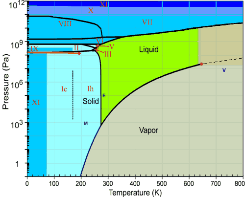

say it gets to 110 F degrees up there , i think that may be a little low.
thats 316 K  acording to my handy dandy i net converter
http://www.digitaldutch.com/unitconverter/
and there are 101Kpa in one atmosghere
i hope this is the right chart :)
i take it that anything on the vapor , liquid boundry is boiling?
i'm not sure i can take advantage of this knowledge because , how would i get the clean liquid (water)out of the container? and wouldnt i need a sphere to hold the vacuume
nice idea though
you say that evaporation just wont do it, isnt boiling water just speeded up evaporation?its been a long time since my thermo class but i really enjoyed it

    No evaporation will work. It's just way friggin slow. As for getting the water out of the condenser you either run the system as a batch setup and just drain the product out after the run or you can do a continues process but you need a pump. If you read up on how they refine oil or make alcohol it's the same process you are just operating at a different press/temp. point.  I'm at work right now drying nuclear fuel for dry storage using a vacuum process and I'm making ice at 80f, water will boil at 32f at 4.58 mm/hg so you just need to identify what temp you can supply and go from there. The boiler,column and condenser just need to run at the correct vacuum level and it's just like boiling water on the stove. Just at a lower temp. Power plants do this all the time, they run their condensers at a vacuum so as to extract more energy from there steam. Our low pressure turbines runs in a vacuum with steam at less than 212f running through them. I'll try to draw up something at work tonight and let you take a look at it.

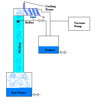

  Here's a pretty simple drawing of a setup that you can build. Add heat under the boiler and bring it up to the temp for the pressure you are running the still at. Batch running would be easiest. Run the still until the product tank is full shut down and drain the fresh water out, refill boiler, repeat as necessary. Look up reflux distillation on the net. They mostly talk about fragrance oils or alcohol but construction and operation principals are the same. The vacuum pump just lets you run at a lower temp. The vacuum pump only needs to remove the non condensables as the collapsing steam in the condenser maintains the vacuum. The packing in the tower is broken glass or copper wool. The rest of the tower is made up of plumbing parts. Could be a fun project something I want to get to sometime "So many projects so little life"

Reflux distillation doesn't apply here ... well, unless willib is also trying to distill out the flouride/chlorine in the water, but I believe he's mainly trying to remove the minerals. I'd imagine that attempting to remove the flouride or chlorine would be insanely difficult.
Anyway, the purpose of reflux distillation is to seperate liquids with vaguely similar evaporation points (like alcohol and water). As we all know, you could simply attempt to boil an alcohol/water mixture at the alcohol's lower boiling point but of course a lot of the water will still boil as well and your alcohol purity will be terrible. The reflux column's purpose is to attempt to recondense all of the water vapor mixed with the alcohol vapor before it makes it to the condensation stage of the column.

Probably true. You could just run with the reflux closed or not put it in. Would make it more efficient. Mostly I was trying to describe a way of using solar to heat water to something less than 212f and be able to distill it to remove the salt and not have to depend on evaporation.

You are mostlycorrect, I have my distiller est at 48C which is where I have found that I can get the highest amount of concentration of Alky on the first run, above that and the water starts to get hot enough to become vapor and rides up along with the Alky vapors.
Take a look over and some of the pics I've put up concerning my plastic still and you can get a good iade of out to do this. BUT with two fish tanks you can do something very similar.
I don't drink this stuff so I don't worry about purity. To get more water vapor you would need to be up around the 90C mark, but even before that you'll get water vapor coming out of a tube.
The one thing you'll need to do. Make the one that you're going to use to distill very closed off from the outside world so to speak, get a lid and make sure it fits tightly. With this there's less heat loss.

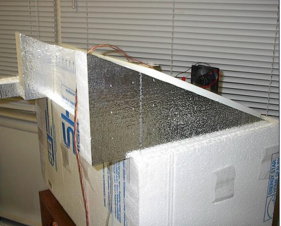

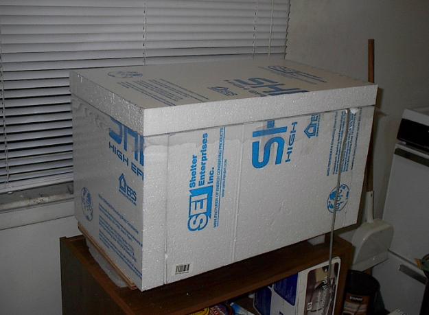

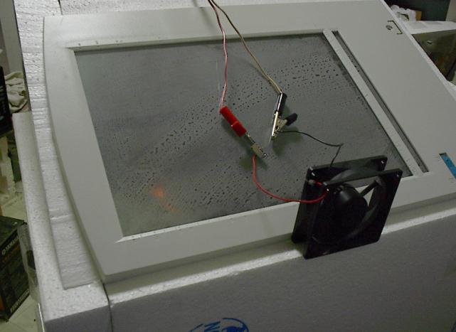

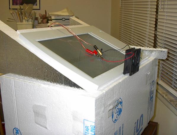

 To be honset, I tried building a soler still too. BUT here in St. Louis, we don't have to solar HOT days like you probably have.
I do however use solar PV to charge my NiCd battery banks, that runs the inverter that heats the mash. Does this count?
I do have a few pictures that I've up loaded if you'd like to give it a try.
My current way of keeping the unwanted water vapor is to put a weighted bowl in the middle of the plastic lid to cause a dimple in the middle of the lid, this allows the vapors to condense to the middle and drip back, only the most outside and higher true Alky vapors make it to the outside.

ok i'm hot wireing a foam shrowd to go round the water i had on the sill since about five thirty.
i started with warm water ,so its impossible to tell how much it warmed up , but i can say for sure that the vapor is thick in there , just waiting to be extracted.
i think that i'll make a foam top too, with holes cut at both ends of the 10 gal fish tank . there is only about 2 to 3 inches of water in the tank.
but there is no rush really as i can heat it up with the immersion heater or some NiChrome wire  that i have..
the holes at either end , in the foam top will pull moisture from the tank with a 12 v fan , and pass it by an tilted condenser , which may be just a piece of flat glass , havnt decided yet

i'm gonna have to redo the condenser a bit
just thought i would try something i had seen years ago in a boy scout handbook
it was basically a plastic tarp with a stone in the middle and a bowl to collect the water, it does not work very well.
Now before i put the insulation around the tank , the vapor was condensing on the glass very well :)
thats a 10 gal. fish tank in there
this is it with the top on it
so i'm gonna use piece of glass from a scanner , tomorrow , and try again.
also maybe the vertical collector will work, if i can collect the condensed vapor off the sides , maybe make a channel out of silicone (RTV)
its been fun anyway

this is a pretest of the initial  test
here i still have to trim the ends off
here ya can see the little glow of the imersion heater in the lower left portion of the glass
