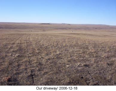

how many acres come with that driveway :)
welcome to the board

The driveway ends at 161acres. It is in the middle of tens of thousands of acres of pasture. Our nearest neighbor is a few hundred head of cattle and a few thousand sheep. Nearest human is 8mi. Still, a great place to be and we love the people (when we see them :-)
Thanks for the welcome,
Deron
