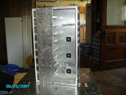

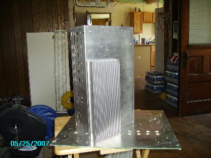

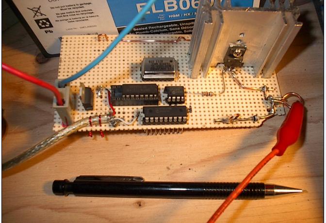

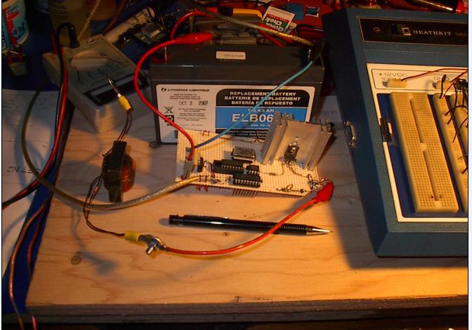

I moved my boost circuit off the breadboard and made it portable
It runs on 6V or 12V
the battery powers a 7805 for the PIC16F88 The clock and a 74LS161
the FET driver is powered directly by the battery , and feeds the FET with the PWM from the PIC.
not shown are the 2 one farad caps in parallel that i use between the alt and the converter also not shown is the pot on the other end of that recycled USB cable , that i use to vary the pwm
the caps serve to sort of buffer the alt from the pwm , and this way the alt can get ahead of the pwm if the wind allows it to
during testing the boost doesnt mind at all if the alt and cap voltage is greater than the load battery voltage
The boost converter can still double as a step down dc to dc converter or a hot wire foam cutter, just by bypassing the diode and the inductor
i used wire wrap sockets , but ended up soldering them anyway
i also put a 10 Ohm resistor between the fet driver and the gate because i thought it may protect the gate a little better than without it
as you can see i now have some more room on the breadboard
the goal of all this is to get some more power from the minigen II during low wind days , the other day when i took it out for a spin , it never stopped turning ,but it would only charge a 12V battery at or over 220 RPM

Looks good willib! Do you have any plans on how you will regulate the pwm to achieve charging in low winds? Keep us posted with your results.

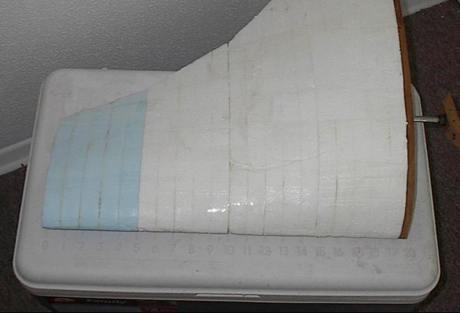

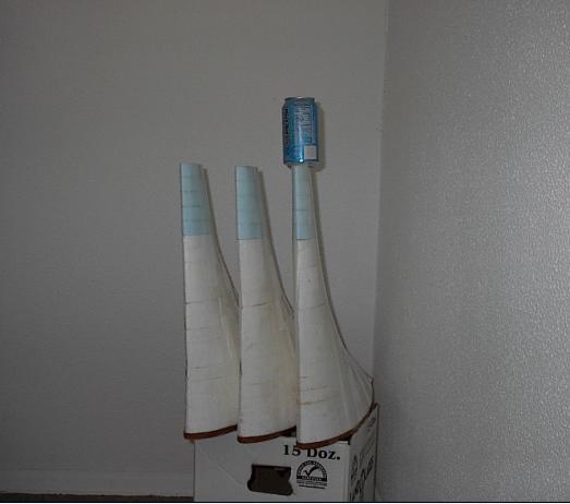

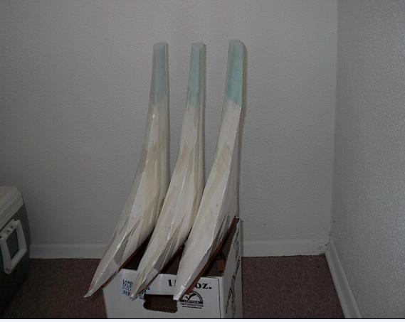

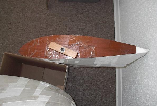

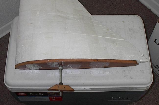

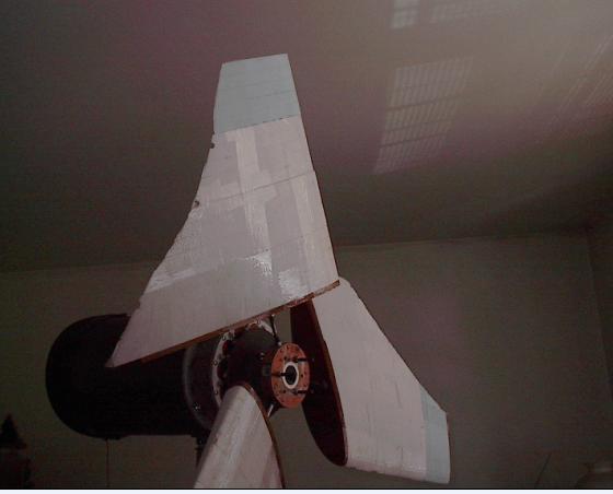

« Reply #10 on: June 07, 2007, 12:48:05 PM »
The blades themselves are 19.5" tall
but the distance from the center to tip is 24 7/8"
The changes i've made are , i ommitted the 21" taperless root section and i added some solid mahogany to the base
they are about exactly half their final size
Due to their construction ,they dont flex that much at all ,and i have extra tape on the leading side , where all the force is pushing them
I'm not shure how the tape will hold up if i added the rest of the sections , probably not too well , but for now it works great
a shot of the airfoil shape
The trailing edge got a little banged up in the trunk , but they are hanging in there
« Last Edit: June 07, 2007, 12:48:05 PM by willib »

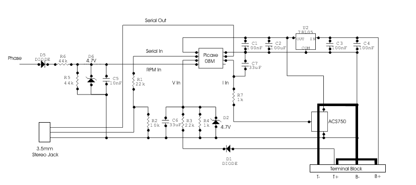

Glad to see you've gotten back to the PIC and this project.  I see you've changed to the PIC16F88, weren't you using a PIC12F683?  External oscillator too I see.
I finally got around to putting my programmer together this past weekend and it works.  I've been able to load the firmware with MPLAB, do the self-tests, and also played around a bit from the Unix side with Piklab which also sees and tests it OK.  My connectors took until earlier this week to show up so I've been reading the PIC12F683 datasheet and other stuff.
These may border on excessive inputs, but I was wondering about taking one of your fan/anemometers and sticking it on the back of a windmill, and feeding that into the PIC.  It would have a much faster response time than the RPMs detected from the alternator, so it could give advance warning of when the wind was slowing down or speeding up, which might be more helpful than trying to adjust the pulse duration after the change has had an effect on the blade and alternator.  I'm still trying to decide on the best way to get RPM data into the PIC, it seems like an F/V converter like the LM2917 fed into the analog inputs is more practical than trying to bother the PWM generation capabilties of the PIC by having it try to capture some cycles of alternator output directly.  I suppose a pair of FETs could be used to multiplex the 2 RPM signals through the same F/V and A/D channels.
Another input I've been thinking about is output voltage.  The approaches I've seen so far like jimovonz's algorithm at http://www.fieldlines.com/comments/2006/11/26/22831/362/11#11 are only aimed at getting the maximum current output, they don't deal with when the battery's charged.  Maybe it's best to cross that bridge when we come to it, but it seems like a good idea to plan ahead.  I see one of your drawings at http://www.otherpower.com/images/scimages/2965/new_boost_4.JPG has essentially boost, buck and dump load, but I'm not sure how you're planning to detect when to use which.
It seems strange to be using a PIC which thinks in microseconds to deal with a windmill that has a response time of 1/2 second or more at best.  What to do with all the extra cycles?  Do more A/D conversions and average them?  Look at first derivatives?  Probably can't do SETI in 256 bytes of ram.

Alan, I successfully measure RPM by converting the AC voltage on one phase to a 5V square wave then measureing the time between the rising edges on a single digital input pin (with a simple RC filter). This can be seen in this schematic: http://www.otherpower.com/images/scimages/2210/TurbMon.gif
Regulating the charge into the battery is relatively straight forward. I typically use N FETs to switch a dump load across the battery from the low side using pwm. There are a number of ways you could implement this on the pic with multi stage charging not much more difficult than your simple 'bang bang' single set voltage type. Having an initial set point somewhere around 14.4V will achieve a bulk and absorption phase and then dropping down to around 13.8V after a set time for your float. I check the voltage once every loop cycle and alter the pwm duty either up or down depending on the measured voltage relative to the target voltage. In the absorption phase I count cycles to determine when to initialte the float phase. Depending on what else your pic is doing this may give you a less than accurate absorption period. If this is a concern you could always look at using a RTC. I let the voltage go anywhere in the 13.8-14.4V range during this phase but restart the count if the voltage drops below 13.8V for more than a few minutes. I've tried pwm frequencies from 1kHz up to 100kHz (with suitable FET gate drive), all with success. I generally keep the frequency low to try and minimise the load on the FETs.

willib, you mention using a '74LS161'. I presumed that this was the driver IC you refered to but a search on this number only turns up a 4 bit binary counter.
« Last Edit: June 09, 2007, 12:58:20 AM by jimovonz »
Re: Boost converter
« Reply #16 on: June 09, 2007, 02:56:25 AM »
Yes , it divides the crystal modules 19Mhz signal , the output from the LS161 goes to the clock input on the pic
with the 74LS161 i can instantly change the clock input to the pic and hence the pwm frequency , by a factor of 2 , 4 , 8 or 16 , just by selecting one of the four counter output stages
i think i've found the best frequency for the inductor i'm using , but i may still tweak it some more
The driver IC is a TC4428A from microchip
« Last Edit: June 09, 2007, 02:56:25 AM by willib »

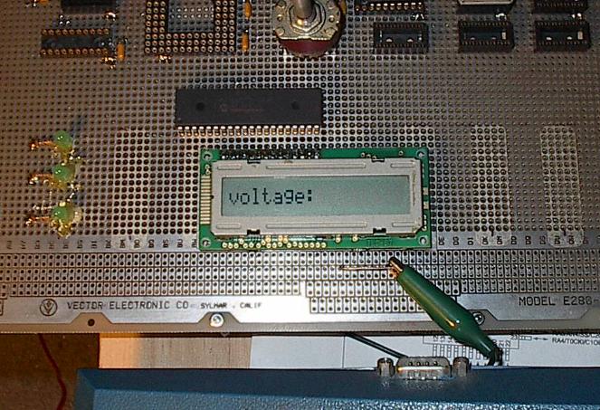

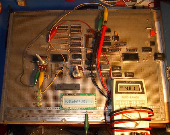

been working on trying to get a LCD display to cooperate with a PIC , not feeling very wizard like , at the moment
i've eliminated all possible wireing falts ,i think  so it must be the program
the only thing it does is change the contrast , no digits , nothing ...
a large chunk of the weekend down the crapper oh well..

its alive!
« Reply #26 on: June 11, 2007, 08:24:21 PM »
well its a start !!
I put the 877A on a vector wirewrap board , reloaded an earlier program , and this is what i got so far
« Last Edit: June 11, 2007, 08:24:21 PM by willib »

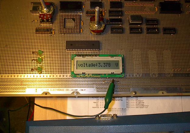

at last !! the LCD works
« Reply #27 on: June 11, 2007, 11:45:03 PM »
the pot at the top left of the photo is hooked to the PIC channel 2 analog input
as you can see it reads 3.378 volts
this is the first time ,ever , that i was able to get a display of what the PIC was reading
i realize that this isnt really related to the boost circuit , but what the hey.
its all part of the same outcome
and this is a massive step forward for me

jimovonz
  • Posts: 339
Re: at last !! the LCD works
« Reply #28 on: June 12, 2007, 12:22:51 AM »
That looks great willib! I have an 18 pin pic all setup to drive an lcd via a simple single pin serial interface. I simply program one up and add it to the project - it makes things very simple. A 16x2 line LCD + pic cost around $US25. I have also used cheap RF transmitter/recievers to transmit back to a PC for display. I am considering integrating these into the controller I'm developing.
« Last Edit: June 12, 2007, 12:22:51 AM by jimovonz »
« Reply #29 on: June 12, 2007, 10:55:10 AM »
it was easy to calibrate
just by altering the program
« Last Edit: June 12, 2007, 10:55:10 AM by willib »
