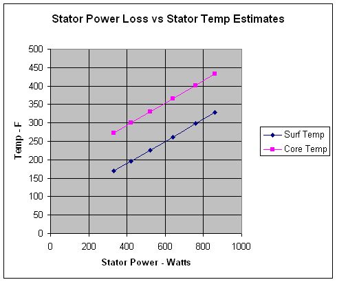

Thanks to the excellent work by Boondocker, we now have some better test data to work with to try and analyze the effects of casting the stator coils of an axial flux alternator in resin. This popular technique developed and promoted by Hugh Piggott and DanB is probably the most copied approach to making a stator assembly as judged by posts on this board.
Also appearing on this board is an increasing number of reports of failed cast stators on machines of 10' diameter and up. The current poll on the question of "Have you built a wind generator?"  reveals that of the current 2441 responders, 332 have/had a flying machine and of those, about 33% (109) have failed for one reason or another. We can only wonder how many of those were due to stator failure.
Intuitively, to my way of thinking, surrounding a heat-producing element (coil) with a thermal insulator is contra-indicated when substantial power is being dissipated. The element temperature will increase considerably compared to one with little or no thermal insulation.
Two limitations to coil temperature present themselves when looking at the problem. The first is the temperature rating of the magnet wire insulating varnish. This can be from 100C to about 220C so it pays to know before you buy. The second is the effect of higher temperatures on the structural integrity of the casting resin since the resin is what holds things together mechanically. Most resins are known to soften at higher temperature and at some point will deform with stress. Since the stator is quite close (0.125" or less typically) to the magnet rotors, any physical contact would be of concern and usually cause for destruction. Unfortunately, this issue is difficult to quantify for the various resins and additives used but has been mentioned in numerous failure reports.
It would be useful to derive an estimate of the increase in coil temperature due to casting. Let's take a coil of 30 in^2 total copper surface area with that area equally divided between the front face, rear face and the remaining sides (inside and outside). Now we cast this coil in polyester resin with 0.063" of resin over the front and rear faces. Obviously, the thermal path for the sides is longer, from 1 to 4 times as long for 0.5" thick coils.
Assume that 90 watts is being dissipated in the coil resulting in near equal surface temperatures over the surface in free air. There will be a temperature gradient from the center of a coil leg to the surface due to its own thermal resistance.
We now need to calculate the thermal resistance of the resin which is given by
R = t/kA where:
R = thermal resistance ^C/W
t = material thickness = 0.063"
k = thermal conductivity for polyester resin = .0063 W/inch-^C
A = area of thermal path = 10 in^2 (one face)
This results in 1.0 ^C/W. Assuming even thermal power distribution over the coil surface results in 30 watts for either face. This is a temperature gradient of 30^C for the thin resin or saying it another way, we've increased the coil temperature by 30^C by casting it. It's actually worse than this because the sides, which represent 1/3 of the area, have a much longer thermal path length through the resin. The temperature rise with casting is probably closer to 40^C.
I've assumed a rectangular coil leg cross section. I've seen pictures posted here that indicate a more oval cross section for some. This will also increase the temperature rise.
In http://www.fieldlines.com/story/2007/6/25/12033/9605 Boondocker presented test data for his alternator, which uses a stator cast with vinyl ester resin with ATH as an additive and is considered by some to be the best current approach. He showed stator surface (opposite a coil) temperature vs. time for three different output power levels. Among other things, his charts show that it does take sustained power for some time (20-30 minutes) for the temperature to stabilize at maximum.
Using his temperature data along with his efficiency data, the following chart, relating stator surface temperature and estimated coil core temperature to stator power dissipation, was derived. An ambient temperature of 70F, a slope of 0.3F/Watt and a resin thermal gradient of 104F (40C) were assumed.
If we select 300F (149C) core temperature as a reasonable safe limit for 200C (392F) wire to allow for higher ambient temperatures and a safety factor, stator dissipation should be limited to about 420W total. Of course, this says nothing about what effect 300F would have on the resin structural integrity.
 Since Boondocker used a nine-coil stator, this works out to about 47W per coil of sustained power. For the same limit, a non-cast stator would be about 84W/coil, an improvement of about 79%.
I shudder when I read of those machines putting out 2-4kW at only 50% efficiency using cast stators. Probably, the main reason we don't hear of even more failures is due to the vagaries of the wind, which doesn't sustain the power for long periods. But, are you willing to bet a stator replacement on this?
I think the lesson is clear. We need to strive to produce more efficient alternators and not to stress components where it isn't necessary. Stator casting is not necessary, it's only one way to skin the cat. Also, limiting power output by various means to a reasonable number is better than the "all I can get" approach and will enhance reliability.
Even considering the assumptions, estimates and data roughness, I sincerely believe that casting a stator in resin is the wrong thing to do for larger machines (=> 10').

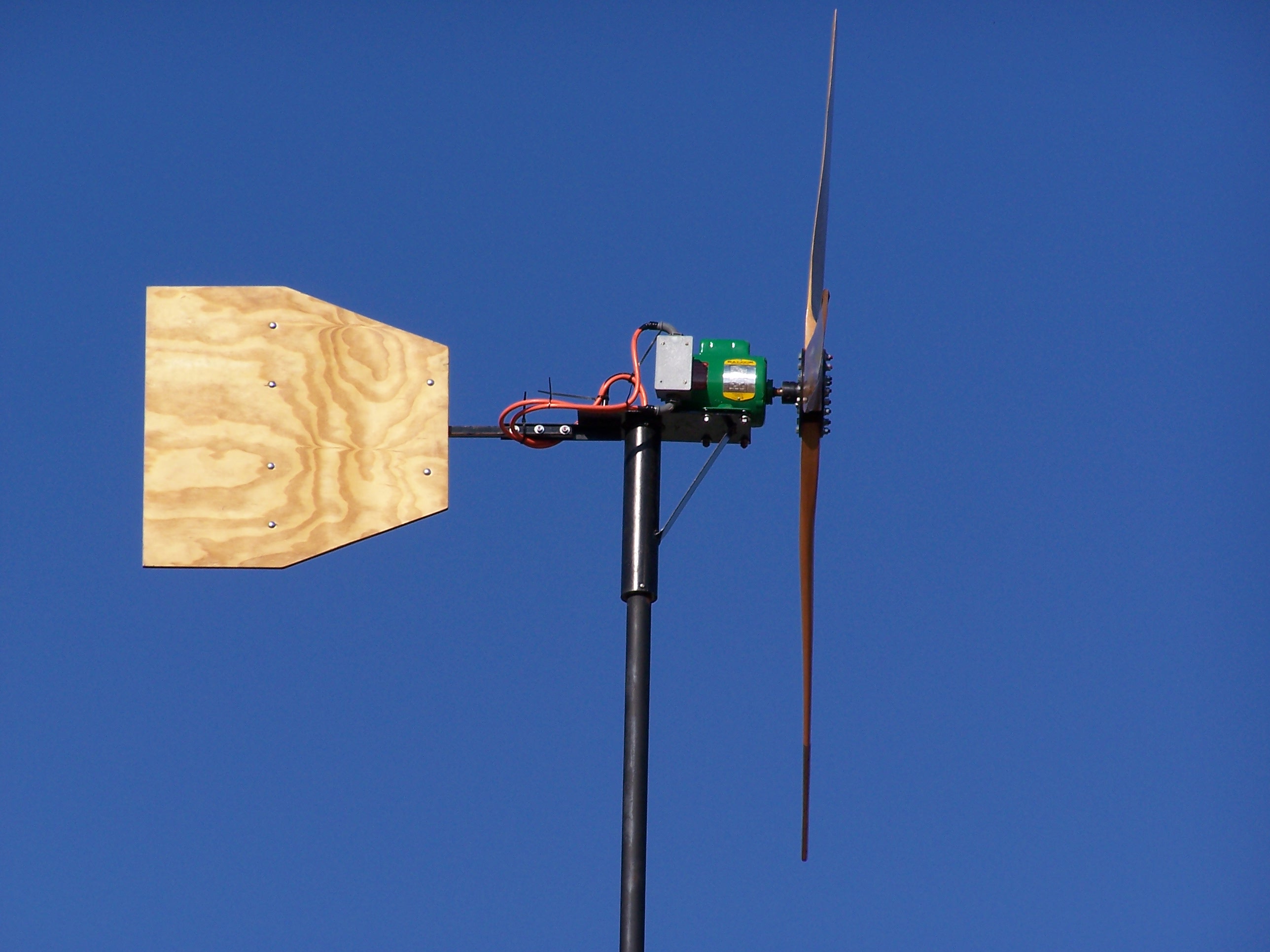

« Reply #14 on: June 28, 2007, 06:31:10 AM »
Peter;
Not sure about a writeup but you are correct the conversion is a 2 meter [~6.5 foot] conversion and it flies with no furling. It has seen sustained 40 mph winds for most of one day. I have seen multiple instances of 40+ amps into a battery bank hovering around 26 volts. That is getting over 1 KW.
It has flown in winds that were downright scary on the ground and it is at 60 feet.
Damned tough unit. It is a  1 HP motor originally.
The copper buried in the iron core has a lot of cooling effect.

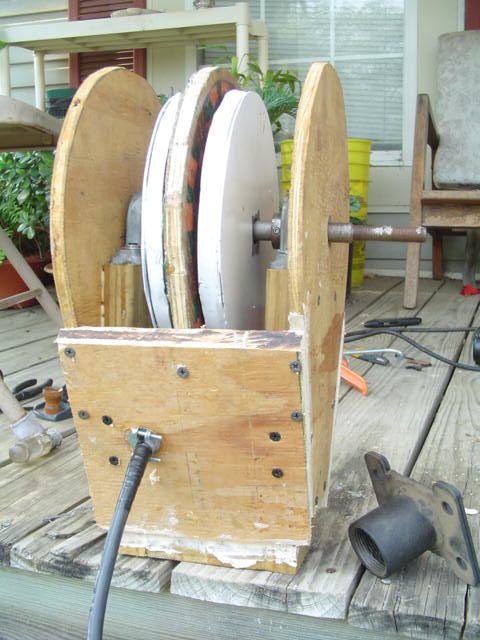

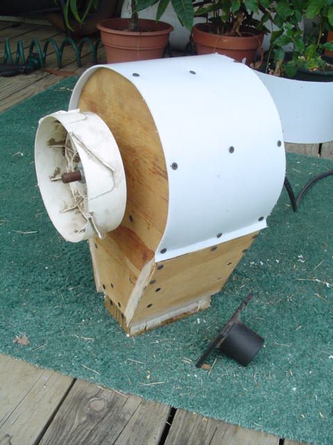

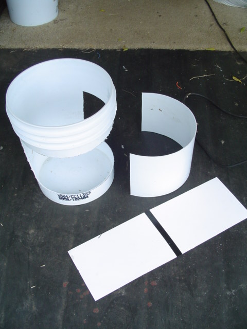

« Reply #24 on: June 28, 2007, 03:04:20 PM »
Here is how I sealed up my machine . . .
« Last Edit: June 28, 2007, 03:04:20 PM by wooferhound »
