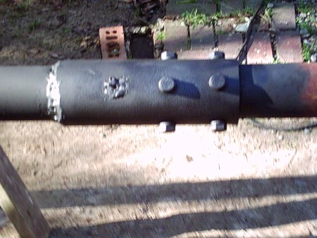

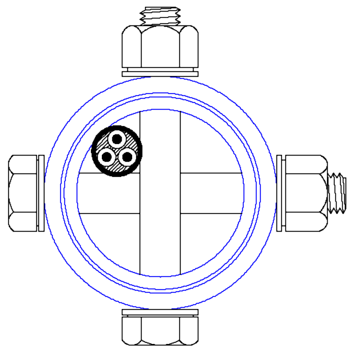

I discovered this weekend that cable doesn't fit!
Here's the diagram that I SHOULD HAVE drawn BEFORE going with this plan:
As you can see, the cable won't slide between the criss-crossing bolts.  The biggest cable that will go is a #10 gauge, 3-conductor cable.  And that's only when I split off the outer jacket, and fed the three wires through.  They just barely fit.  I doubt #8 wires would have passed through.
I originally wanted to avoid welding structural joints as much as possible - my welding sucks.  Since I have a drill press, I was able to drill the holes in the pipe to bolt them together, so it seemed like the simplest way.  Right.  Now where's the space for the power cable?
I used a stiff "fish-wire" to catch the conductors at the other end and pull them through, just like eletricians do to put wires into existing walls or conduits.  But this technique has its limitations, too, and you can't really control where the fish-wire goes as you push it up a blind tube 40 feet long.  If absolutely necessary, individual conductors up to #2 Gauge could be fed down, each in its own corner.  Pushing the fish-wire down the tube three times and not getting it jammed is pretty unlikely, so that approach is probably fraught with trouble, too.
Well, the wire is in, such as it is.  It's going to be very windy for the next couple of days (according to the weather report), so all I can do is wait.  I may not be able to raise this thing until next weekend.  The prop is assembled in the garage, just kinda hanging from the ceiling, and the generator is sitting on the top of the tower, just kinda waiting idly.
My face is turning blue....

Would it be possible to separate the bolts (vertically) by 4 or 5 cable diameters?  If so then the cable should be able to snake its way through.
Just a thought...

Hmmm do we have a cunning plan to untwist the cable at a later date.... or do you have sliprings.....
just a thought while it is still on the ground.

I would offset the bolts to dodge that problem of the restriction. But, I am not a metal working type. I have used this shop vac trick to good advantage many times, yesterday I did it 2X.

hi SparWeb, i had a similar problem and simply removed one bolt, installed the wire and replaced the bolt. the same thing when taking any twist out of the wire. pepa

If your drawing is accurate... remove bolt,feed wire, reinstall bolt. The wire will reshape itself to fit into the space to a small degree. Also since the bolts are offset to each other the wire only has to pass one bolt at a time. If the offset between the bots is more then an inch or so ,you should not even notice it.

Great suggestions from many of my favourite contributors.  I'll try to respond to the many comments in one reply here, instead of one at a time.  It's nice to see so many who are willing to help.
Twisting cable, as the mill yaws about, didn't occur to me, until you mentioned it.  Yet another bother that will get on my nerves.  I will have to lower the tower (easy enough) and turn the mill around as necessary.  At least the top of my genny mount can be disassembled - that shouldn't be too bad.  Only the top 6 feet will get twisted, because the strands are jammed into the corner at the uppermost bolts, so all the twist will occur in the top 6 feet of stub.
I certainly did not plan on putting slip-rings on this tower.  I may be stuck doing so if the site turns out to be windy.  That complication may be enough to convince me to make the typical "clam-shells" that I was supposed to in the first place!
The vacuum cleaner trick sounds like a great alternative when the "fish-wire" doesn't work.  Filed away in my "mental toolbox".
Removing one bolt is definitely a way to get a slightly bigger wire down there, but it will buy me only a few wire gauges and still not afford any free twisting/untwisting.  I was considering that before, but it's very time-consuming to completely remove the yaw head, lower the tower the rest of the way off the saw horse, pull out the bolt, pull thru the cable, replace the bolt, and then start assembling all over again.
Lastly, I use CAD software to draw everything I make.  Almost everything.  Not enough assembly drawings, it seems.  That graphic was produced in AutoCAD (I use the old ACAD R14, because subsequent versions provide no advantage that is not surpassed by true 3D CAD software).  That drawing was then exported (via screen shot) to Photoshop for a bit of extra contrast before being saved as a GIF.  I work with drawings and graphics extensively at work so I am much better equipped than the average Joe for drawing stuff.  BTW, the standard hardware items are blocks that were drawn from scratch - by me!
Well, I'm still grouchy about this, but thanks again for the consolation, guys - I'm not so disappointed any more - there IS an answer!

Those bolts are loaded in shear where they penetrate the walls.  They have to be thick there, to spread the force and provide a large area that must be cut by the pipe's motion for the bolt to fail.  But the middle is just holding the rest of the bolt in place.  The bolt is only tightened enough to keep it positioned, not to provide compression.  So it doesn't have to be very thick at all.
In principle you could turn down the middle of the bolts to make more clearance for your wiring.  In practice this might lead to failure from crack spreading or accidental overtightening.
An alternative is to use thick inserts at the holes (what are those called?) with a thin retention bolt through the middle.  (Imagine a cylinder of metal with a hole through it and a washer welded to the top - but made out of a single piece of metal rather than welded together.)
You'd want to round off and polish the inner end so it didn't cut into the cable jacket.
I can think of several variants that would leave the quadrants nearly clear.
Another possibility is to tap the holes in the inner pipe and make the outer pipe's holes just clearance for the threads of four short bolts.  That would free nearly all the inner space, at the cost of weakening the bolted joint.  Fortunately if the inner and outer pipes are a good fit there isn't all that much load on the bolts.  But be sure to use good lockwashers!  Tighten with a torque wrench to insure a good setting without stripping.  And you might want to go to four bolts on each side of the joint.
Better would be to put bolts INSIDE the mast pointing out and crank nylock nuts onto them from the outside.  But that's a horrendous assembly problem.  (I'd try gluing a string to the end of the bolts and pulling them through the holes from the outside.  Then shoving a pipe up the inside to keep them from wandering back out of the holes while they're being tightened.  But that's a massive pain.  And replacement of a loosened bolt would be a bitch.)

The only problem you have is in the drawing.  It is 2D, and fails to show the 3rd dimension present in the tower pipe.
Unless your bolts run through each other, you have plenty of room.  Wire is flexible, and will bend.
Try looking at the picture with only one bolt present.  You have plenty of room beside the bolt.  Then, look at the picture of the other bolt.  Again, plenty of room.
It only appears to be an interference fit when you look at both bolts in the same plane.  Yes, the wire will do a little zigzag going through the bolt area, but it will fit just fine.

You could drive up here and pull on the fish-wire yourself, if you want....  Got a cold beer in the fridge for you if you can get it throu where I failed.  I ripped the wire off the cable a few times myself before giving up.
There's hardly an inch between the upper and lower of the two bolts.  Yes, it looks like it can get by when you consider that, but in practice, it doesn't want to make the corner.  Inside of the pipe is rough, cable and fish-wire have to be joined somehow, murphy's law involved somehow, too, I'm sure...

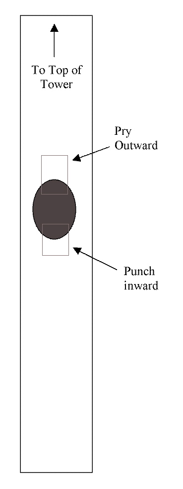

Remove the bolts.  Run the wire through the tower.  Then use a punch to align the bolt holes.  The punch (or big screwdriver) will bend the wire out of the way.  Then put the bolts back in place.
That will be a lot easier than trying to pull the wire through the zigzag.  You may be able to get away with just removing one blot, and leaving the other bolt in place when you run the wire to keep the holes aligned.  Then use the screwdriver to bend the wire out of the way so you can put the other bolt back in.
The bad thing about having the zigzag in the wire is that it will not untwist easily.  You will need to lower the tower to untwist the wire occasionally.  I would recommend putting some kind of quick connect plug at the top of the tower, so you can lower the tower, unplug the wire from the alt, and untwist the cord.
Another solution you could do - cut slots a couple inches up the side of the outer pipe (where they join).  Then use a few exhaust pipe clamps to join the pipes.  The slots cut in the end of the outer pipe will allow it to crimp onto the other pipe. You can always get an exhaust manifold flange to slide over the pipe before you clamp it.  The flange can be held in location with exhaust clamps at the joint, and the flange will give you easy guy wire attachment points.

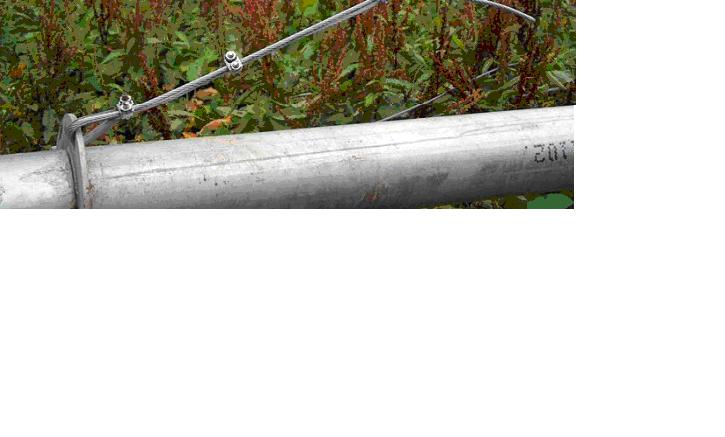

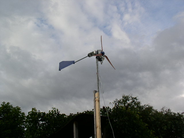

« Reply #24 on: July 19, 2007, 05:49:58 PM »

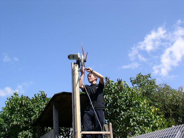

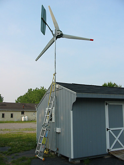

 I did mine without any bolts. Once you slide the top section in the guy wires to the gin pole will hold the tower together. The tower will flex from the weight of the turbine and a small spread will occur, but as long as the sleeve is in six inches or so you should be fine. Mine might spread 1/2". I drilled, taped, and bolt the top section and used four bolts. The threads got messed up from the tower flexing at the top, so I like the way I did it in the middle much better
« Last Edit: July 19, 2007, 05:49:58 PM by jmk »
jmk
  • Posts: 603
Re: What Not To Do
« Reply #25 on: July 19, 2007, 05:54:35 PM »
 Should read I did my middle sction without bolts. The picture is the top section. I don't have a picture of the middle.
« Last Edit: July 19, 2007, 05:54:35 PM by jmk »
