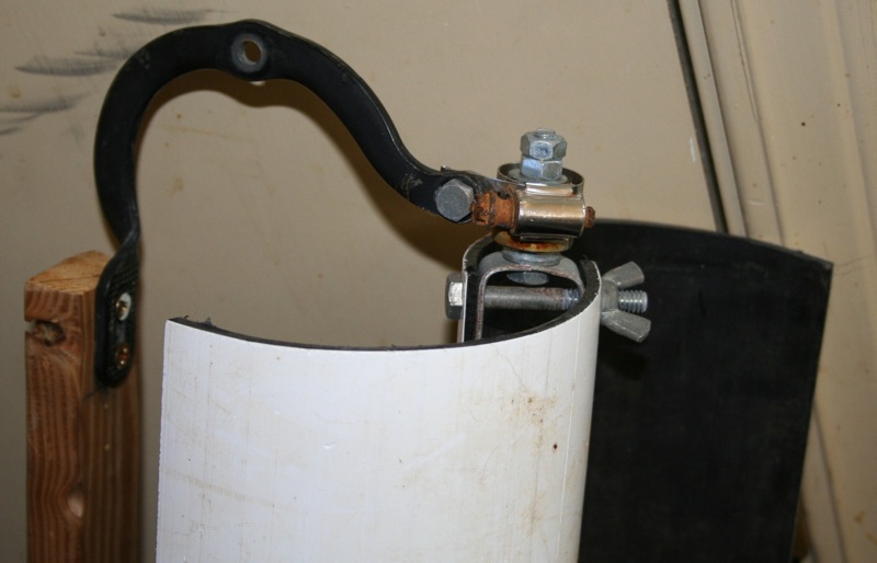

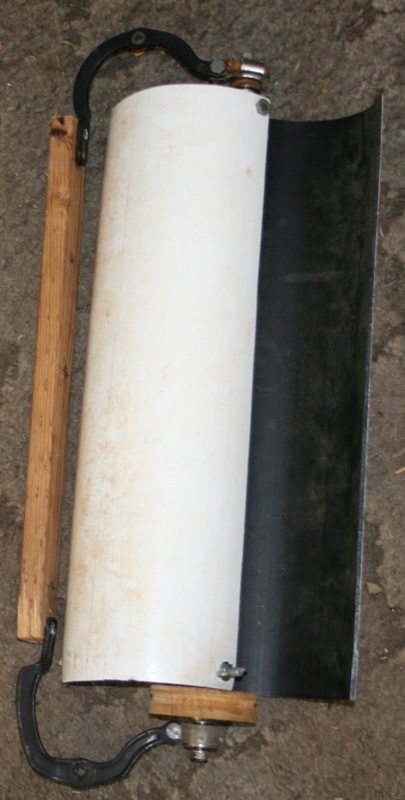

Here's a couple snapshots of a small vawt I made a few weeks ago. Total build time was less than an hour and it consists entirely of scavanged/on-hand materials. You could probably build a dozen of these for around $50 if you bought the parts retail, assuming some part-substitutions.
I had intended to hook a small dc motor to it but got distracted and abandoned the idea - it's fine as an ornamental. It could use a roof piece though so that the bearings don't rust more than they have already.
The vanes are made from 6" PVC pipe, and are about 18inches long. Someone had drilled holes down the length (homemade perf-pipe? I dunno) of the pipe so the vanes aren't exactly semicirclular. The bearings are from an old pair of inline skates. A couple hose clamps, some old cantilever breaks for the support arms...yada, yada..
Pretty rough but it spins like crazy...

I put it back up on the fence post last night and got treated to a blur (which isn't unusual, really). It was spinning so fast I couldn't count out the rpm with any kind of accuracy but it was easily more than 300, though probably closer to 400.
Since the vanes aren't half circles I wonder if that's making a difference. I also wonder if how they're mounted is better or worse...look carefully at the vanes where they attach to the "U" bracket in the first pic...
Most s-vawts I've seen don't overlap quite like that. If you pulled a string through a typical (cylinder-based) s-vawt the string wouldn't have to bend much, it'd basically be a straight line. If I pulled a string through mine the string would bend a lot more noticeably, both in the center and at the outer edges.
It rained last night and is misting this morning. As soon as it clears up I'm gonna see if I can't get a video of it running. I don't have an anemometer but I've got a piece of ribbon that's "calibrated" to show when the wind hits 8mph...I'll see if I can get that in the vid too.
