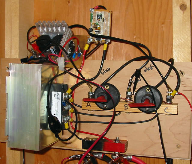

I haven't written about my first MPPT power booster for some time.
(http://www.fieldlines.com/story/2006/10/16/16467/958)
It worked fine but along the way I decided to increase the air gap and cut-in speed on my alternator and the first booster circuit I built wouldn't handle the current at the new and higher cut-in speed. (But it works fine boosting my meager 12v solar panels up to 24 volts so it's not wasted!)
Recap: I built my 24v mill to have a high cut-in (about 13MPH) so that it would be more efficient and a better power match in high winds. The plan is to use an MPPT power booster at lower voltages to recover the power on the low end of the curve.
The new booster is basically an identical circuit to the first booster, I just built it a little differently to handle more current.
The few circuit changes: I had good luck using the battery cable as a shunt in my dump controllers so I used the same technique here. The original circuit used a hall-effect current sensor; this one simply connects each end of the battery's ground cable to an analog to digital converter and measures the voltage drop (which is proportional to the current flow.) Also, I added a button an LED to configure and test the circuit. To handle more power there's two inductors in parallel, two sided and wider copper in the high current areas and bigger heat sinks.
So far, I've only done low current testing (with the booster connected to main rectifier with alligator clips.) Here's a picture -
The booster is sitting on top of the main rectifier's heat sink; that's the digital watt meter I built to right of it.
IT WORKS!
In "manual mode" I can vary the duty cycle and watch the mill speed up and slow down... very cool.
I haven't seen cut-voltage for the mill today but in "automatic mode" the MPPT booster is still extracting power. Cut-in for the main rectifier is about 240 RPM; I've set the booster to cut in at about 60 RPM... it doesn't quite pull steady power out of 60 RPM but it gets a steady 3 or 4 watts at 70 RPM. No that's not a lot of power but it's more than enough to power my control system... I'm not really in a position to know if it's getting "maximum power" but I think it is: I can read out amps and voltage with the LED and button and they read correctly so I've no reason to think the little microprocessor can't to the math correctly...
Well, I picked today for the first tests because there's very little wind. Tomorrow forecasts more so I'll beef up the connections and I'll follow up with more results as I get them.
- Ed.

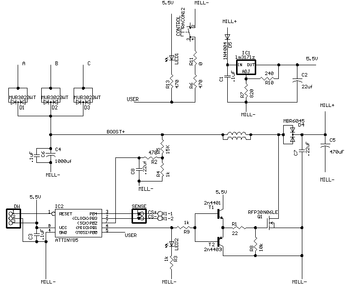

Hey Ed that thing is Fantastic, would you concider posting a schematic?

Sure...
... and here's a direct link that may be a little easier to read -
http://www.otherpower.com/images/scimages/6527/mppt_1s.gif
If you're not familiar with the tiny85, there's two things under that hood that aren't obvious: 1) Its ADC has an internal gain amplifier so I'm sensing the shunt (voltage drop on the ground cable) at 20x the voltage. 2) WTR to the button, at vcc equal 5.5 volts, logic "0" is about 2.5 volts (logic 1 is about 2.7 volts) so even with the LED pulling the input up, a button press will read as zero. (The "user" pin is normally set to be an output; I set it as an input for a microsecond or so every 10 milliseconds to check for a button press and then turn it back around to an output so the single i/o pin can be used for both LED output and button input.)
Hope that helps,
- Ed.

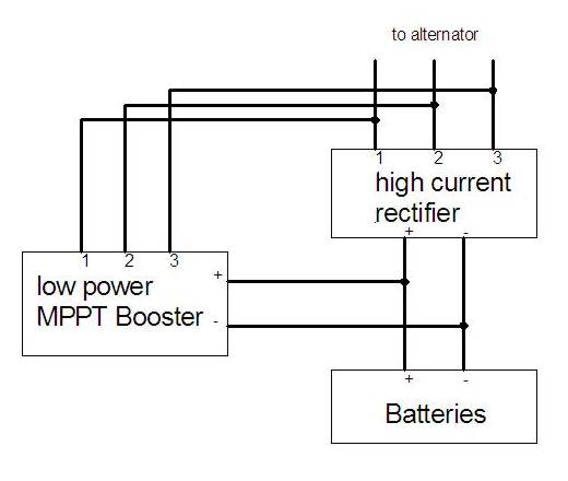

I'm slightly confused by 3-phase on the left side and mill+
on the right side of the schematic.
boB

The design follows one of Flux's ideas posted in his "matching the load" story. Here's the "big picture" -
The booster is in parallel with a high current rectifier and, in fact, uses the lower half (negative side) of the main three-phase rectifier for the return path. (The booster only duplicates the the positive side of the rectifier.) "mill+" is a left-over from when the the boost current was sensed by a hall effect current sensor. "battery+" was on the other side of the sensor so in this circuit mill+ should have been renamed battery+
Hope that makes sense,
Aha !  Yes, that's what I thought.
