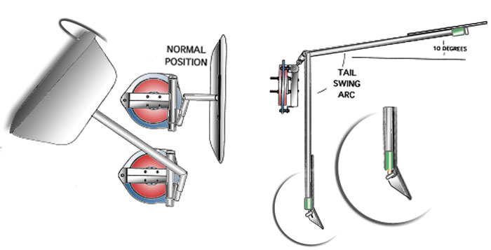

The "Furling Assist Device" just in the idea and design stage at present.
The purpose of this device is to add furling action for stator thermal protection.
The Plan is to use a sensor embedded in the stator to energize a solenoid on a tail flap to aid the furling action. I'm still at present looking at what to use as the energizing circuitry. G's little gem of a circuit may work for this application as well.
Note the tail flap is cut at a slight diagonal, with the top being bigger than the bottom, this will also aid in lighting the tail as well as aid in furling.
All comments and \ or ideas are welcome!!
Blessings, Snow Crow

I tend to agree with Dean, using a manual furling scheme. Most people seem to be inclined to avoid mechanical shut down devices at all cost.
I can't see any hope of the tail flap thing working but I don't want to pour cold water on something that has been given some thought. I have tried several things that ought to have worked and don't and I tend to spot the ones likely not to work.

« Reply #8 on: October 10, 2007, 09:48:59 AM »
Leaving a mill running alone for months is a tall order but at least you will be out of harms way if anything goes wrong.
Rather than worry about protecting from burnout I would be inclined to make sure it furls safely so that there is no danger of burn out. I don't know what you can do about about things freezing up and causing problems such as a frozen furling hinge.
Protecting against overspeed is worthwhile if you can devise something.
I don't see what the flap is going to do to help you, it's not going to significantly reduce the weight of the tail and that is the only way it could work.
I certainly wish you luck and I really can't see it doing any harm.
Nearly all complex protection devices fail and create as much of a problem as the thing they are supposed to protect and unless they are constantly tested and maintained they tend to defeat the intention.

« Reply #9 on: October 10, 2007, 04:19:12 PM »
(I don't see the post I thought I made earlier.  Now Flux has covered part of it but I'll fill in the rest.)
The flap, directing the air sideways, won't do anything to assist the furling.  It will just change the apparent direction of the wind at the tail vane, which will make the mill fly at a somewhat different angle up to essentially the same furling windspeed.  In fact it will make the mill turn the wrong way.
To assist furling the flap must direct the air DOWNward when activated.  Then it will effectively reduce the weight on the tail and cause the hinge to start folding at a lower wind speed - which is what you want.
