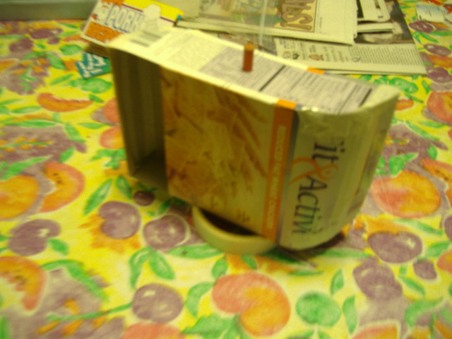

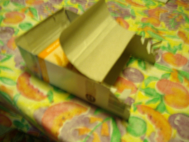

curved corners?
« Reply #13 on: October 12, 2007, 07:58:24 PM »
Here's the cerial box or rather cracker box.....
cut tabs up to the curve and bend tabs and tape
curved part on.
and you get this.
a fair weather Benish VAWT.
 It works with a fan but doesn't self start...
couldn't try it in the wind cause as usual...
No Wind.
               ( :>) Norm.
« Last Edit: October 12, 2007, 07:58:24 PM by Norm »

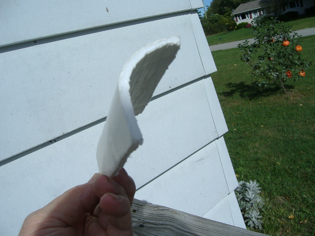

Re: foamboard
« Reply #16 on: October 13, 2007, 07:12:48 AM »
  Actually I just used a cereal box to show how
easy rounded corners on a cereal box can be ....
even easier with foamboard hotglue and ducttape.
  the cardboard on the foamboard isn't weatherproof
but some latex exterior paint will
make it so....
  Another idea I had is to make a squirrel cage
VAWT like what was recently posted...smaller
scale. Using foamboard for the top and bottom
blade supports and using plastic mini-blinds for
the blades ?
            ( :>) Norm.
« Last Edit: October 13, 2007, 07:12:48 AM by Norm »

Re: foamboard
« Reply #20 on: October 14, 2007, 06:56:05 AM »
Some signmaking companies use corrugated plastic
for their signs...
Maybe someday corrugated plastic boxes will be in plentiful supply.
....in the meantime since it isn't readily
available I've been thinking of using foamboard
the curves are a little more difficult but I'm
going to try an experiment.
I'll take a piece of foamboard that I am planning
to curve and wet it in warm water and shape it
over a round form and let dry....it should work,
even if it comes unglued, can always reglue it.
If you can find foamboard without the cardboard
covering?  They have a paint for painting plastic.
 anyhow I'll let you know the results of my
foamboard experimenting.

foamboard forming
« Reply #23 on: October 14, 2007, 07:51:09 AM »
I took a piece of foamboard 8inch x  5inch....
soaked it in hot water for a few minutes, then
wrapped around a 2inch pipe wrapped string to
hold in place and dried with a hair dryer.
A success wrinkled a little on the inside curve,
 I believe this would really work.
         ( :>) Norm.

Re: foamboard forming
« Reply #25 on: October 14, 2007, 01:10:41 PM »
sure....
I assure you it is quite rigid
I'll make a model of foamboard today....large
enough to drive the stepper motor that I mentioned awhile back.
              ( :>) Norm

OK, a little video.
It also has my plastic-bottle S-VAWT in the pic, along with a suitably decorative HAWT yard-art child's fan, which is one of the more sensitive devices that I can observe.  The box VAWT sometimes starts to turn before the 'HAWT'.
Anyway, a brief gust of wind and...
(click on the 'full' link)
http://gallery.hd.org/_c/mechanoids/_more2007/_more10/turbine-wind-tiny-VAWT-Savonius-Benesh-squared
-off-prototype-made-from-cardboard-cereal-box-and-garden-stake-and-drawing-pin-thumbtack-5-DHD.avi.h
tml
« Last Edit: October 15, 2007, 12:49:55 PM by DamonHD »
