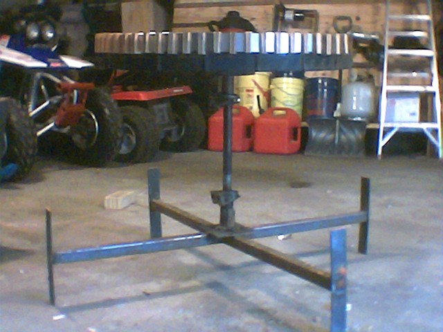

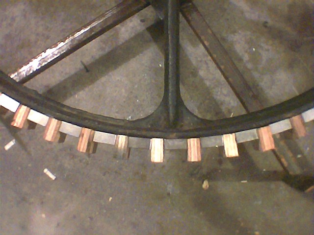

When i built the rotor for a smaller turbine i had a thought of using that to test the wheel.
 Im thinkin of welding a piece of tube steel from the bottom up to the mag section and trying coil ideas.Aircore,dustcore,steel wire backing?I dont need it to be very efficient.
 Maybe another brace up to the upper bearing.
 When spinning at ~120rpms the mags are a blur.
 Starting to look like a space probe.
 Should be fun winter project.
 Thanks for thoughts to improve my thoughts.

now your really getting somewhere vman.
what a great test bed.
have you got a way to spin this big boy at a specific rpm?(your cut in speed)

 PS. What do you do with that big shovel thing behind the space probe?

Re: Wheel Testbed
« Reply #3 on: October 14, 2007, 01:33:49 PM »
Hi Edaddy
(your cutin speed)?
 I dont have one since im not going to be using batteries.
 Im planning on driving water heating elements or possibly a gridtie type inverter.
 I just grab a spoke and spin it.Its pretty easy to get an idea of the speed.

 What else would you do with a big shovel behind a space probe other than dig it out when it gets stuck.

Re: Wheel Testbed
« Reply #14 on: October 14, 2007, 04:55:48 PM »
Hi Peter
 What im building is a highly ineffecient motor conversion.
 The 5hp i did i could spin with 2 fingers but i think powerfull neos that close to the iron easily saturate the teeth has Steven is finding.Its not a bad thing though.
 My goal is to build a vawt to satisfy Ron 2kw+
 I think and mentioned on a earliar post that they would work great for charging batteries if not beefed up so much.
 My thoughts.
« Last Edit: October 14, 2007, 04:55:48 PM by vawtman »

Re: Wheel Testbed
« Reply #18 on: October 15, 2007, 03:23:16 PM »
Edad,
 Ya it will be fun because i can tinker with different configurations.
 After i annealed the galvanized cable it turned to mush and is rusted now where the zinc was.GOOD
 The nice thing about the 4 legged probe i can build a full stator.
 I would like to get around 240v@120rpms.Not sure its feasible until i test coils.
 Not sure if you saw this 2ph idea.
« Last Edit: October 15, 2007, 03:23:16 PM by vawtman »

Re: Wheel Testbed
« Reply #20 on: October 15, 2007, 05:17:49 PM »
i think it's perfectly feasible .
it depends completely on what gauge of wire and how many turns.
 i think your selection of two phase is right on.
your pretty much building the same alt. as i need to.
please work out all the bugs  ha ha !
« Last Edit: October 15, 2007, 05:17:49 PM by electrondady1 »
