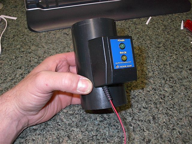

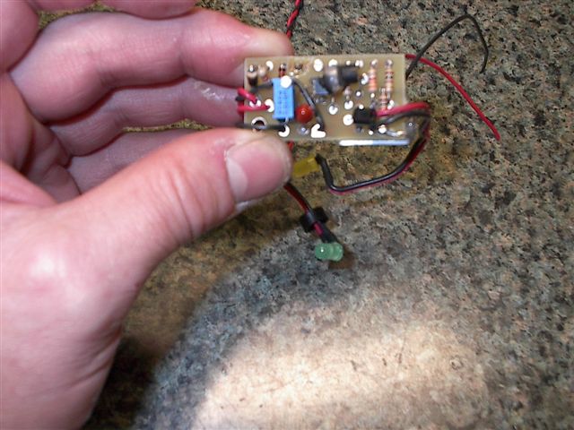

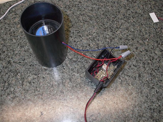

Got my LVD/Dump control kit from Glen Hurd friday. Nice looking board, lots of extra parts to modify all aspects of the kit. Assembled it in about an hour and had it running a fan an hour or so after that. Made a few adjustments of RX to get the hysteresis I was wanting and called the kit a success. Then, I took a wall adapter transformer and gutted it for the case. Sanded it to fit over the fan tube and made a custom label where the original label fit. It says: Glen Hurd's Fan Ventilation Control right under the "Fan On" LED, actual label is posted too. Had to give credit where credit's due! Using a hot glue gun glued the board into place with the voltage adjust pot lined up with a hole for adjustment later. I need to install it back on the battery now and set the kick on voltage to correspond to the battery beginning to gas. On the bench, it comes on at 13.62 volts and don't shut off until the voltage drops to around 13.22. That's giving a .4 volt hysteresis. Many thanks go to Glen for an excellent circuit, Priced too cheap in my opinion. He ought to be charging around twenty bucks for it and I would have still bought it at a price like that. I found a commercial fan control online and they wanted $77 for it without a fan. I have $12 in mine and it has a fan! It's totally self contained with a couple of wires exiting for connection to the battery. I'll add a small inline fuse for protection. With the fan running the entire assembly draws 90ma.  Here's a few pictures of the build.

Nice neat looking job there Kelly!! I like the custom made label!!
Having the circuitry mounted on the pipe, I would pot the hole were the wires come out of the pipe and use a small cylinder fuse on the supply side, just to be safe!!
